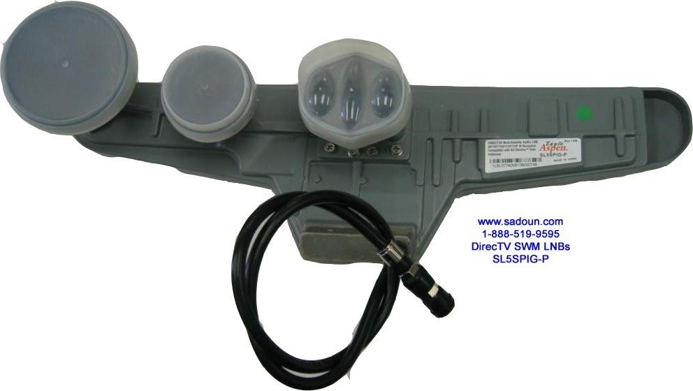

If you have the "NEW" SMW type slimline KA/KU LNBF, then you don't need to run another cable into the house. You can just us a SWM splitter and split the one coaxial cable into several receivers.
If you have the older non-SWM KA/KU LNBF, then your options are as follows:
* Use two of the other 3 outputs on the LNBF assembly to run new coaxial cables to your new DVR. or
* Change the LNBF assembly to the SWM type and use existing one cable as explained above.
The dish is the same for SWM or Non-SWM LNBFs.

about removing a slimeline dish lnb, make sure than the dish is not a SWM system. If you have a SWM system then all you have to do is add a line to the SWM system spiller. the basic spiller has four RF connectors. If you have a 5 LNB dish, you can add a new cable line to a ground block. :D

Thanks for the advice from ya'll...I'm pretty sure I don't have the aforementioned New LNBF, so I'll have to remove the head assembly. Ya know I shoulda wised up when I had the installer mount the new dish, but I was so anxious to get the HD TV, the HD rcvr working for football that I overlooked the details. This all started years ago when I couldn't get local channels on Directv or over the air, so I kept the cable system running to the back of the house to rcv those. Now the cable wants me to upgrade to the next tier to rcv "premium chnls" at (I think) exorbitant rates. So at 5 bucks for an extra rcvr I'm opting for the satellite. Shoulda, coulda,woulda.
