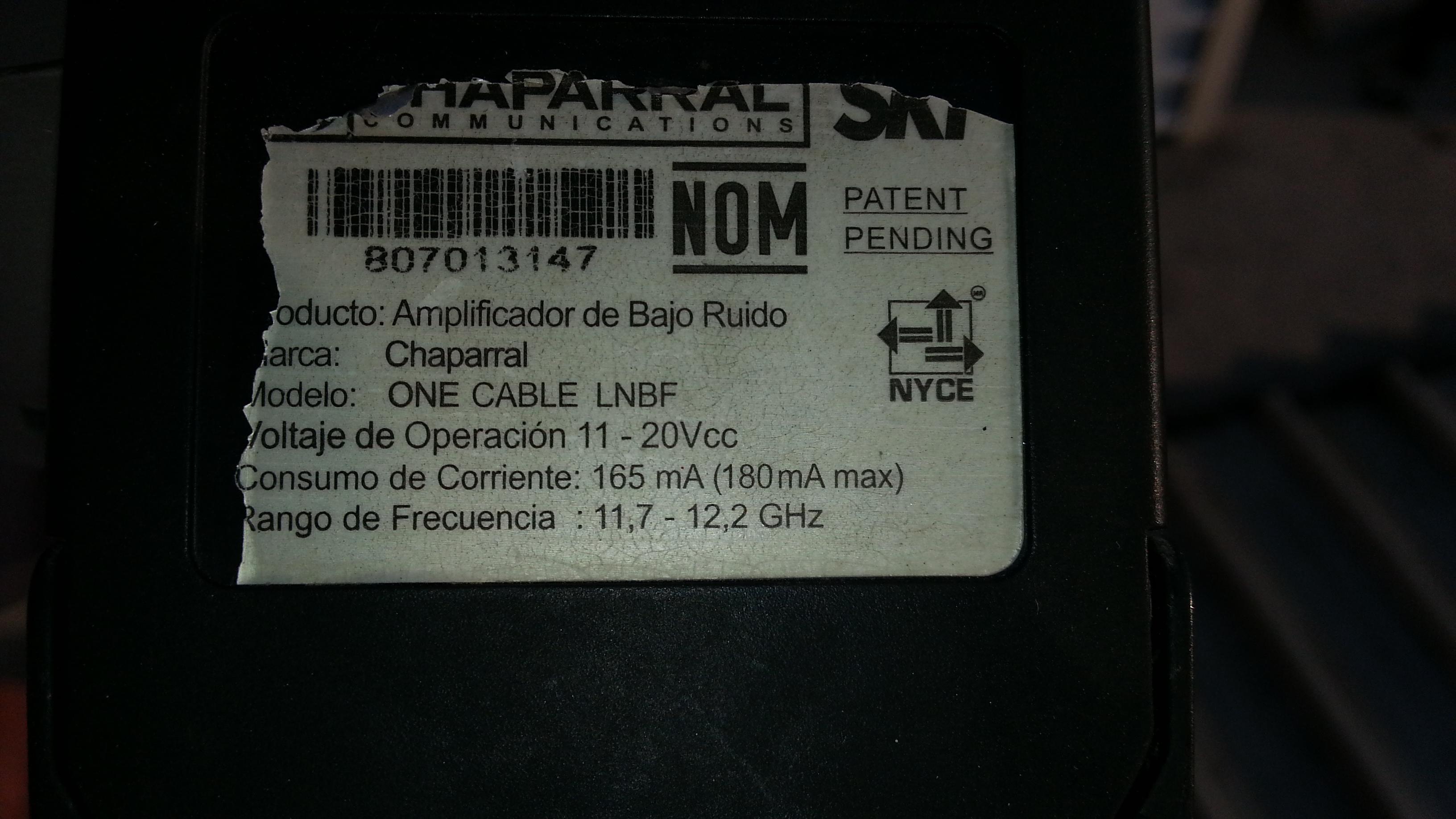

Hello, I recently subscribed to SKY +HD here in Texas and everything was great for a few months until suddenly some signals started dropping off and then all of them dropped off and all I get is a searching for satellite signal. I tried readjusting the satellite but I couldn't pick up the signal anymore. I noticed that there was a splice on the coax and that water had seeped in and corroded the center conductor. I replaced the coax and still get no signal. I don't know if the water ruined the lnb or the receiver, but the cheapest test would be to replace the lnb. Which lnb should I use? The current lnb is a one cable lnbf Chaparral brand that states the Freq is 11.7-12.2Ghz, voltage is 11 - 20Vcc, and that the current is 165ma (180ma max). I can't seem to find a direct replacement for it. Also, the receiver is an HD DVR with two tuners but the single output of the lnb gets switched or split by a little removable device at the coax entries to the receiver. Can I use a dual lnb and remove this device so that I can record something while watching something else, or does it not work that way?

Thanks for the replies. The center conductor did get water, it was oxidized and broke off. I've installed this same type of satellite before (except is was the SD version) and yes it is trickier than Direct or Dish but no big deal. My issue is that the few places I had read claimed that the SKY+HD Mexico uses a universal LNBF, but the product itself only claims a range of frequencies between 11.7 and 12.2 GHz. I don't want to go out and buy a universal LNBF and ruin the receiver if it is still working. Will using a universal LNBF ruin my receiver?
Get us pictures of the LNB, the 'splitter' device, and the receiver... so we can read any markings on them.

Okay, this is what I have found out so far. The lnb I have is a Stacker LNB. The initial setup menu has the option to choose stacker or universal LNB, would choosing universal LNB let me use the two tuners on this DVR?

The stacked LNBF along with the splitter allows both tuners to have access to both polarities using a single cable. You could replace the stacked LNBF with a dual output Universal LNBF, run two lines down from the dish to each tuner input and configure the receiver for an Universal type LNBF.
Personally, I would just replace the stacked output LNBF if you suspect that it is defective.

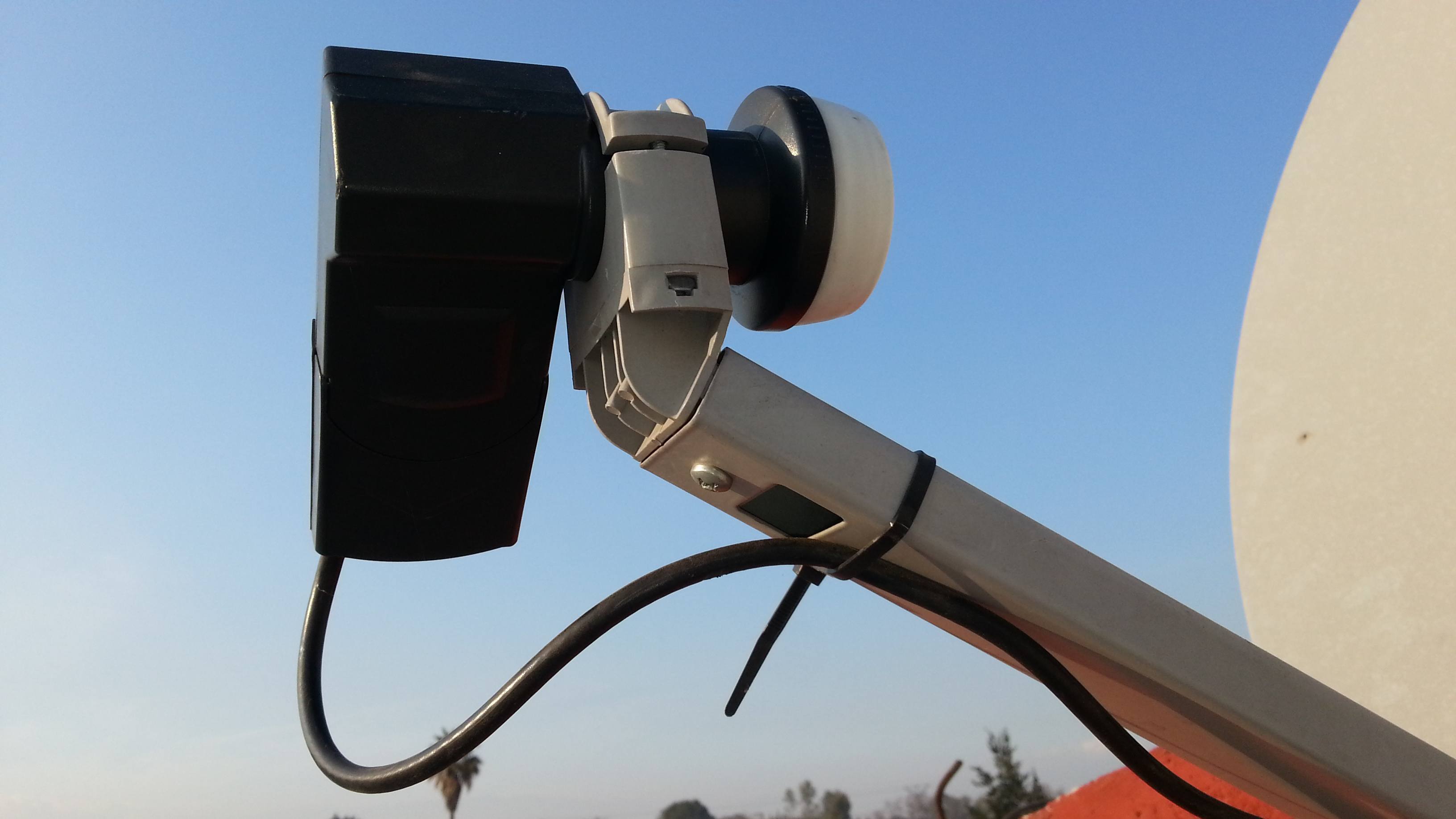

Here´s a photo of a LNB used by Sky Mexico, I think this is the one described by the OP LNB Sky 2.jpgLNB Sky.jpg

Seems to be some confusion with the recent posts addressing the original thread. The OP had a system with two SKY STBs fed by a stacked LNBF. It could not have been replaced with a standard LNBF.
