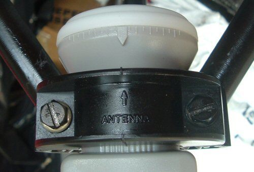

Guys, I am attaching a pic of the new lnb I got, but it doesn't give any guidance on skew. I need a skew of 30 degrees for G 10R. What are the marks representative of on this thing??

It looks like the Big ticks are 10s, the little one 5's.
To borrow heavily from PSB:
When standing in front of your dish, rotate the LNBF anti-clockwise for + skew values.
Rotate the LNBF clockwise for - skew values.
When the LNBF is straight up and down it is in the zero position.
Keep your LNBF in the zero position when using a motor mount.

the markings I think at 5,10,15 etc
I know when I aim for G10, the LNB output looks like its at almost at 7:30 (with you haveing a close True SOuth as I do (IA6), that would be about right
But skew is just a generalization. I have messed with it for optimum performance on a fixed dish

Timmy's dish is a Channel Master just like mine. I recognize the LNB holder with the "Antenna ^" indicator.
I used a Fortec FSKUv which had no markings at all that I could notice... just knew by the position of G10R that I needed a positive tilt value on my skew, started out tilted and got a signal with quality, then slowly turned it until I got maxed out. After maxing it out, I could turn it more but the quality wouldn't go up, and after more and more turning, started going down again. By this time the LNB was almost sideways :) So I turned it back about an hour and a half (in clock terms) and bolted it down.
