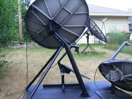

Maybe you can off-set (Tilt) your pole/mast. Have a look below, thats what I did with my 40" PrimeStar dish, I off-set the mast to 45º the same as my Latitude!
