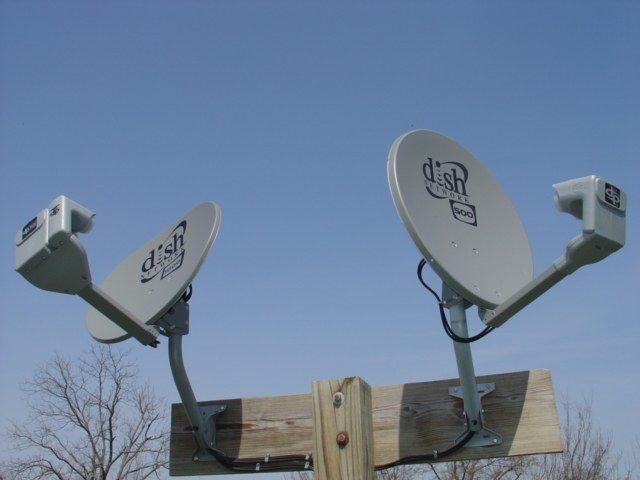

I just had a Dish Network 1500 dish set up last Sunday and I have noticed lower signal strength across the board on all the satellite positions. So far I have had no rain to see how signal strength will hold up to a heavy downpour. But I do have the 1500 set up to survive a close tornado.
