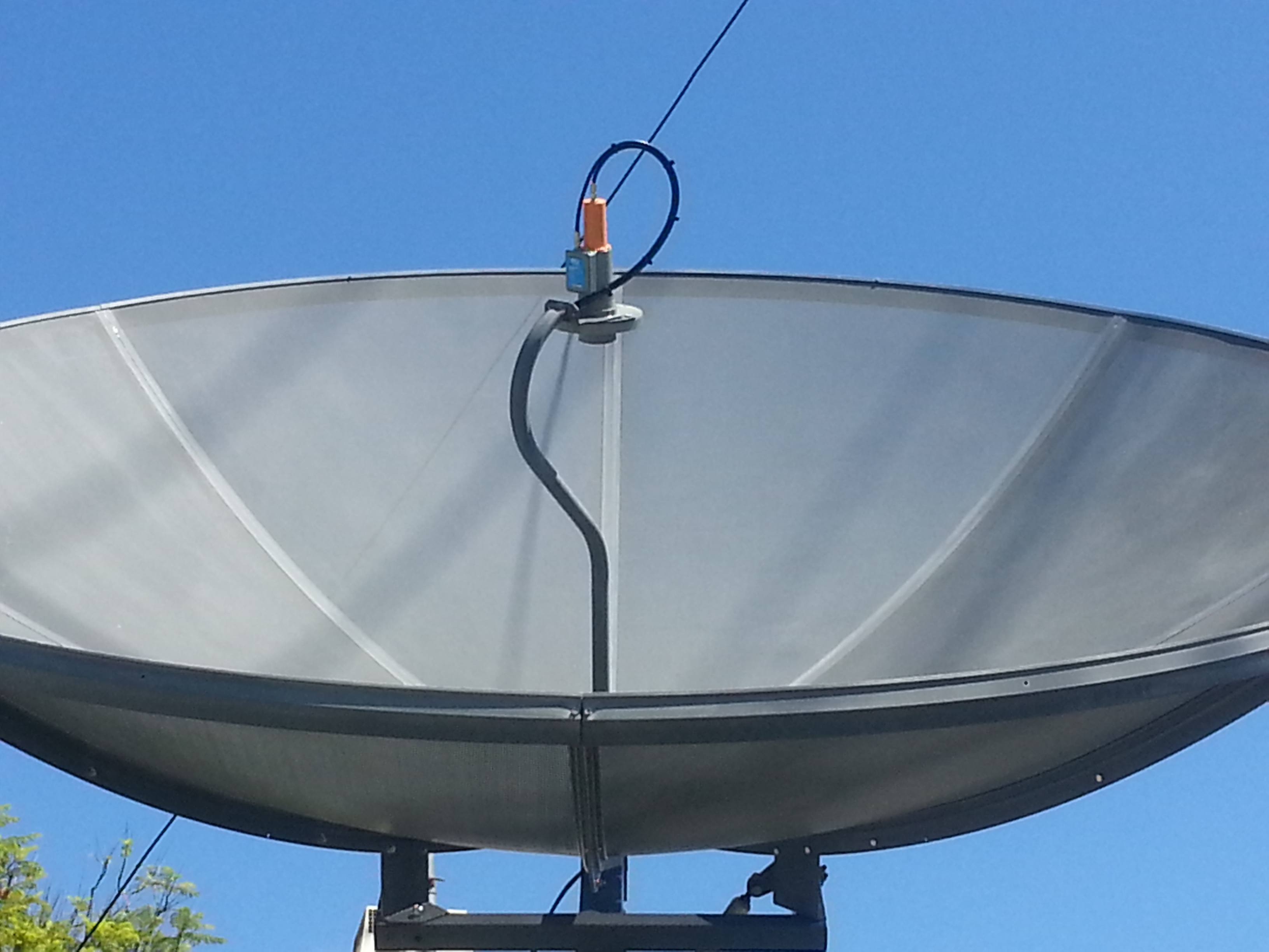

Picture of LBNF!
I'm using a WSI NS741 (dual band) LBNF. I've attached a picture to this post. The position in the picture is on the 116.8W (Satmex 8). I slid the button hook in and out to optimize the signal strength. The F/D setting was very close to the original position of the dish when I bought it (is now 1/8" closer in). The current position of the LBNF is about 45 degrees, 90 degrees being true north.

Appears you've 'covered all the bases' with the LNBF.
The only things left are the accuracy of tracking the arc and the LNBF itself.
You may need to check the scalar ring to ensure it is parallel to the center dish face, and centered properly to ensure you are collecting 100% of the signal. I need to do that on one of my C Band dishes.
Thanks for all the information. I popped the cap off the end of the LBNF today and had a look to see where the probes were. With the dish parked at true south, the vertical probe is inline with true north/south. The other probe is 90 degrees out from true north/south. Standing in front of the dish, the vertical probe would be at 6 o'clock, and the horizontal probe would be at 9 0'clock. So looks like the LBNF is setup correctly. I slid the button hook in and out and tuned for maximum signal (on a weak TP). As most of you know, the Pinnacle is a very deep dish F/D: .278. I don't know if the WSI NS741 LBNF that I have is capable of fully illuminating the entire surface of the dish. I moved my small dish away from the BUD and allot of my signal problems went away. I think signals were scattering off the BUD to the small dish, and vice versa.
T4 is absolutely correct. I used a laser pointer on mine to center it. Put a plug in the feedhorn with the pointer in the middle. Rotate it to see where it it points and go for the smallest circle. once you know you are centered there, tweak the dish. Its a pain in the butt, but remember that this dish was originally installed in the analog days. Analog was very forgiving. I think I told you in an earlier post to peak for Ku and C band would be in the bag.
