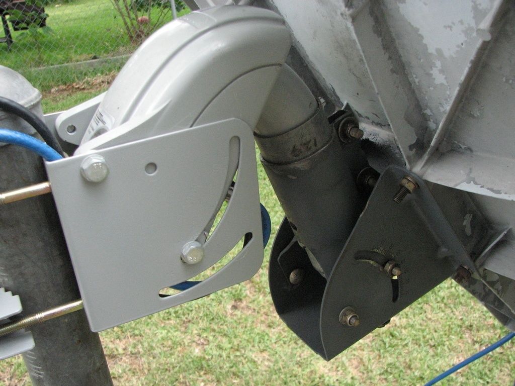

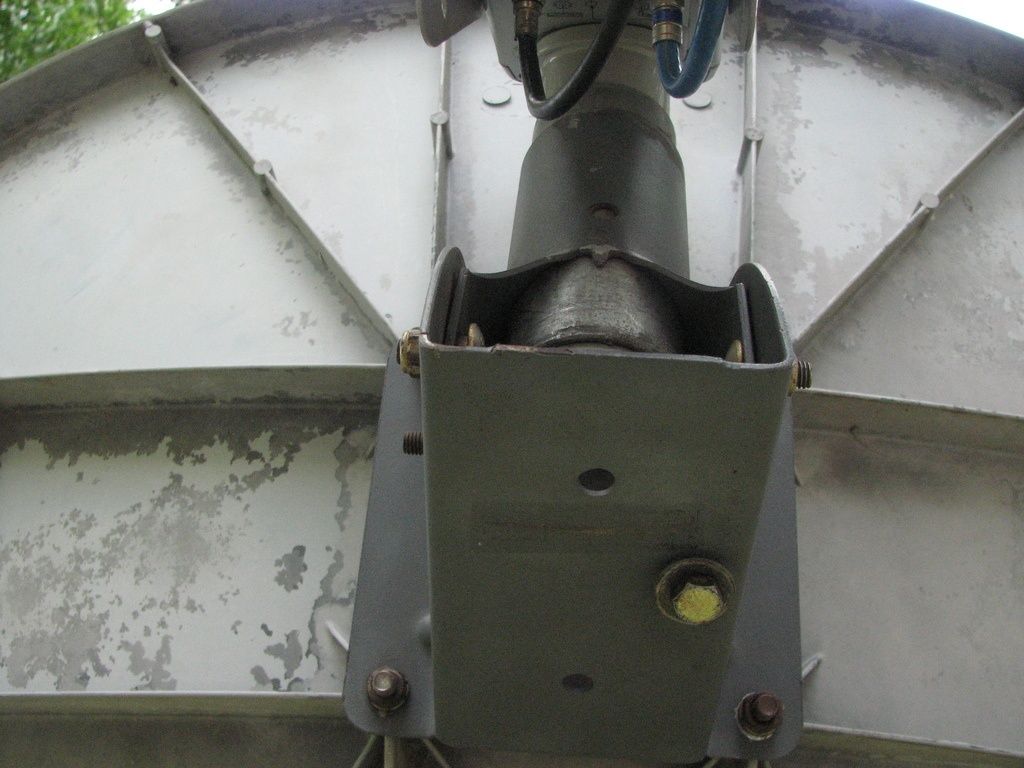

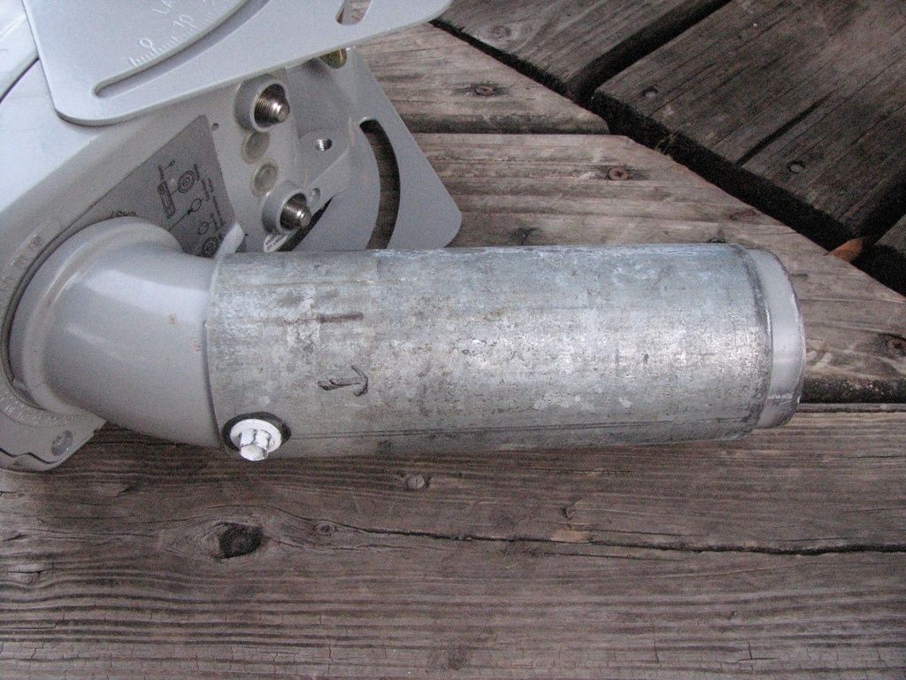

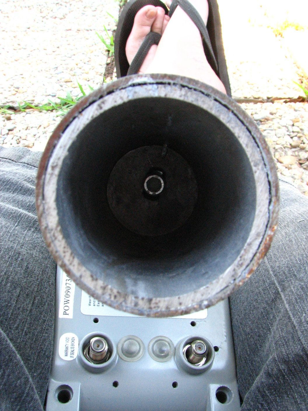

I can't pull them up right off hand but I've posted some threads and photos of my 9120 motor and primestar dish setups. My dad helped me with the dangerous parts (saws)..
It's pretty easy to do when you see how we did. I flipped the mount upside down, Dad sawed the lip off the motor tube and shortened it a few inches and notched out a rib on the back of the dish so there's room for it to tilt forward but you may not need to do that depending on where you live. We put a short piece of fence post over the motor tube then put screws through it all where it can't move.
I can say that it works great.

My Dad and I worked on these together. We built a primestar 1m oval for them and for me we built a primestar 1m round, both on the SG9120 motors with the largest motor tube.
For like way over a year we tried all kinds of kooky adapters but everything was a big goose egg. Then I thought to saw off the lip on the bottom of the motor tube and slide a short piece of fence post over it.
Bingo. Worked like a charm.
I can pull up some old photos right off the bat and later I'll see if I can find the old threads for you.
These pictures should give you a pretty darn good idea of what we did. The first dish is my 1m round and the other is the 1m oval that is now my Dad's.
