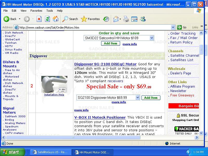

but on the motor, does it say "Moteck" or does it say "DigiPower"? I got snookered by an ebay auction. Thought I had a Moteck SG2100 and got a Digitpower
I was looking at my receipt from Sadoun and it states "SG2100 Moteck Motor", but it only says Digipower on the motor itself.
my receipt says SG2100 moteck motor also but the box says Digipower not moteck
