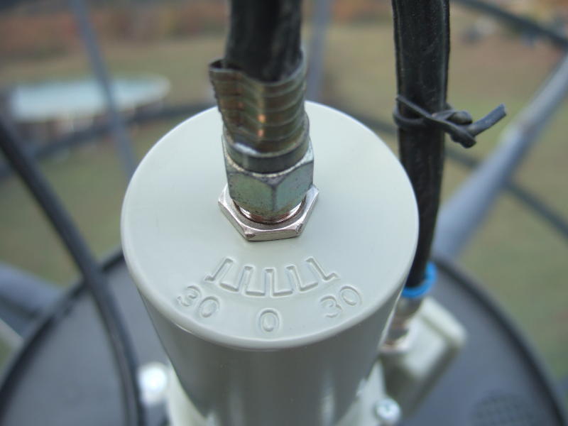

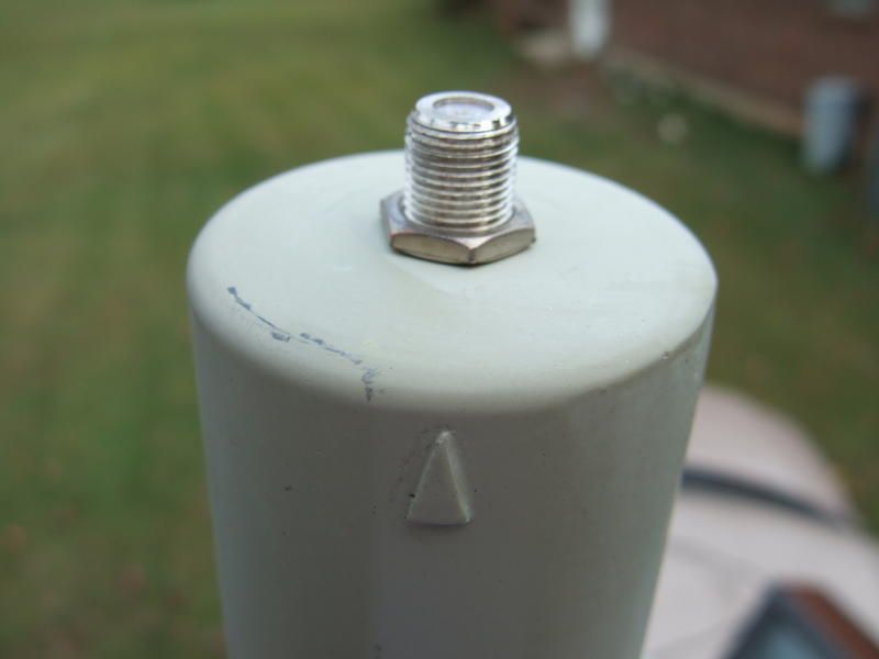

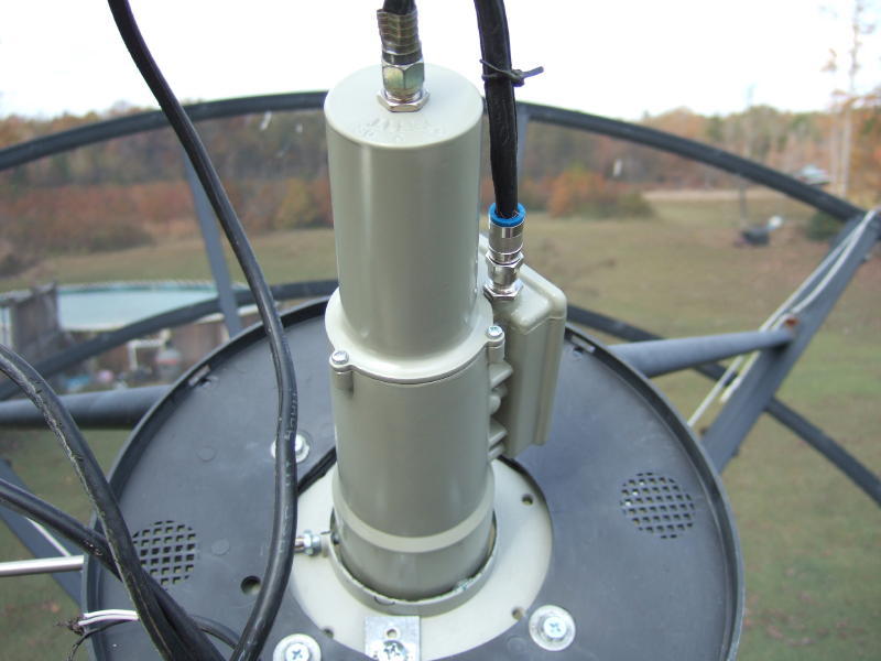

yes i get my best placement when "and i think" some have a little triangle and others have a number scale( if its this scale align zero at TS sat). I get my best reading when this is pointed at 6 on the clock while pointed at your TS satellite ( now yours may vary slightly between 8- 4 )
I dont have that LNB so maybe someone else can give you the info on that. I would set the LO freq to 10750 aim at a ku satellite (G10R at 123* west would be a good one) and do a blind scan. You can then do the same with G25. G10R has alot of KU signals and usually is pretty easy to tune in
ok here are the two versions i have ( both are bsc621) one is a scale and other is a triangle. both of mine are set with the marks at 6 o clock
you might have a slight adjustment from that ( to gain your best signal)
