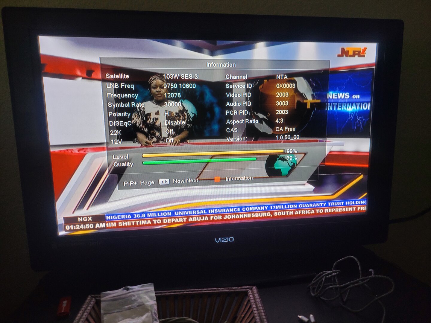

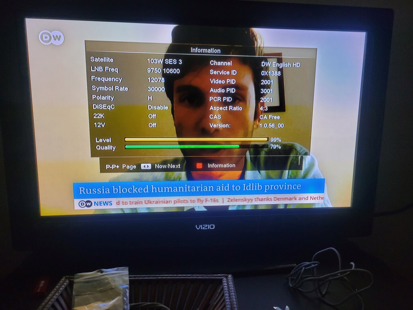

DW comes in strong even though it's only 78 on quality. NTA is also 78 but has some video pixelation sometimes, although this pixelstion is from crap video encoding, super compressed bad video, rather receive antenna issues.
