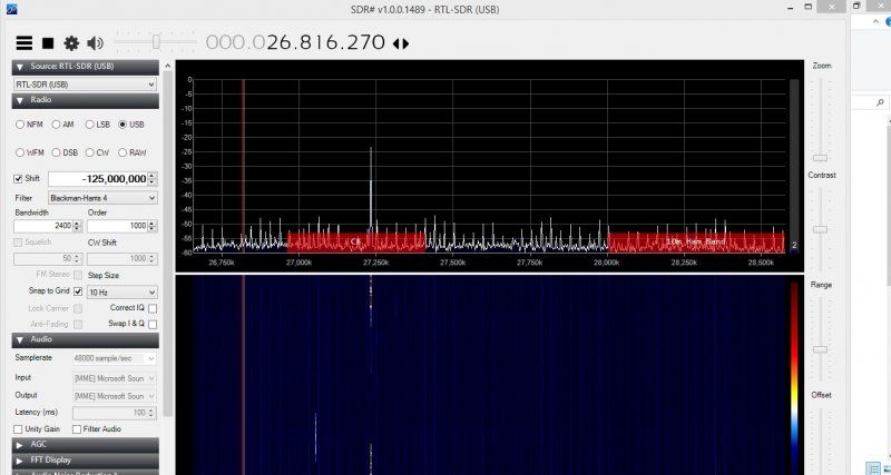

Newest revision of SDR# now shows locations of popular bands such as shortwave, BCB, air band, marine VHF, CB etc. Very nice improvements. Looks like those with the Airspy should check the new version out. But if you have just the regular inexpensive dongle the new version is something to look into also.
Found that when you download a new version, it does not have any of your old frequencies you saved in Frequency Manager, so what I do is move my old version of SDR# to another folder, then download the new version. Then I go into the old version and copy the frequencies XML file into the directory of the new version. So far it has worked for me, otherwise would have to reenter those memories.
