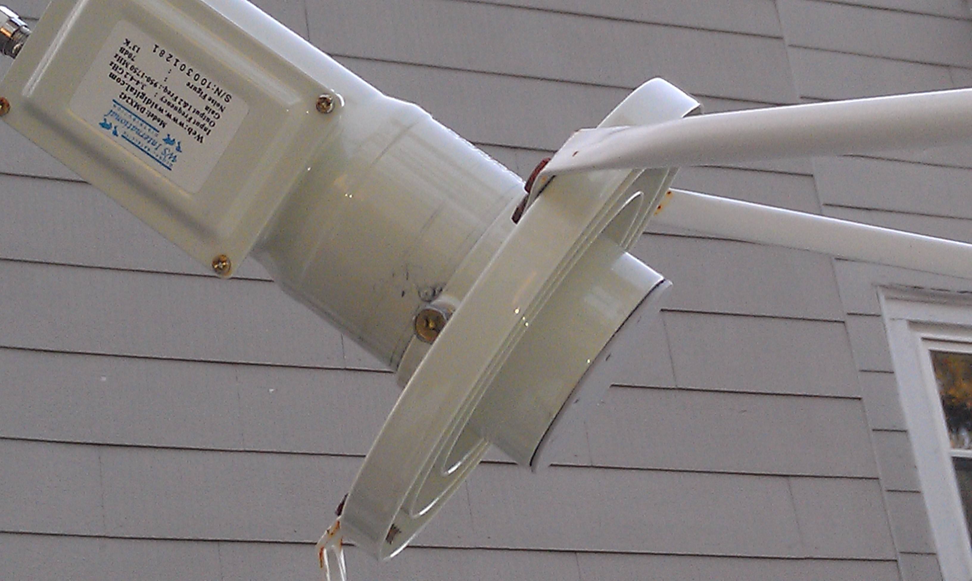

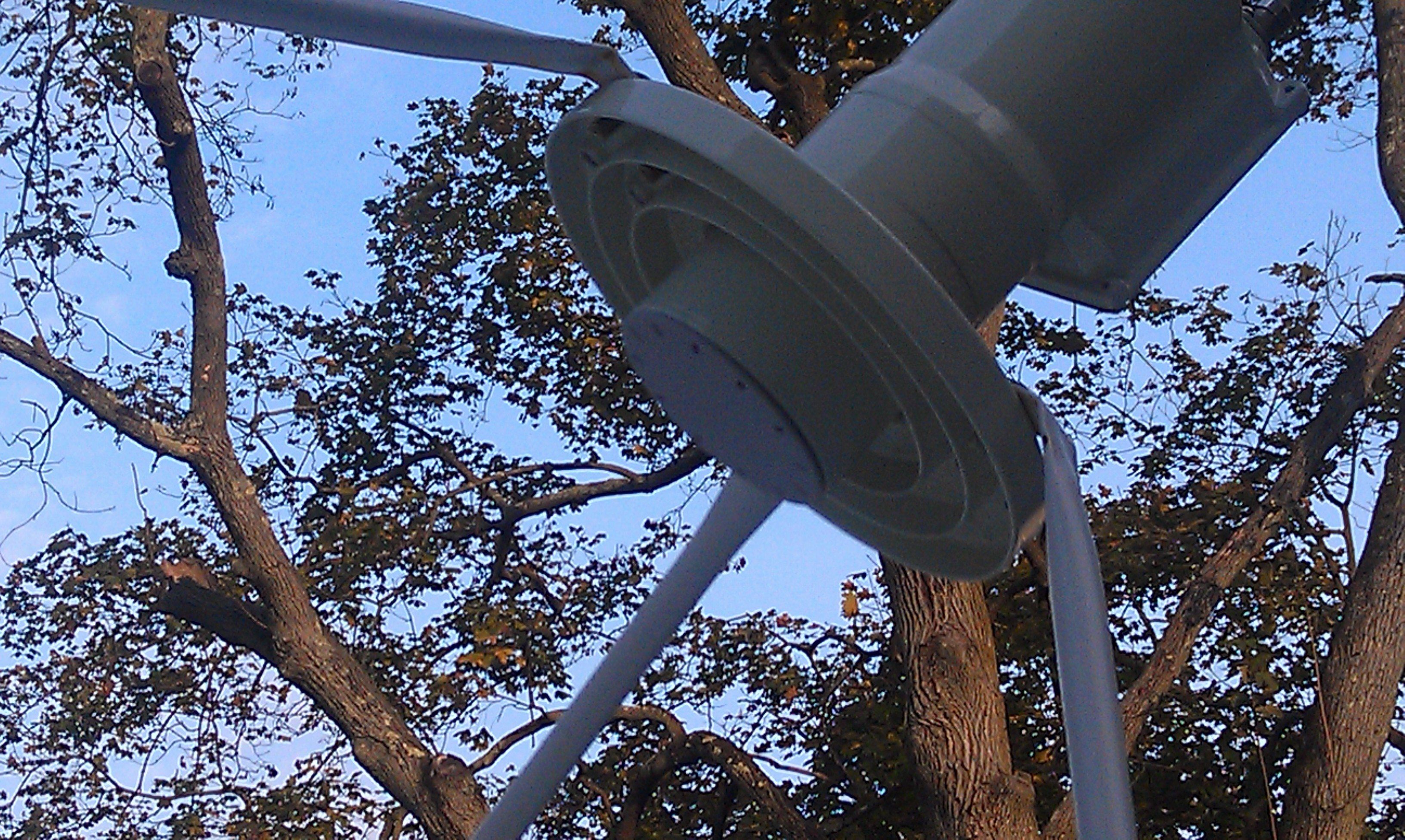

I have the WSI $69.99 6ft special, and WSI ESX242 C-BAND LNB and I'm not getting the Escape on 99.0°W and REELZ on 91.0°W, but I was getting those on my 1.2M MiniBUD, even though the signals were kind of weak. The signals should have been stronger on the 6ft dish instead of not being there at all. Could it be that I have not placed the LNB at the right focal distance? For those with the WSI 6ft special and getting those channels that I mentioned, how far is the LNB placed on your Scalar? Is the WSI special a deep or shallow dish? I have attached pictures of where my LNB is placed on my scalar. Thanks, in advance for your contributions and solutions.

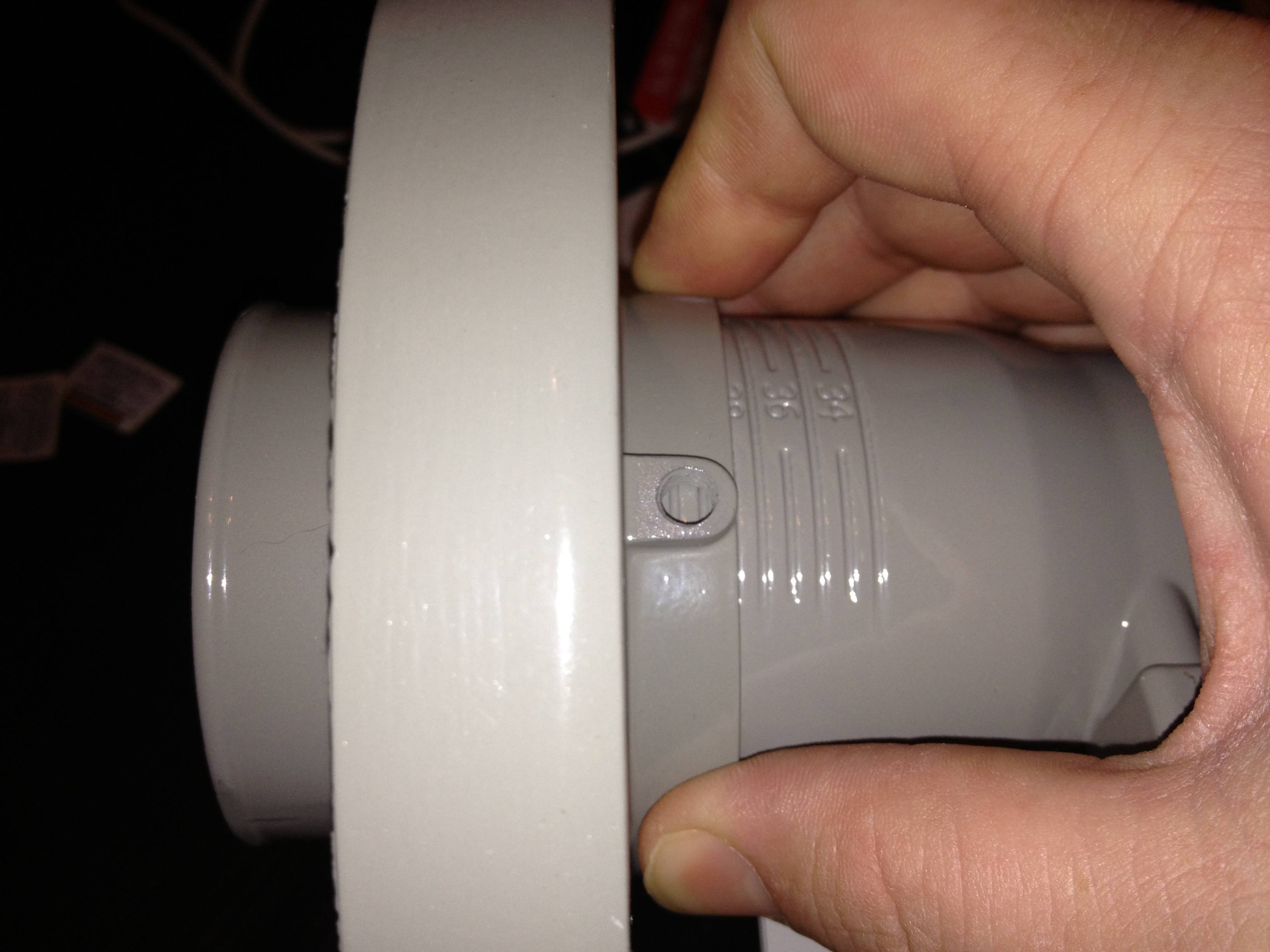

It looks like the feed throat is sticking out of the scalar a little too far for a .38 FD. Did you peak your signal by moving the feed in and out to settle on that position?
You can put anything across that hole (paper plate, piece of duct tape...?) and measure from it to about 1/8" or so into your feed throat to get your focal length.
Using the manufacturers FL and FD numbers assumes the dishes parabolic shape is at manufacturers spec.
F/D Ratio 0.38 = Should this correspond to the markings on the LNB?
Yes. I Just pulled out a new esx-242 and put it at .38 your's looks pretty darn close I can't tell from the picture angel.
