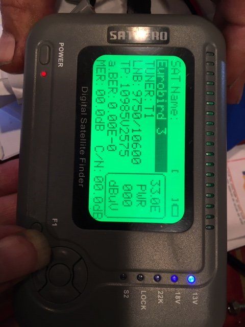

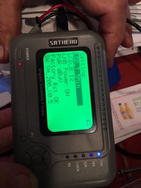

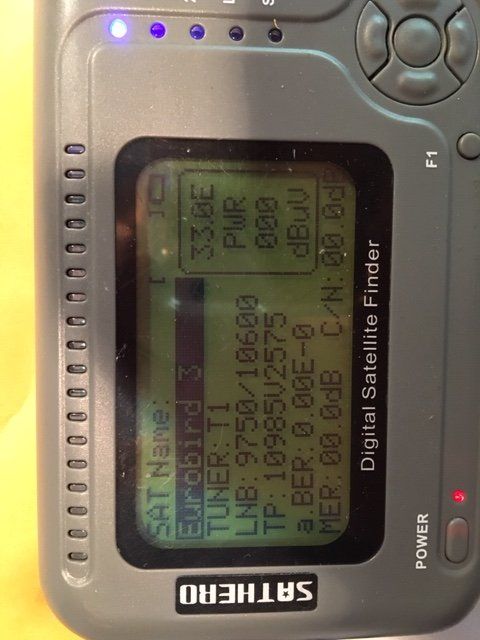

I don't have a SatHero myself but maybe post up a picture of the SatHero and some of the menu screens and also what model number it is and someone may be able to walk you through it.
I'm working on the pics (or my wife is I should say). The Model is a SH-200HD. The bar code number is SKUA73275-20709150

Sat Hero SH200HD
