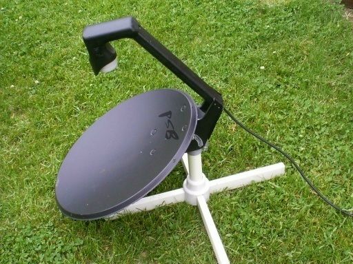

Have a look at the below link and pictures. Maybe its possible to invert ( install upside down) the dish and no one will see it!
Then there are see through dish available in the good old UK!
http://www.bbrv.dreamstation.com/sat.html

ya could be only 40 cm dish would work 80 cm dish arm would stand up to hight and i have problems again dont want to piss off the building Inspector and the Neighbour she 65 and dose not work but in Neighbour Council dont want to get on her bad side ... have a jeep and van park out side back off my house and 1 car space it old town old lol
