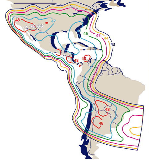

Hi:
I've been playing around with FTA for close to a year and I've been pretty happy with it. My one 'total failure' has been Sat Mex 5 at 116.8W. I understand there are some FTA channels on it and when I do a blind scan (univeral LNB) I get lots of strong TP's but never a channel. I'm located in Nova Scotia, Canada. Should I be getting any channels and if so can someone tell be what TPs I should be sticking into my receiver. Thanks

Satmex is a BUGGER to get. I am in Minnesota and its tough (I can't get BYU TV to save my soul...no pun intended). I can get a few transponders
I just looked at their footprint and here is why. I am between the lines of 44 & 45 so to get this I need a larger dish (probably a 36" for sure). Canada barely makes it on their map (except for Toronto area.) I dont think you'd get it even with a 8 foot dish.
The lower the number, the larger the dish you'd need
Hi Iceberg:
Nova Scotia is not even close to that footprint so I am out of luck. Actually my favourite satellite these days is Amozonas at 60W. Have you ever checked that one out?
