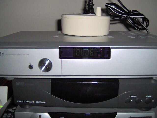

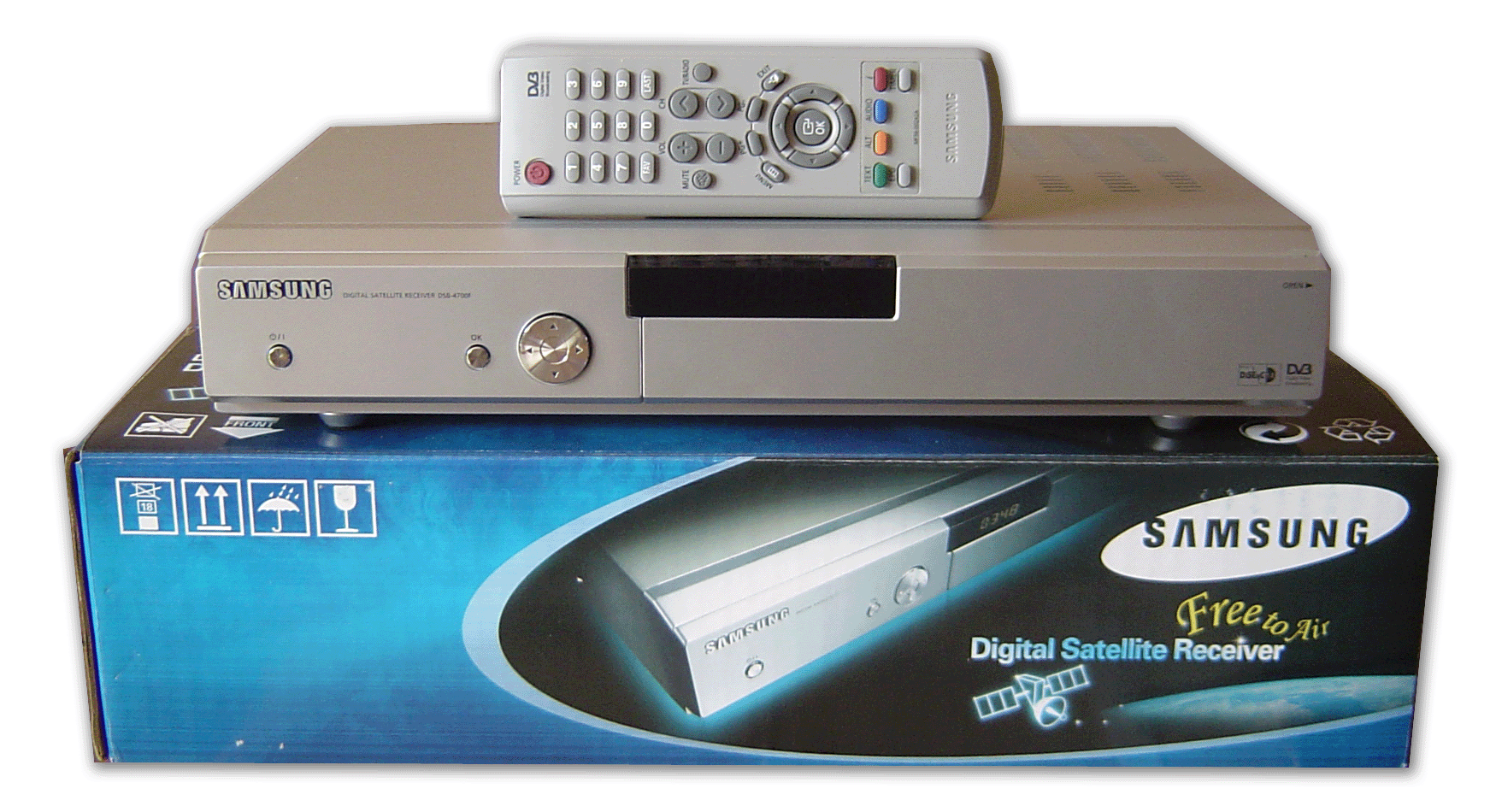

When I took it out of the box, I noticed it was a nice size unit. The first thing I liked was the 2 sets of outputs and on the front I can control the box (channel up/down, volume)

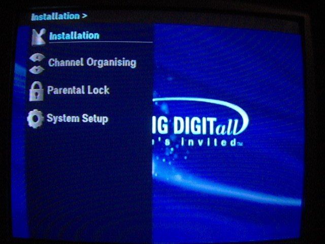

Hooked up the feed from the motorized and away we went. The remote is simple yet productive. Not a lot of buttons but you really don’t need a lot. Turned the unit on and you are greeted with 4 options
-Installation
-Channel Organization
-Parental
-System Setup

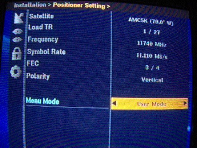

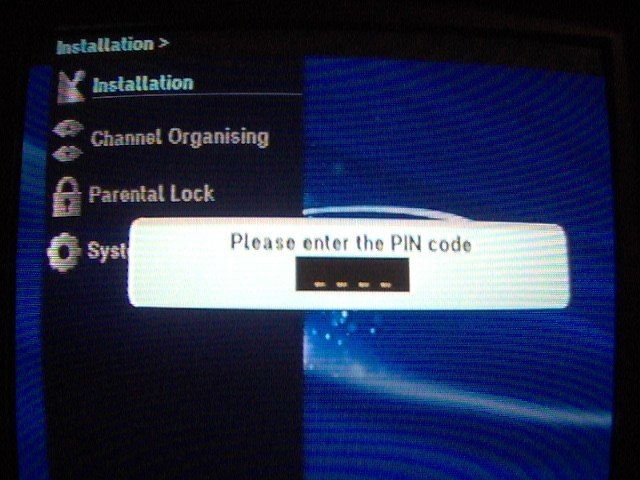

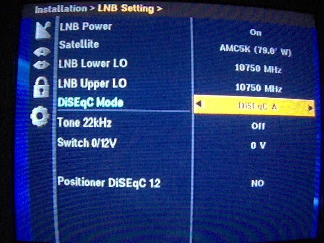

So I went into install and entered my pin code. I tried to find a way to turn that off but I couldn’t. Oh well. Entered 0000 and got into the meat of the setup. Here is where you will be most of the time if you are in the menus. I had to set my LNB LO. Scrolled through and found AMC5. It gives you the option for 2 LO’s, a Diseqc, 22k and a motor. So you could have a motor, diseqc and a 22k switch all hooked up and it will work with no issues. The only drawback of entering the dual LO’s is if you have a Universal, a newbie might not know how to set it up (some boxes you have a “Universal” option)

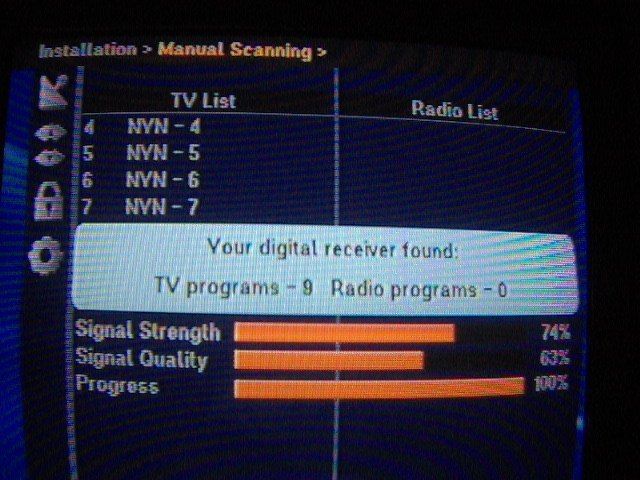

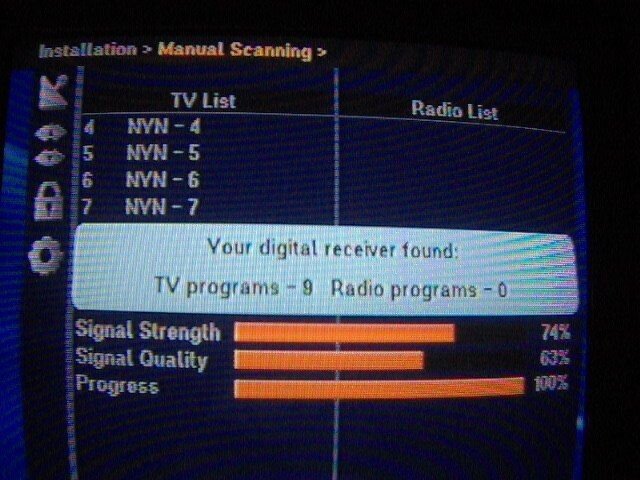

I went into the manual scan to see what was in there. There are a LOT of transponders loaded in it (including a lot of feeds transponders). This screen I like because you can do a manual scan, network scan or PID scan all from one screen. No need to search and find them. Found 12182 H 23000 (New York Net) and got a nice signal. The meter does read a little low compared to other boxes but its stable. Doesn’t really move much which is good. Scanned that in and away we went. In the manual scan, you can go to where the frequency is and press right or left arrow and the frequency goes up or down. This might help fine tune some stations or to make a homemade blind scan.

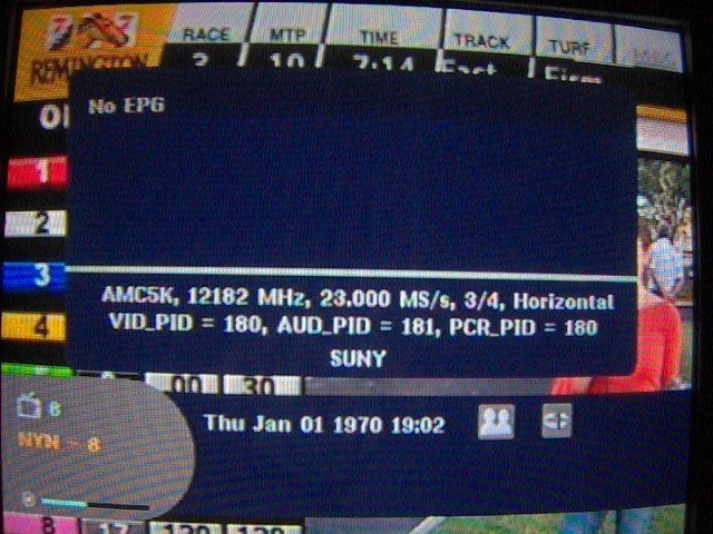

The onscreen is nice and crisp. Press “info” and yo have ALL the info in an easy to read screen. The bottom line is interesting as it tells you who owns the transponder (in some cases...some cases it doesn’t say anything). Press OK and it shows the channel list. You can sort it a few ways. Options are transponder, favorites, alphabetical or service provider. The one thing I really like about the box is one button and a little thing pops up with what your options are. There are 4 color buttons on the remote and the “pop up” tells you what each one does. Very neat! No need to read the manual

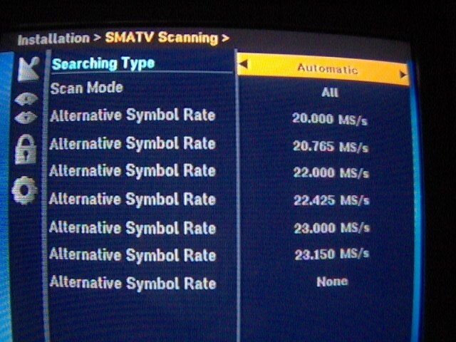

I looked for a blind scan and it doesn’t have a full blown blind scan. It has a SMATV option, which allows you to search for new frequencies with a known symbol rate. It gives you an option to enter up to 7 different symbol rates and it will scan all the frequencies using those symbol rates. Well, since 3979 is a common one I selected that and made the rest 0 and away we went. Now this was the Sunday of the airplane crash, so the feeds started popping in like crazy. In no time I had 16 feeds. The scan is thorough, it skips the frequencies by 2 MHZ and alternates polarity as it scans. So it goes 11700H, 11700V, 11702H, etc as it scans for feeds. Once it gets done with the first batch, it starts back over with the 2nd Symbol Rate you entered.

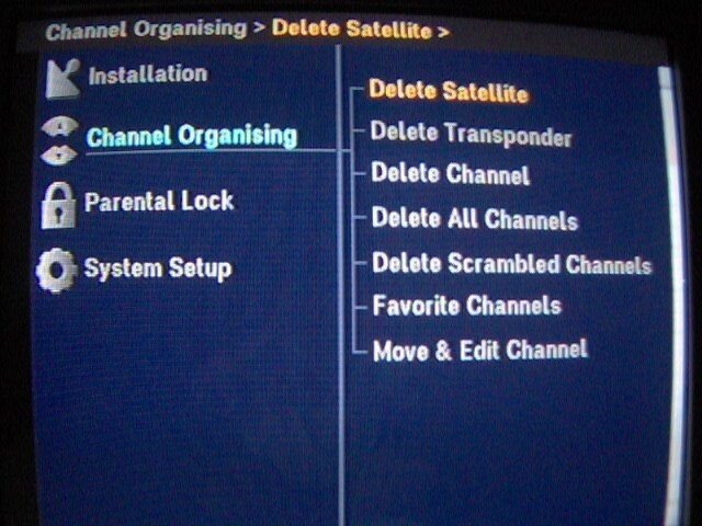

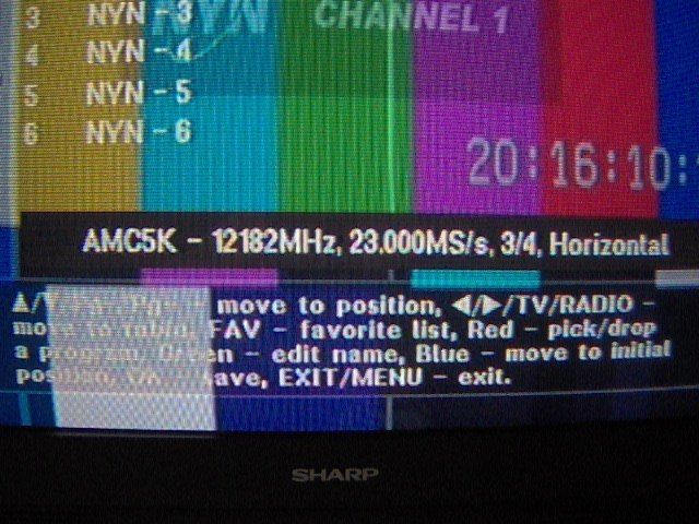

I went through the channel edit options and renamed a few channels and moved channels around with ease. Once again the “pop up” button works wonders. Press that and voila, easy to remember options.
