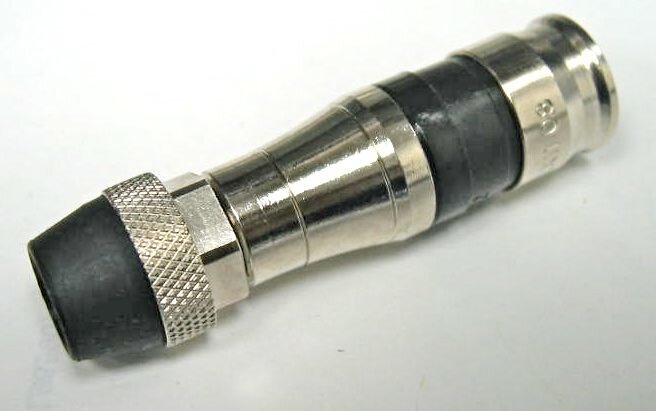

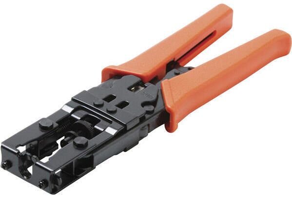

A member asked me what is available for RG11 cable as far as connectors and tools.
Here it is:
"Yes, we have good connectors for RG11 and they are indeed considered F connectors. No adapters needed.
Check items #10 - 13 here:
Cable and Satellite Connectors, Compression fiittings,grounding block
If you pick the compression type, then you will need:
This compression tool:
PFC-011-pico-Macom-RG11-Compression_Tool
If you choose the crimp kind:
You will need this tool:
http://sadoun.com/Sat/Products/S/Connector-Hex-Crimp-Tool-PVHEX11.htm
Also, you will need a RG11 stripper:
http://sadoun.com/Sat/Products/Install/PS11-Cable-Stripper.htm

I bought a compression fitting tool locally that looks almost identical to the one in the picture above.. For years I had simply used a pair of plyers and squished the crimp type ends on to my cable runs. This past week I truly learned about how awesome proper compression fittings are. I had been struggling for over a year with my motorized FTA setup where the dish would only move if I selected a transponder that was Horizontal, so that the receiver was pushing out 18 volts to move the dish. I replaced all of my squished-on connectors with proper compression fitting ends, and WOW what a difference. My Motorized setup works on demand, and it doesn't matter if I select a horizontal or vertical transponder when moving the dish. Signal strengths are excellent too, without any glitching in the video. I am a huge compression fitting fan now.. I've replaced about 15 connections so far, and have got a bag of 50 connectors on their way (which should be here this afternoon).

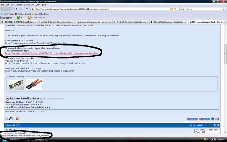

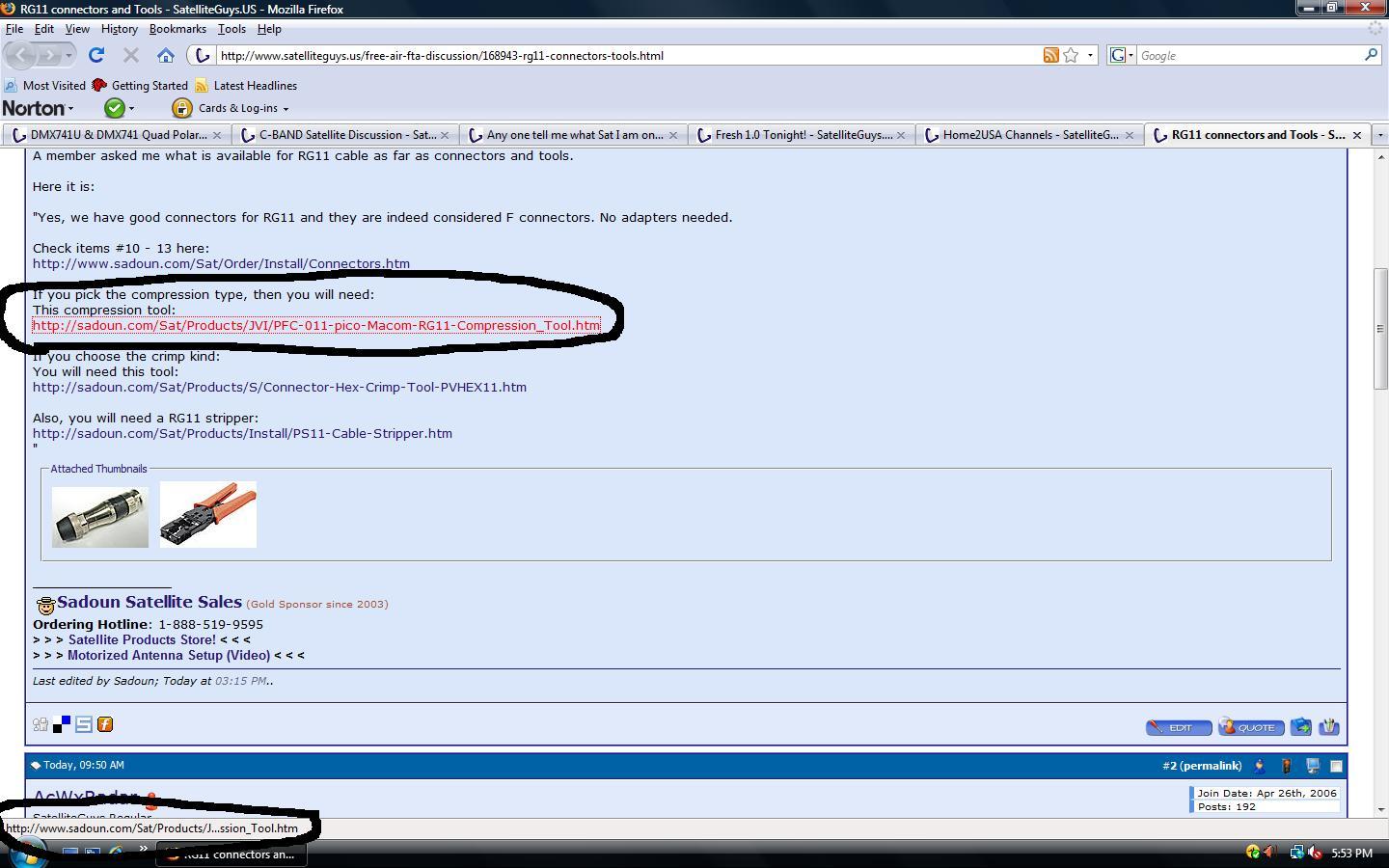

still not fixed. The embedded link is missing part of it.
See the circled at the bottom. This is when I roll over the link at the top
