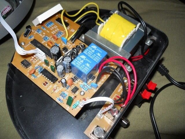

Let's take it apart!
Circuit board is VERY good. Soldering is nice, components evenly spaced. It gets an A in my book. F Connectors are high quality.
So here is my opinion. Out of 10, it gets a 7. If you want a good postioner, get it!

I don't know if this influenced your grade, but two deficiencies I see are:</br>
1. The RF block is not enclosed in a shield.
2. At least, the transformer is on all the time, or it seems that way. They should at least have had a low power logic supply, which turns on the main transformer. A most they should have used a switch-mode supply, and a double insulated 18AWG cord.
When I first got into C-band, I had a manual actuator controller which had separate power supply transformers for the pulse counter and display, and for the motor control. I put a switch on the AC side of the motor, and another to switch the display off.
