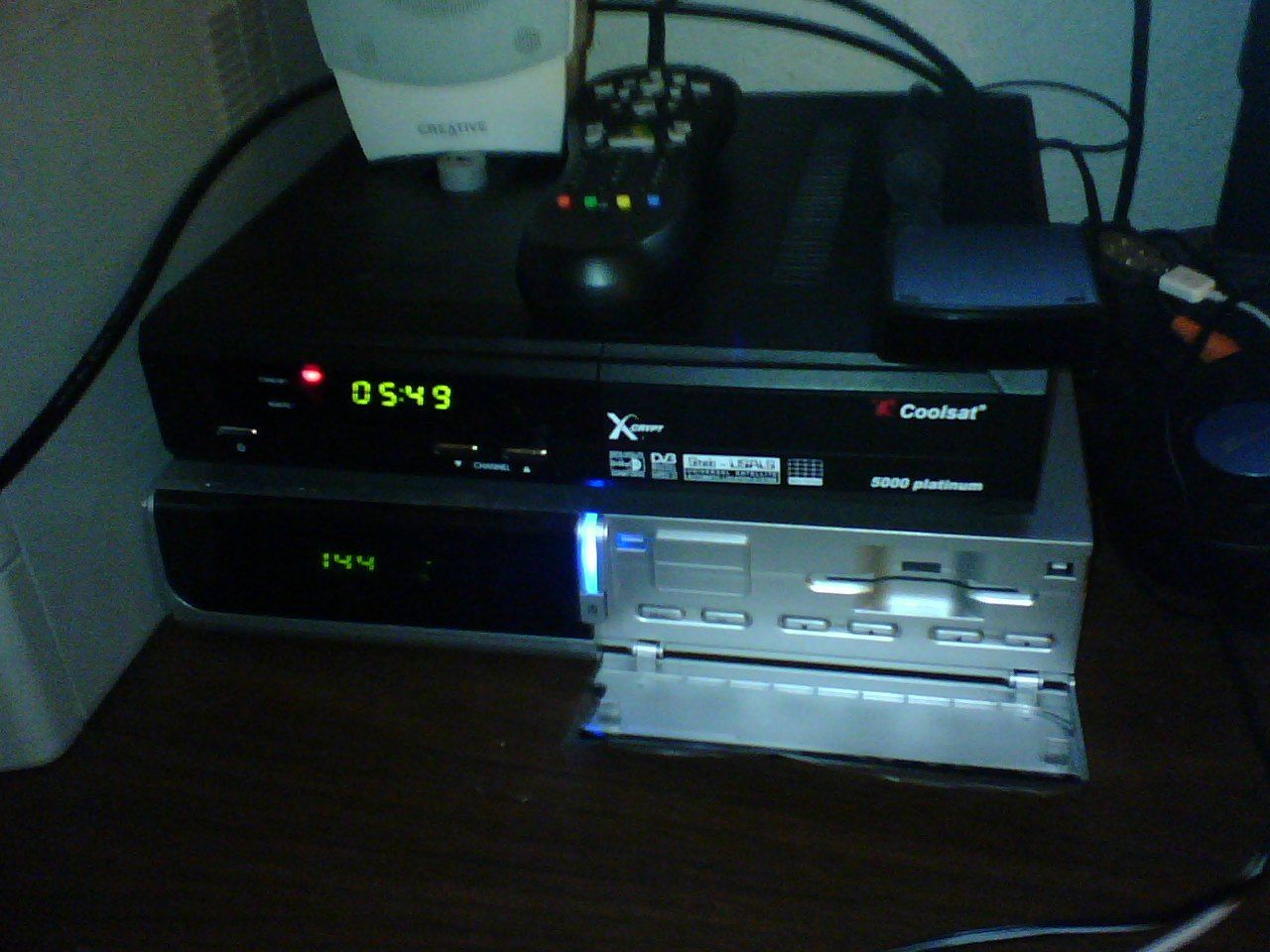

Size-wise the box is approx. 1/4 inch wider than my Coolsats. Just enough to take notice, but not enough to be a bother.

Front Panel
The front panel is clean and smooth.
On the left 4 digit panel shows time, channel number, PLAY, or rEC depending on the unit's status
A red LED is lit for unit being in standby or when a remote keypress is received.
The green LED becomes lit when the unit is on.
A vertical blue light bar is lit when the unit is on. The color is similar to the blue that usually you want to cover up, but this is dim enough that it is completely unnecessary.
Below it is the front panel power button.
Behind the flip down panel on the right, the buttons for MENU, OK, Channel Up, Channel Down, Volume Up and Volume Down.
Above the buttons sit a Smart card reader. The documentation states that I can put a Viaaccess or Irdeto card in there and everything should work. (If it takes Irdeto 2, I'll be a happy camper since I'll be able to sub Setanta, at least in theory.)

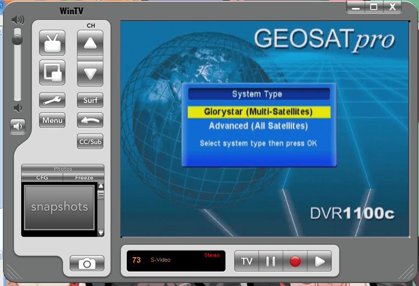

First thing it asked me was Language and presented me with the North American standard of "English/Spanish/French"
After pressing enter it presented me with the most perplexing, yet pressing question.
Glorystar(Multi-Satellite) or Advanced(All-Satellite)
For the review I'll go through the Glorystar side as well but I originally chose Advanced when I got it

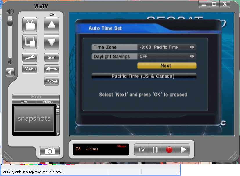

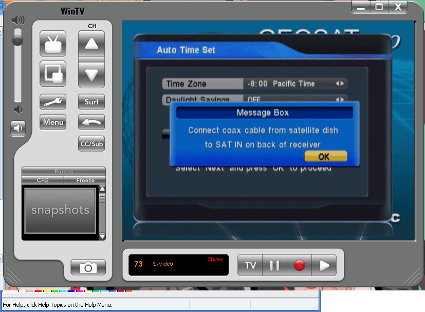

I was presented with a timezone selection.
Next the box prompted me with a real shocker. "Connect coax cable from Satellite dish to SAT IN." Of all the habits not to get into, hooking up a satellite system into a live box is a good way to fry parts.

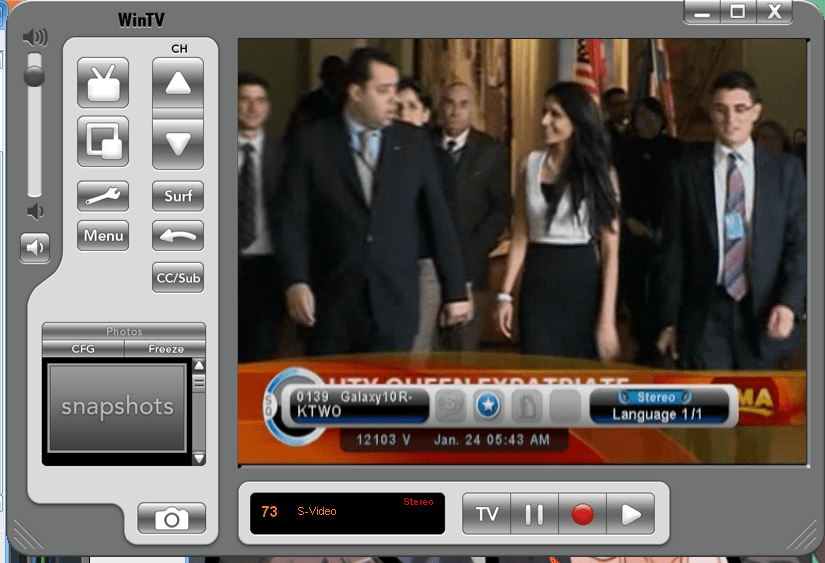

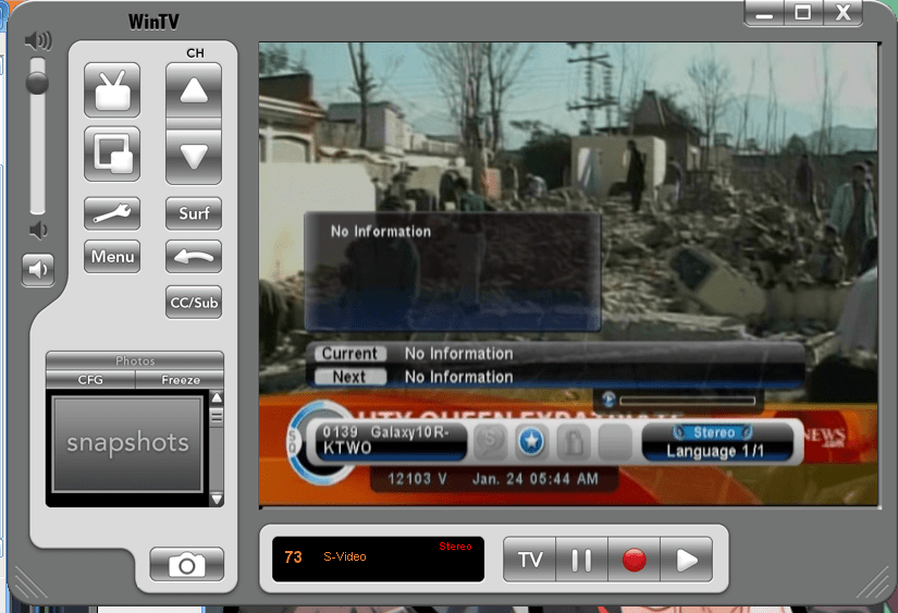

After hitting enter, the screen showed what I presumed to be the signal screen. A dull pulse was coming from the speakers now. Hitting the blue button would silence it. Looking over the screen once more the system wants to be aimed to watch 3ABN on AMC4 at 101W
Too bad I won't get far with that. My system is such a mix that I'd be shocked that the defaults were the same.

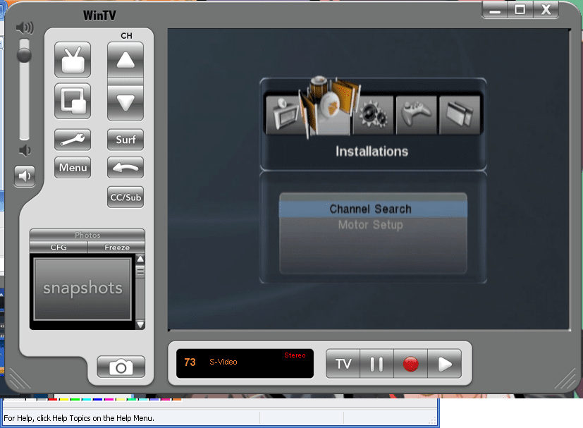

Menu
The Menu is divided into 5 sections,
Setup

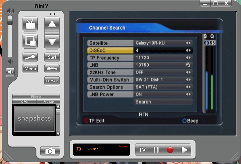

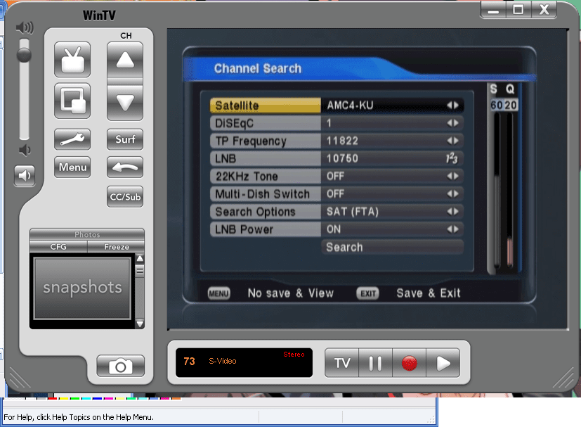

Channel search is the menu we want for setting the system up.
Now the names of the satellites and transponder were a bit out of date when I chose Glorystar mode and were even further out of date when I chose Advanced mode.
See USB down below for how to update.
After updating the transponders via Channelmaster/USB, I poked around at the various ways to setup dishes on this box
It allows for Diseqc 1.0 as well as Legacy DishNet SW21, SW42, SW44, SW64 and 22kHz tone.
There is no Diseqc 1.1 support, but it does USALS and Diseqc 1.2
I can't comment on Motor functionality as I don't have a motor.
The fact that it allowed for SW21 made me giddy since I had some sitting around from my Starband Dish that came with some. These SW21's now had some legitimate use.
There is quite the list of LO's on this box.
There is the standard 5150,10750,10600,9750,11250 but it also has Dishpro, Dishpro FSS, 5150(0kHz)/10750(22kHz) and some others.
In setting up the system, if you type in the LO frequency instead of pressing OK and selecting it from the list presented, the next time that satellite is brought up first when reentering the satellite setup, the LO will be 0 instead of what you had previously punched in.
(To reproduce: Menu -> Right-> OK -> manually punch in LO;save and exit; exit and view a channel on the same satellite that you manually punched in that LO for; Menu -> Right-> OK -> LO is now 0)

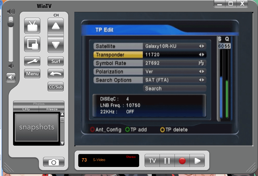

Now the transponder edit function (hit the red Teletext button in Channel search) make editing a transponder a breeze. On my Coolsats, I can't edit the frequency of a transponder on the box itself (without losing the channels), I have to drag it over to my computer and edit it via Channelmaster.
On the DVR-1100c I can edit them without making a fuss at all.
Searches can be done by All Channels, SAT(FTA), One TP, One TP (FTA) and of course Blind Scan
Each search definitely takes longer than my Coolsats but not enough that it makes me annoyed or wanting to time it.
Blindscan has 3 refining options.
Freq. steps defaults to 4MHz and steps are in 2,4,6,8,10 Mhz
Symbol rates defaults to all and offers 8000 over, 8000 under, 8000~4000, 4000 over, 4000 under selections.
Polarity defaults to All and offers Horizontal, Vertical

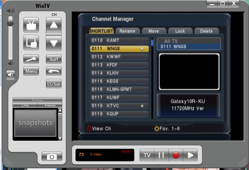

The Channel Manager is quite complete except for the lack of PID/VID/AID editing.
Brian said that that part was in the works but if you can just use channel master you should be fine.

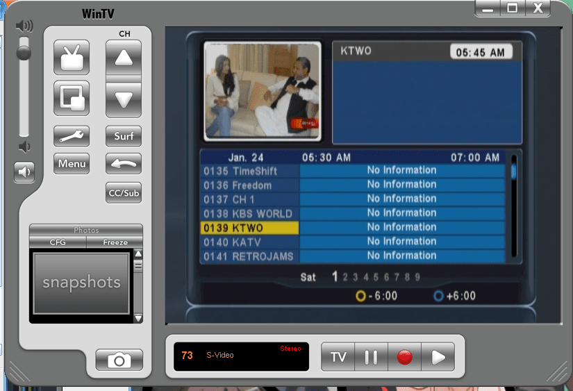

General Use (Viewing)
As a general use FTA box, I think this is the one for the family room. With 8 Favorite lists, most families will be taken care of.
TV channels are numbered starting at 100 with radio channels starting at 1000
Volume adjustment on the DVR will affect the volume coming out of the optical out.
My Coolsats do not do this.

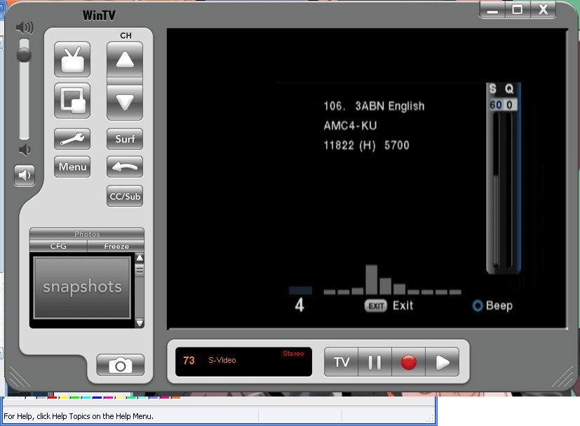

The remote has a orange button for bringing up the signal meter. This was the meter I had been looking for. Where the Coolsats got stuck (while locked-important detail here) the DVR meter would move and show improvements through 10 points. Finally I could fine tune!
Much of the screen space is taken by the 10 bars that show the previous 5 seconds.
Annoyingly though, It automatically gives off one of 2 tones depending on if it is locked or not. High pitched for locked and low-pitched for not locked. The sound is turned off by pressing the blue button.
However I must warn that this signal meter is not nearly as useful for putting up new dishes as my Coolsats are. The meter does not react until the unit has enough for a lock.
As far as sensitivity goes, this unit beats my Coolsats in viewing. On the Coolsat meter this unit is able to lock and keep a presentable picture and sound up to 3%(coolsat meter) lower than my Coolsats threshold. This makes it quite the winner in my book.
The difference is enough that I could get MHzWorldwide (a 2/3 FEC), solid and perfect picture, on a Voom dish (26"x24" or 68cm according to global-cm) in a 80cm if contour maps are to be believed) while my Coolsats would block up, green-screen, and squelch at me.
It's enough of a difference that my grandparents are getting this DVR now that I'm done with this review. It's always that last 3 percent that ruins FTA for them.
Now once the DVR reception breaks threshold and has a lock, it can use error correction to hold a presentable picture and sound at 5 points below threshold (on the DVR meter)

Menu
Code:
Channel Manager | Installations | Options | Utility | Accessory
Channel Manager | Channel Search | OSD Setup | System Info | Time Machine
| Motor Setup | Control Panel | USB | OTA
| System Info | Time Record | Smart Card
| Time Adjust | Factory Default |
Meter equivalents
Code:
FEC Threshold: * 1/2 3/4 5/6 7/8 Perfect
DVR-1100c : 0----7---30---40---50---59--(>70)
Coolsat 5000 : 0---20---60---63---66---69--(>72)
Coolsat 6000 : 0---20---60---63---66---69--(>87)
* : Almost on the satellite when aiming.

Since Program Guide info doesn't exist in North America for all but a few channels FTA, 8 recording timer events are all this box has to offer as far as automatic recording. These are all lost in the event of a power loss (Yes switching the power switch on the back will lose the timer events)

Unfortunately I didn't take any presentable pictures of the unit, and I won't be around the unit until Thursday to get good shots of the front, back and remote.
