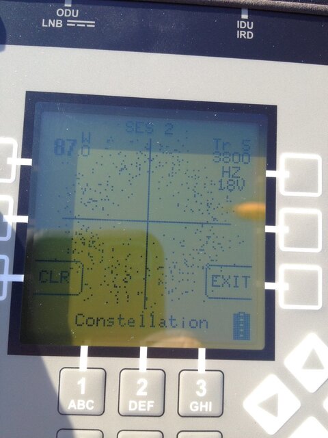

Just came back in after going outside to mess with things more and see if I could bring up the S2 signal and eliminate some of the wind issues (we are having an amazing day here but winds up to 40 MPH)

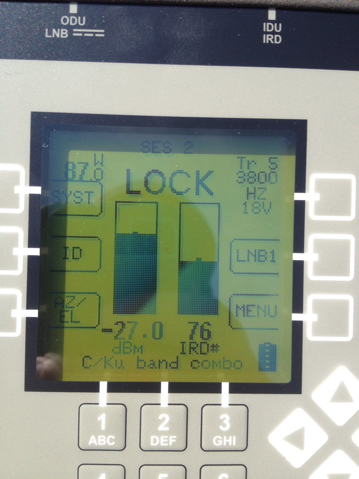

Needless to say I was able to bring the RTV 3800/H signal up to 82 from a 76 and it seems to have taken care of the wind issue the wind is blowing but no break up of video on the TV.

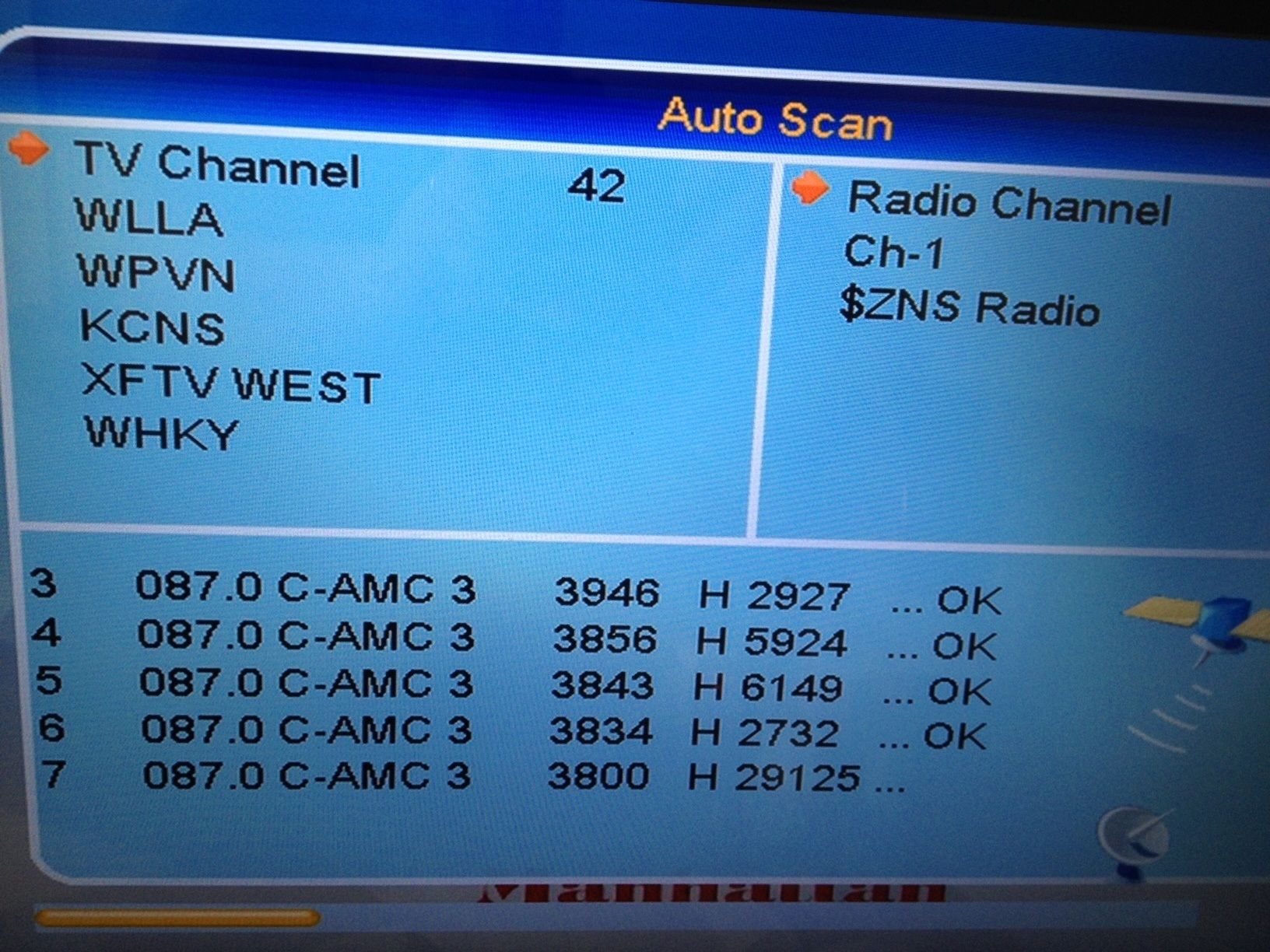

What I find interesting is while I am getting such a great signal on 3800, I am getting nothing at all on the 4080/H transponder. Not even a peep of a signal on the 4080 transponder. But I am VERY happy to have such a great signal on the 3800/H transponder! :)

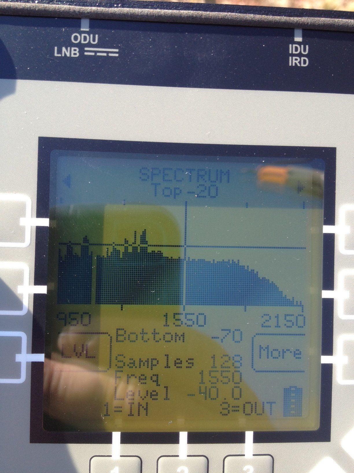

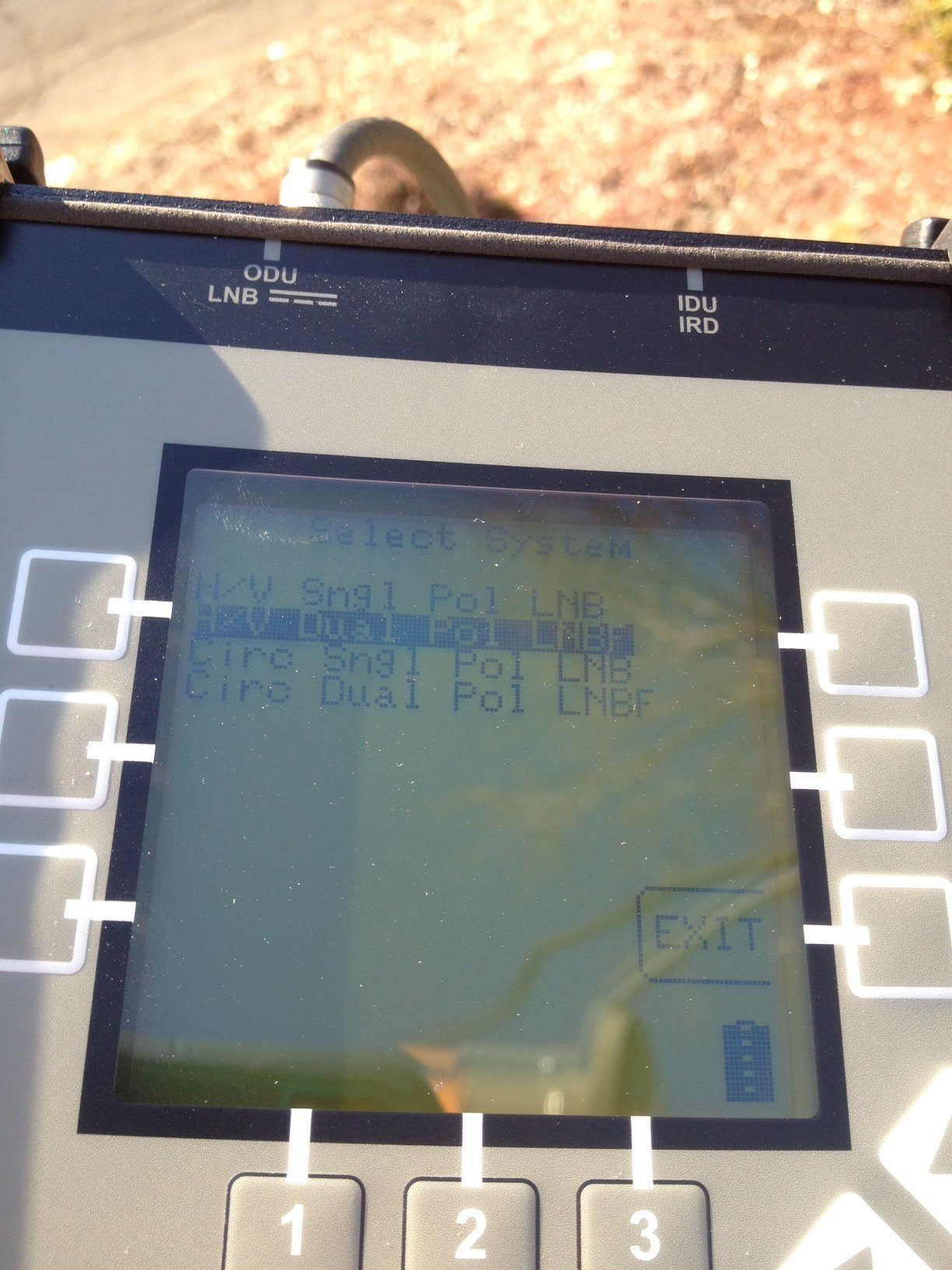

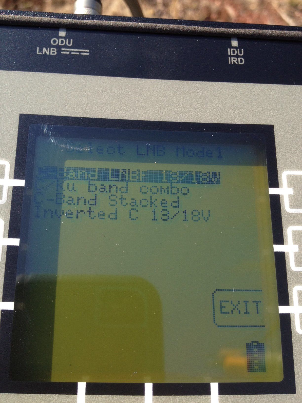

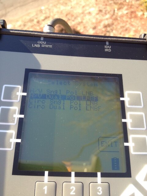

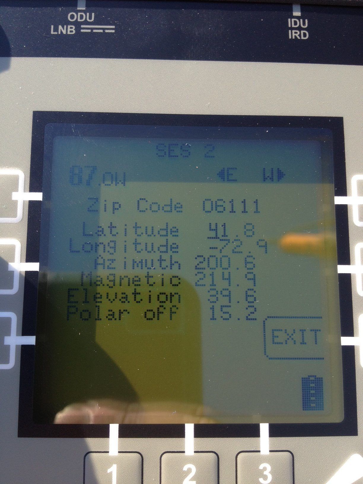

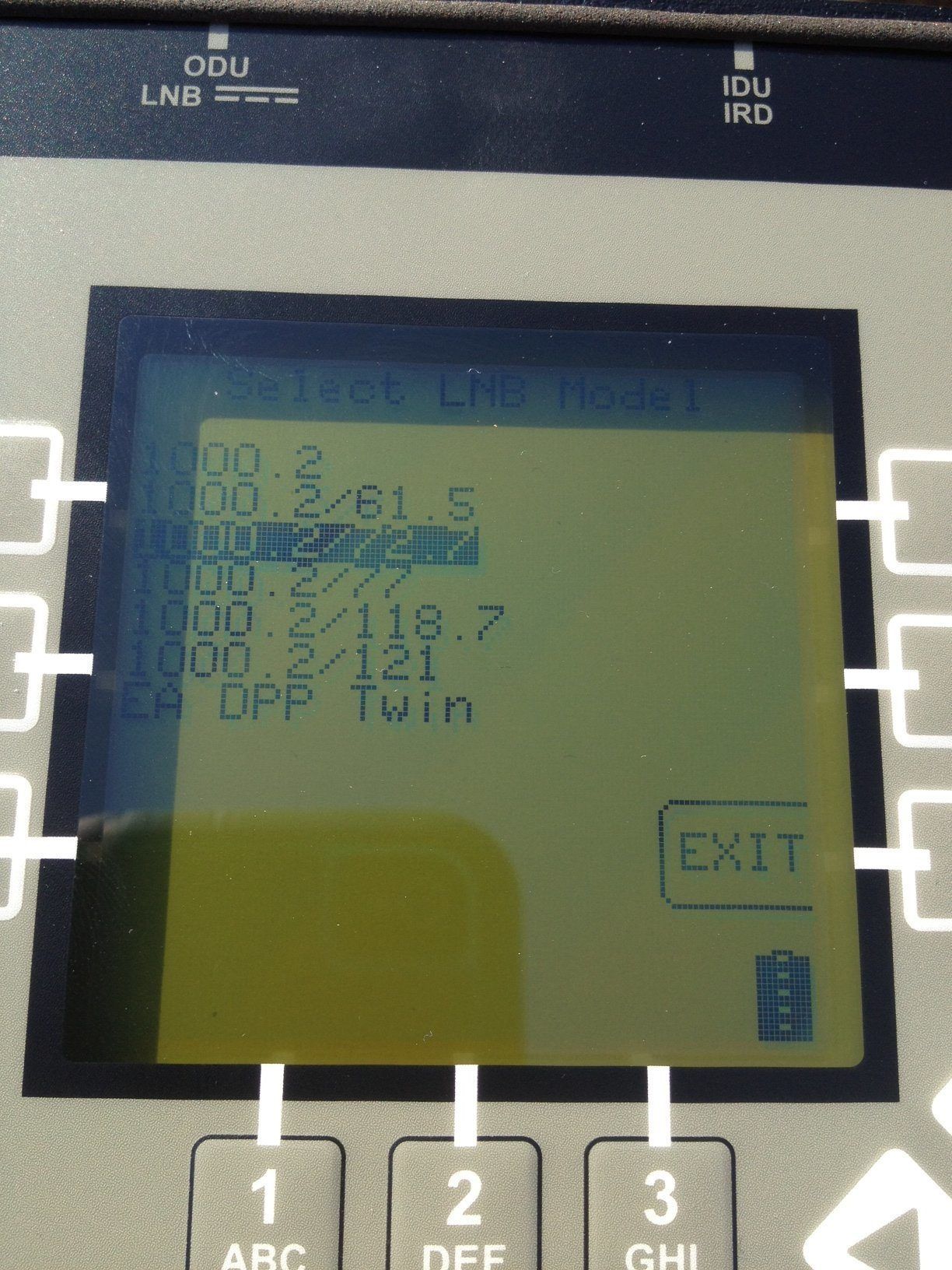

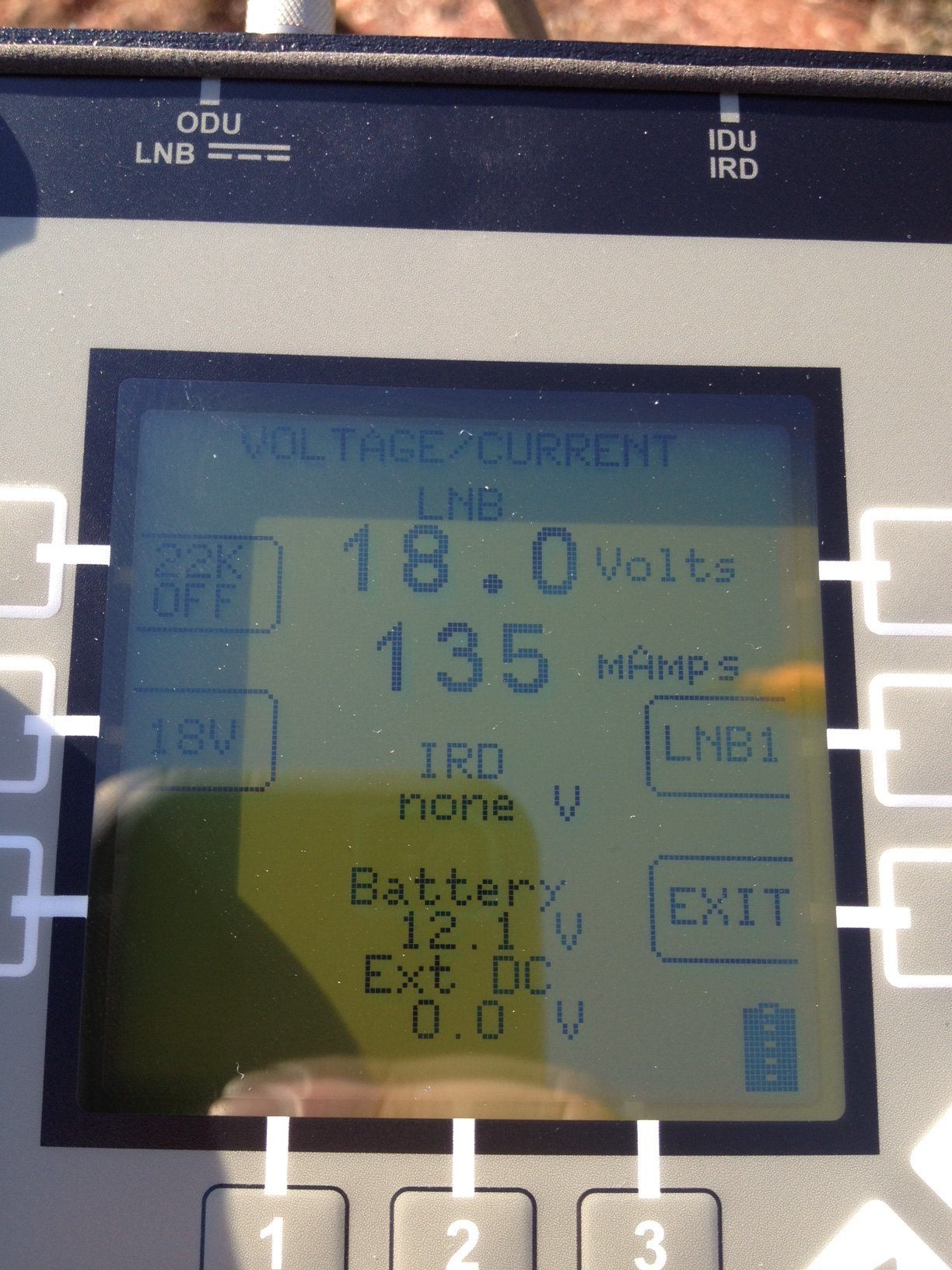

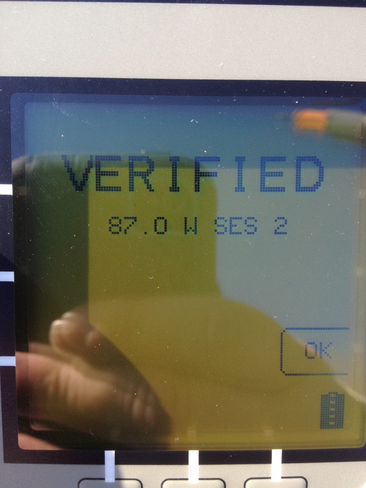

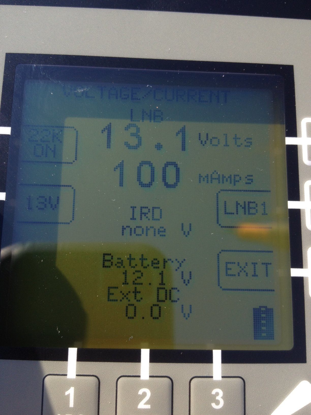

I wish there was an easy way to take screen captures of this meter. I took a few pics that may interest some folks but unfortunately I get a bad reflection as well. :)

Over the excitment of getting the transponders I couldn't get before I forgot to mention what the Turbo S2 meter helped me to find out about my setup. It taught me that my LNB was not perfectly centered on the dish. While I was able to get the RTV S2 by just moving the LNB, I was not able to get a consistant solid lock on the transponder until I moved the LNB holder on the dish and I did this by bening the arms holding the LNB. On my dish there are 3 arms coming up which hold the LNB in the center. I found by pressing on the lnb holder my signals would go up if I pressed it a certain way. So then I pushed and pulled on the holder arms until I had maximum signal.
My RTV signal on 3800 is now 85 and is no longer going out when the wind blows. and across the arc, on most transponders my signals are in the 90's. I have NEVER had signals like this before!
I got to admit I would have never of known or tried this if I didn't have this meter, I thought my C Band signals were the best they could get using the old meter, but in trying to lock down this ellusive S2 signal it made me try things I have never tried before.
I can't tell you how HAPPY I am now! There are a number of S2 signals that I could pick up before (sometimes) and now I pick them ALL up. Its almost like a got a new bigger dish!
