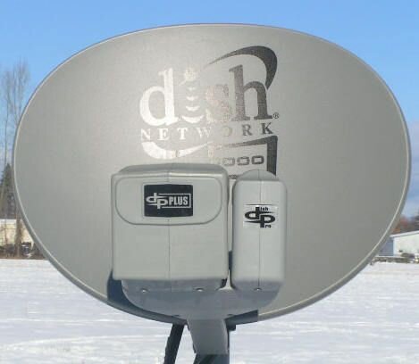

The dish had 3 lnbs (I think) it looked like two. One was a solo and the other looked like 2 lnb's molded together.
That sounds like a DISH 1000 the switch was built into the one that looked like two molded together, it was not a free standing switch.
The dish LNB looks like this? http://www.satelliteguys.us/attachment.php?attachmentid=24719&d=1210909907 If so, then there's your switch.
If so, then the switch is the one "molded together" and the other is a single lnb (technically could be a dual but I say single for simplicity.)
Either way, that's what they'll be wanting back. The LNB's.
