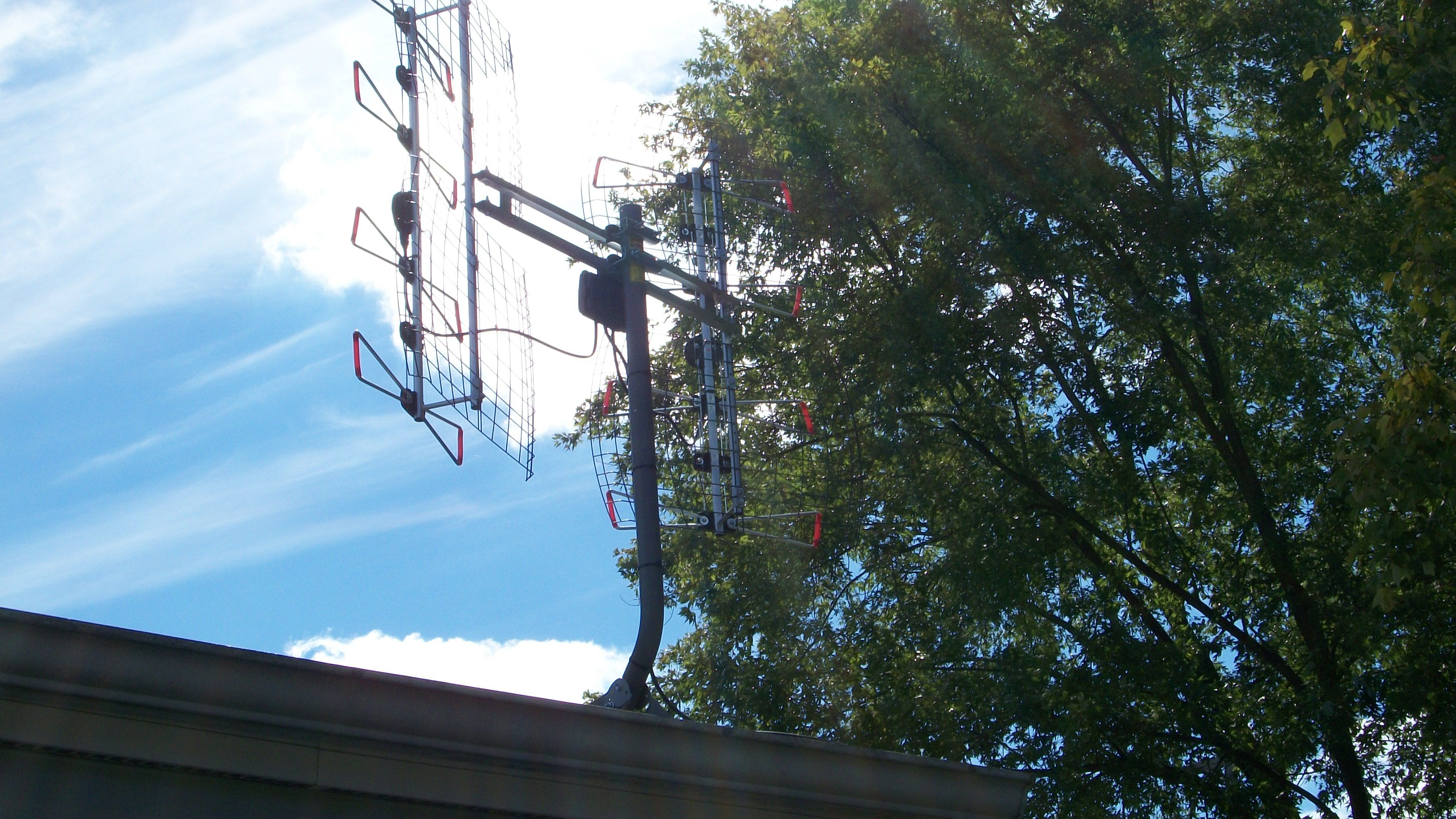

Thanks guys for the suggestions. I've decided to leave them in place until I get a new roof. This weekend, I used one of them to mount a 30" J pole onto along with an Antennas Direct DB8e antenna. Love this antenna!
