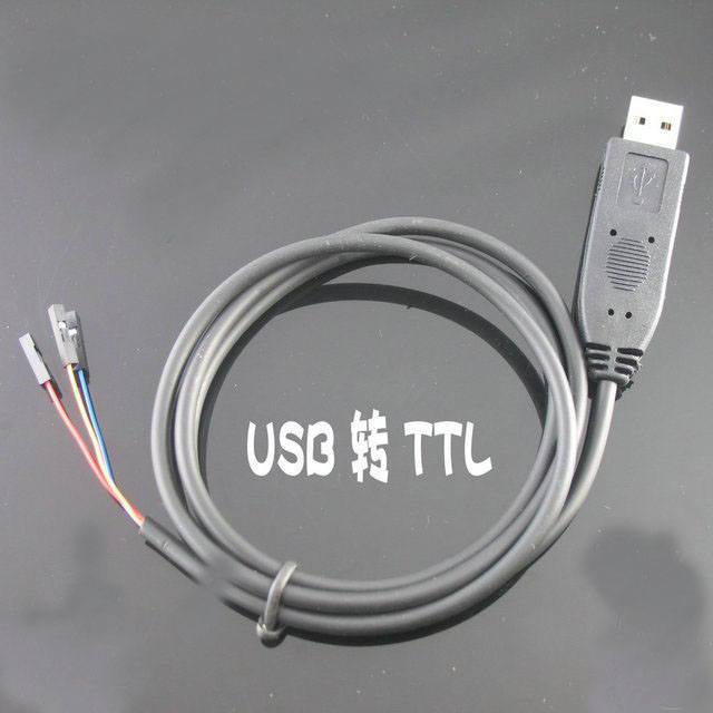

my TTL to RS-232 converter showed up today. I followed the satpimps guide to recovering the box and it worked :) the other one should work also. so just to clarify the AZ uses TTL signal levels NOT rs-232 as stated by some. i got my TTL to RS-232 converter from here:
hxxp://www.rs232-converters.com/rs232-to_ttl3.3_converters.htm i chose the 3.3V model cause that was one of the voltages i measured on the AZ connector. you might be able to find some cheaper so....
also another member messaged me saying he was also able to recover his AZ so it IS possible.
Great news. I ordered one on Ebay last week just for the peace of mind that should crap hit the fan I'd be able to recover.
1_189.jpg My cable arrived today. Hope I never need to use it but just in case !@#$ hits the fan I'll be ready.
