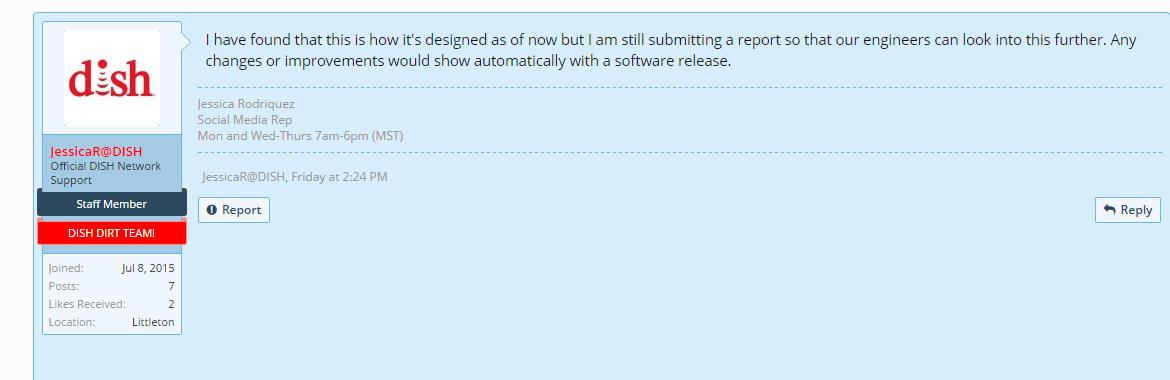

When I reported it, this is what I got back.
You're right. I just tried also and it worked great. Still no luck on Bates Motel for me either. I wonder if it's just shows with absolutely no current playings or VOD options that won't work.
