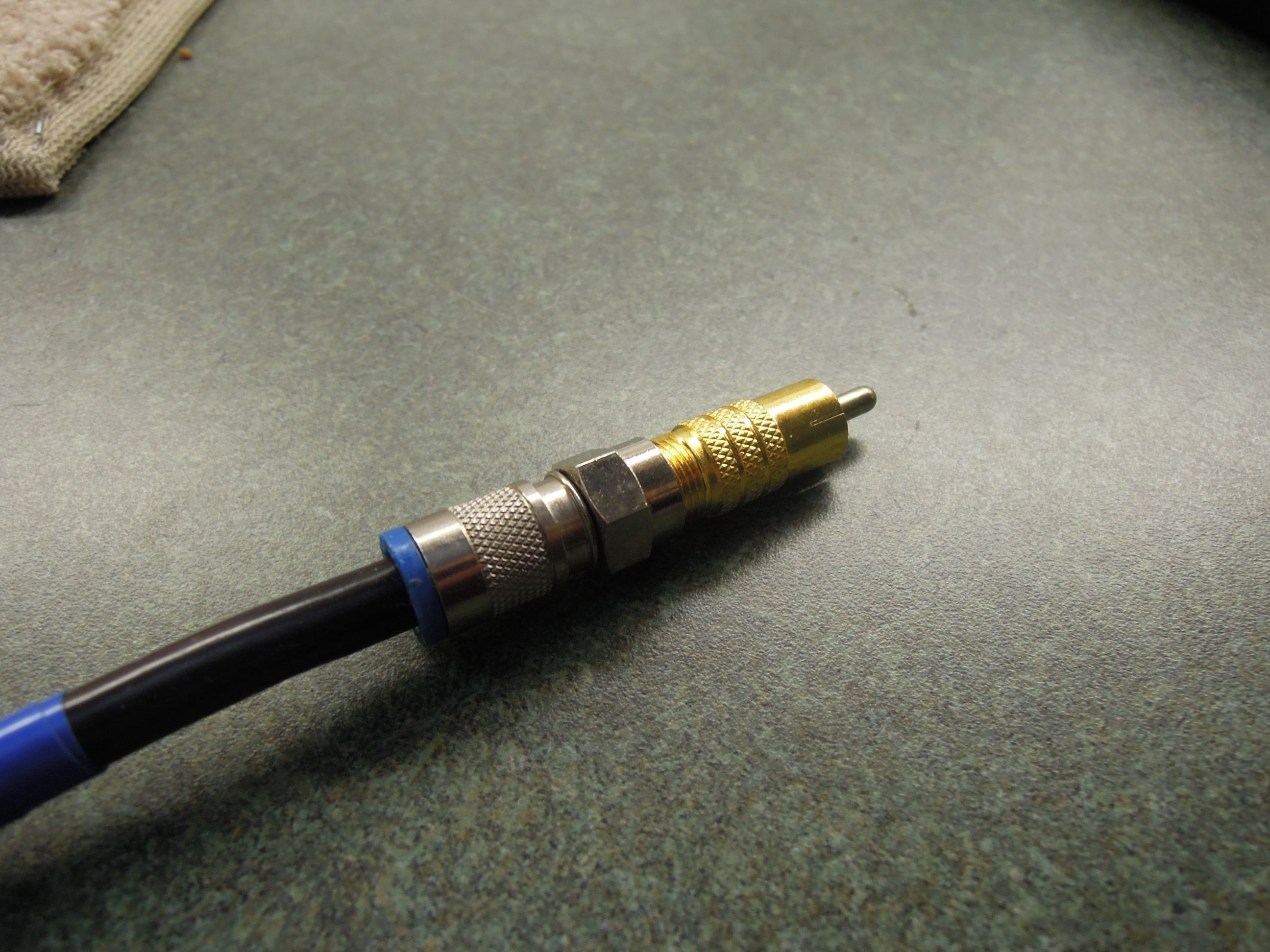

I generally leave the stb in the house. I just tune it to the tp I want, and then feed the signal out to the dish farm over a spare coax, with RCA adaptor ends. I have a 6" CRT that works fine out at the dish. I also use the same coax adaptors for long component cable runs. Works fine, and RG-6 is cheap ! :)
