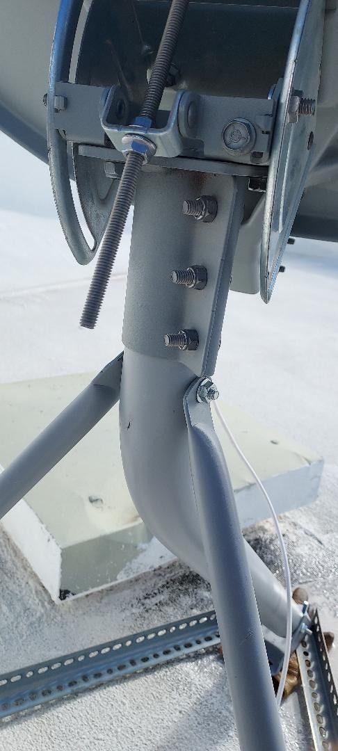

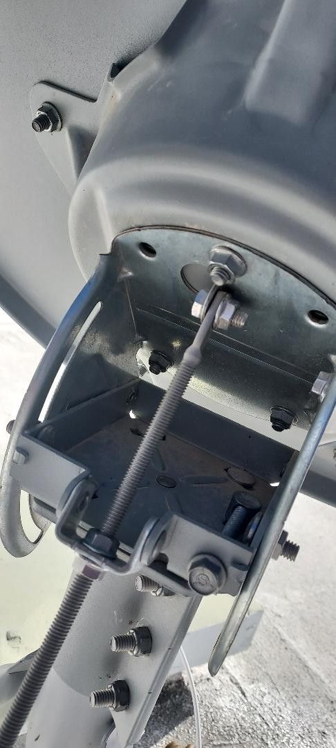

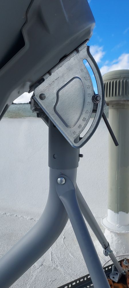

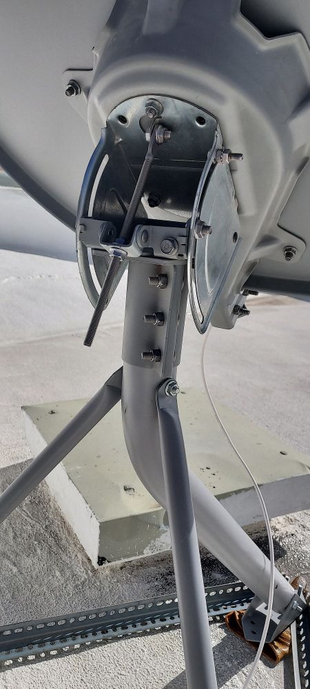

I took some pictures of the back of my dish. Is this standard for a motor to work?

In my opinion, not a good candidate for mounting on a motor. The theaded elevation adjustment will likely be in the way and need to be removed. Also, quite a bit of unnecessary bulk and the balance point moved far forward from the mount. Adds considerable strain to the motor.

Maybe it would with with a Stab 120 if one could be found? Don't they mount the dish above the motor rather than below it?
I would just spend the $99 to get a 90cm GeoSat Pro dish. It pairs well with a motor. Keep the Hughes dish parked as a separate, 2nd dish.
You ripped the thought from my head. Though I'm the first to use what I have, this is way too much consideration and work for the little expense required to get a shiny new dish that will work better in the end anyway.
