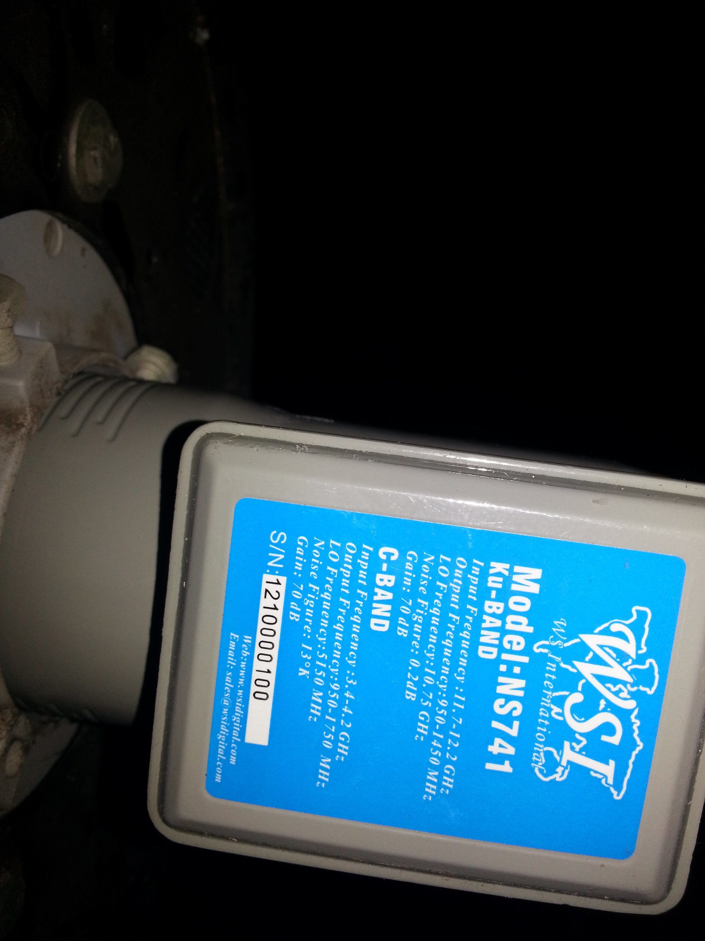

Now with the four supporting legs attached to the WSI C/Ku LNBF (part # 741) do I simply slide the LNB between the markings for "36" and the line (going lower & closer) next to it ...?

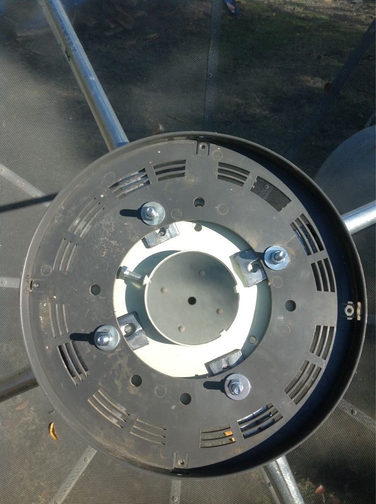

I'm not sure if my question is conveying what I'm curious about, so I'll try it another way: Two different mfr dishes may have the same diam. and the same dish depth; so in my mind they SHOULD have the same focal point, but if I swap out the OEM scalar ring and LNBF to a replacement WSI 741 (and scalar ring) and bolt it onto the old dish's four support braces... how did the LNBF mfr know that the markings on his product match my calculated focal point of 35.84 inches ???
second quandary: Is the focal point supposed to converge right at the LNBF's front weather cap, or inside a inch or two past the cap and 20140305_190301[1].jpg down the LNBF tube ?

Maybe, but only if the F/D ratio is the same.
F(35.84) / D(90) = 0.3982 F/D=.4 Set scalar on feed throat so .4 mark aligns with the backside of the scalar. Mount scalar to legs so front edge of feed throat is ~1/8-1/4 inch short of 35.84. (35.5??)
Fine tune feed performance by sliding the feed in/out of scalar. Should only be slight.
Dual band LNBF's require diligent fine tuning. You also may see one band peaks here, and the other -there. There's a 'trade off' in performance to accommodate both bands.

Make sure the feed is centered. Measure 3 points around the dish, scalar edge to dish edge.
Also ensure the feed is aimed at the bottom center of the dish.
These two areas can really effect perforance
That's why those slotted strut ends are so important. This adjustment is the one that took so long on one of my 7.5ft dishes. Getting the distances equal so the scalar was parallel to the dish. Then tweaking the LNBF for what seemed forever...

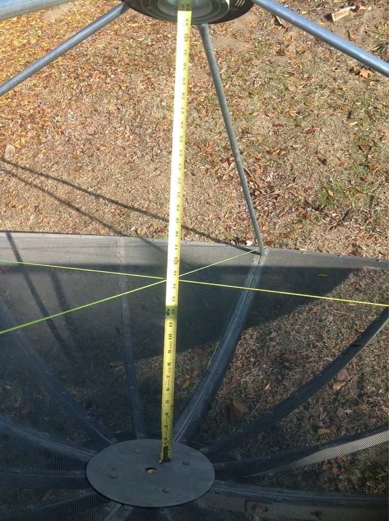

do you by any chance remember the measurement from the bottom of the dish "bowl" to the LBNF's weather cap after your final peak ?? basically the photo above, but AFTER the LNBF is in place....?

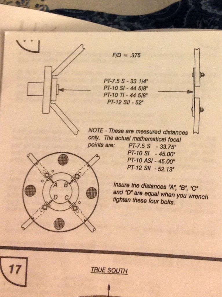

No, and I cannot measure it now because its up too high, but the PEFECT 10 manual on this website has exact measurements for the 7.5 ft mesh to be 33 1/4" from the flat base plate in the center of the dish to the LNBF.
I was told by members here to follow the manual exactly when installing my 10 ft and I did and it is perfect.
