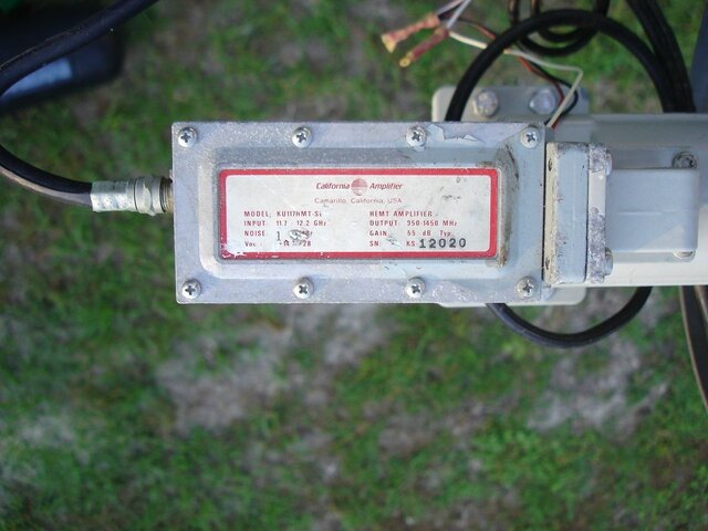

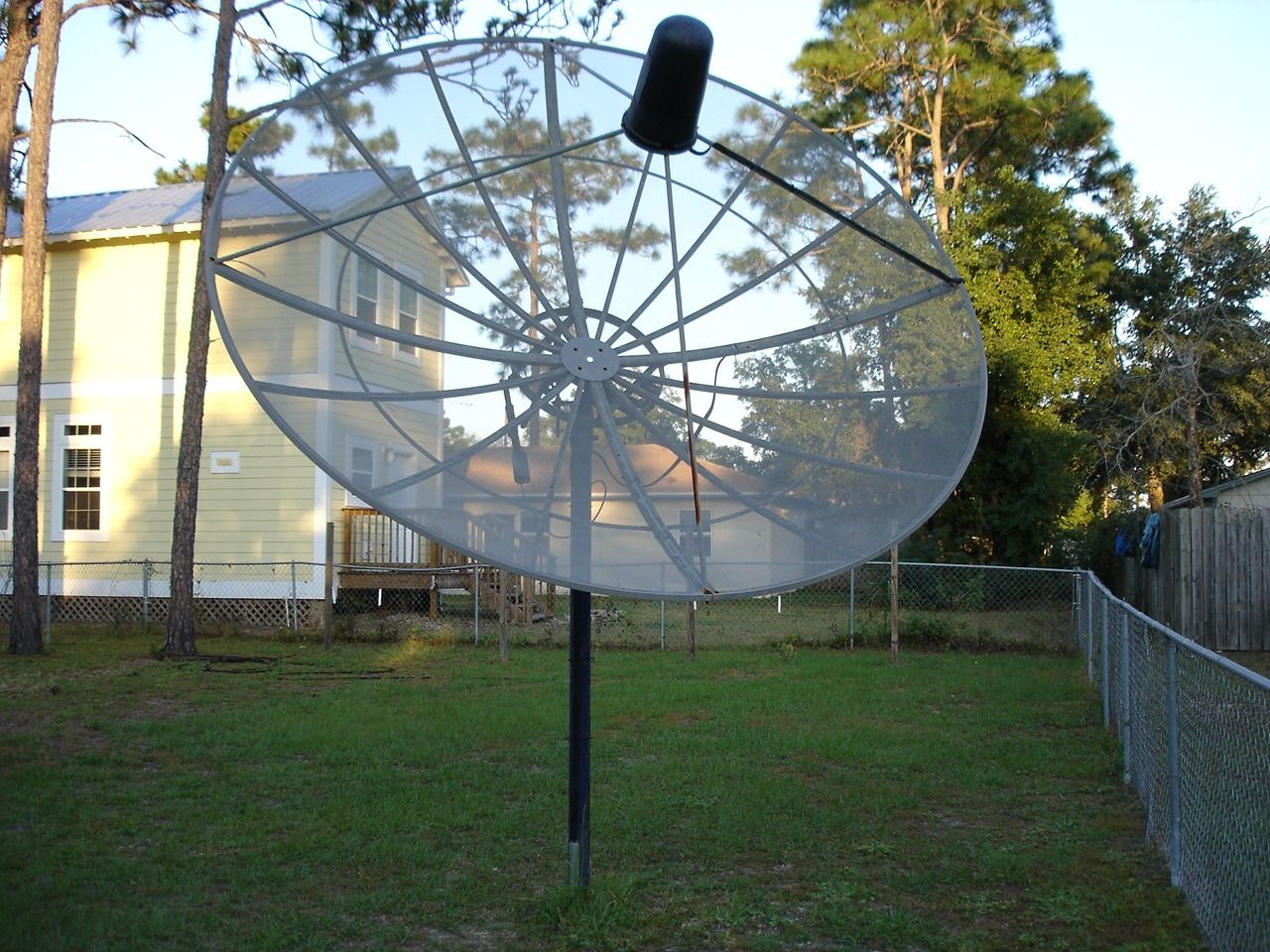

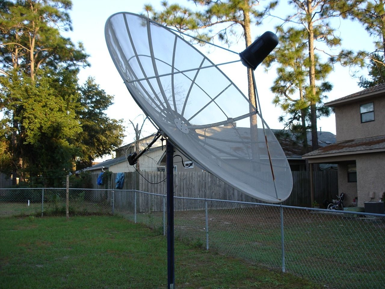

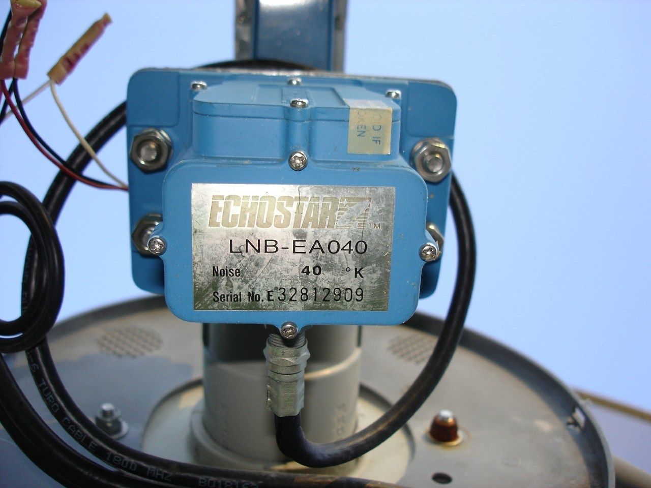

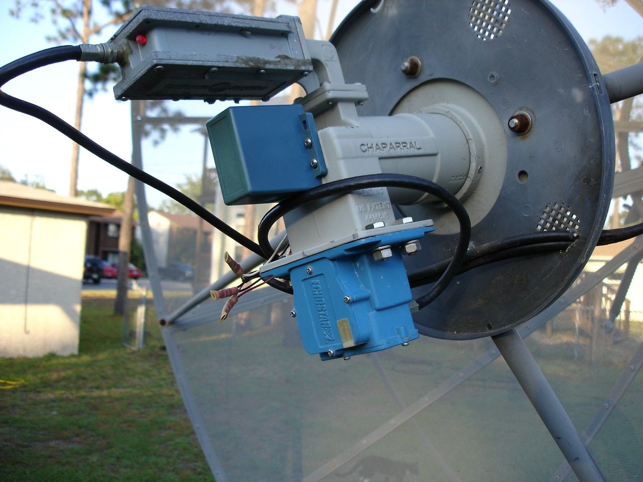

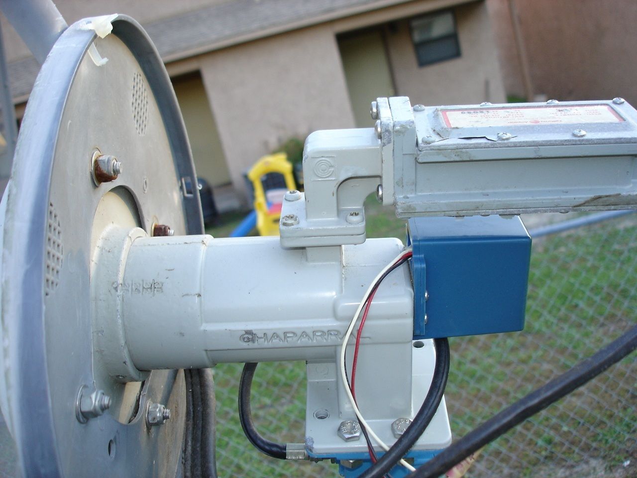

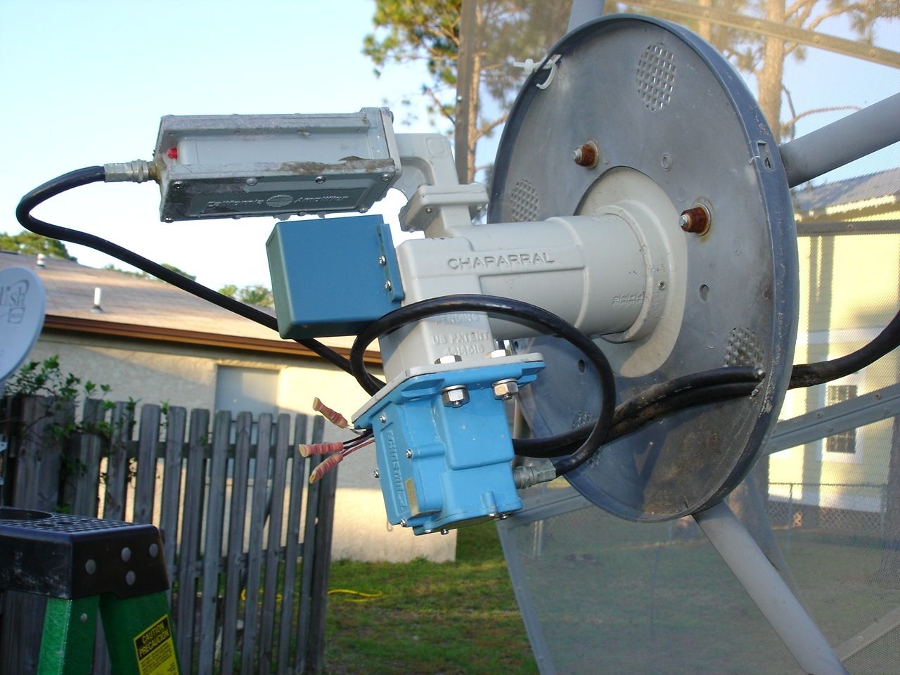

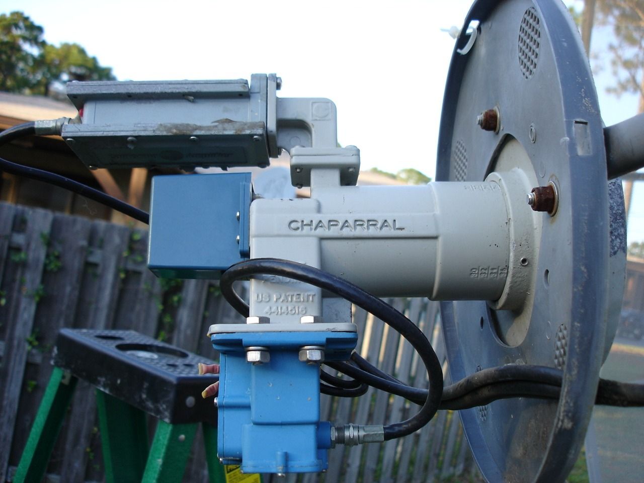

OK here are some pictures Finally stop raining. I hooked up the 4DTV rec.and got just a few C band. I could identify about 7 different satellites with maybe 1 or 2 channels. I could never get the receiver to go to Ku I guess, looked the same as my old one channels 1-24
G5 had most with scrambled channels also.

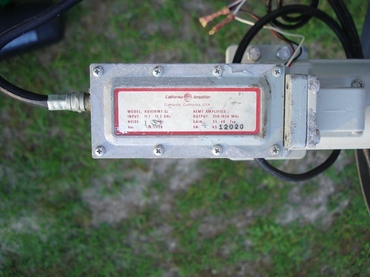

I have set that setting every way and no change. Can the lnb go bad? It has a light on it notice one of the pictures.
If the light isnt coming on, it prob has died on ya. I have an older cband lnb that lights up like that. California amp I think. KU lnbs seem to not last as long for me, never got more than 2yrs out of one.
