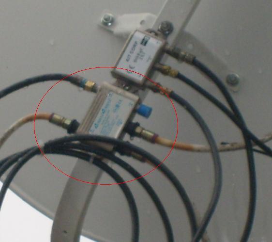

I am using a Chieta switch as well. 3 years now and not one problem, it is under the dish in the elements as well. Now each port has something on it but it has never let me down!
They are made really strong, sealed well and heavy little suckers.
I know some of the big STB box manufactures use Chieta switches with their logo on them. I have one that says CNX on it. The one I am using since my setup has no company logo on it.

I have a brand new Chieta spare that came with my CNX box when if ever the one I am using now goes bad! Well, it's about a year new since I got the CNX box. Has never been used yet.
Good switch in my book and agree with the other guys here about them! :)
K E V I N
