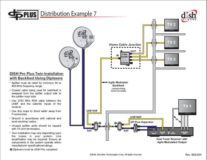

ok, i think i see whats going on.
charter merely used existing cable to hook you up. personally i dont have a problem with that. its good that they didnt cut your dish cables.
im thinking that 2 cables that are on the splitter on the right are the ones we are interested in. 1 probably runs to where your reciver was, and the other runs to where TV2 was. disconnect BOTH of these from that splitter. fiqure out which one goes to the receiver (the tongue trick works, with the 625 powered on and the coax connected to the seperator). that one goes to that ground block hanging to the right of your cable box. shouldnt matter which side. you should now get sat signal on your 625.
do you have a diplexor behind your 625?
to get tv2 going, you will need another one. and a sort piece of RG6 jumper cable to hook it up at the ground block
This is basically what you want it to look like when you are done... good luck, and yes... the tongue test works well, or a multimeter if you have one :)
