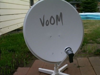

The answer, a 30" dish and a black marker........
