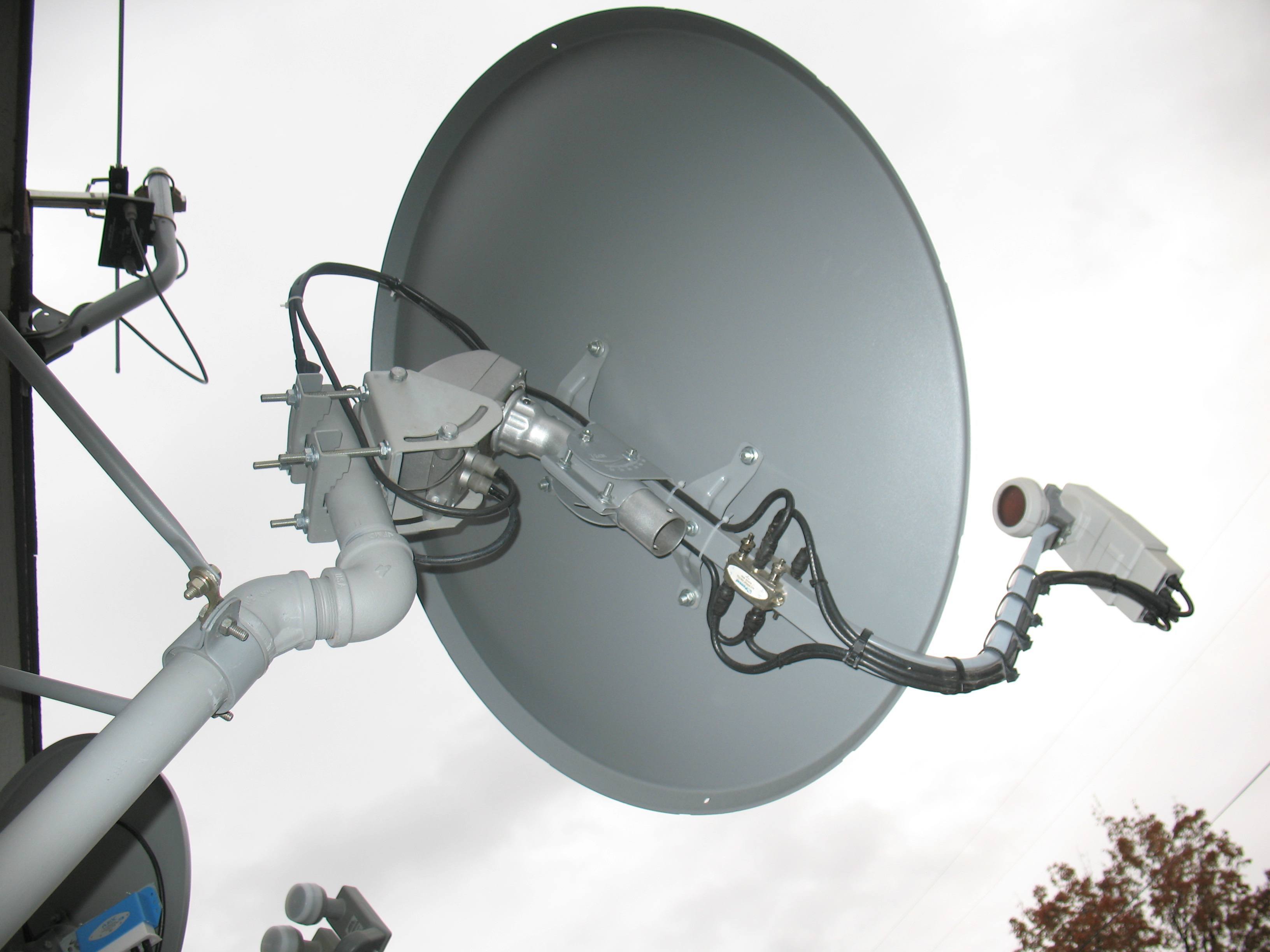

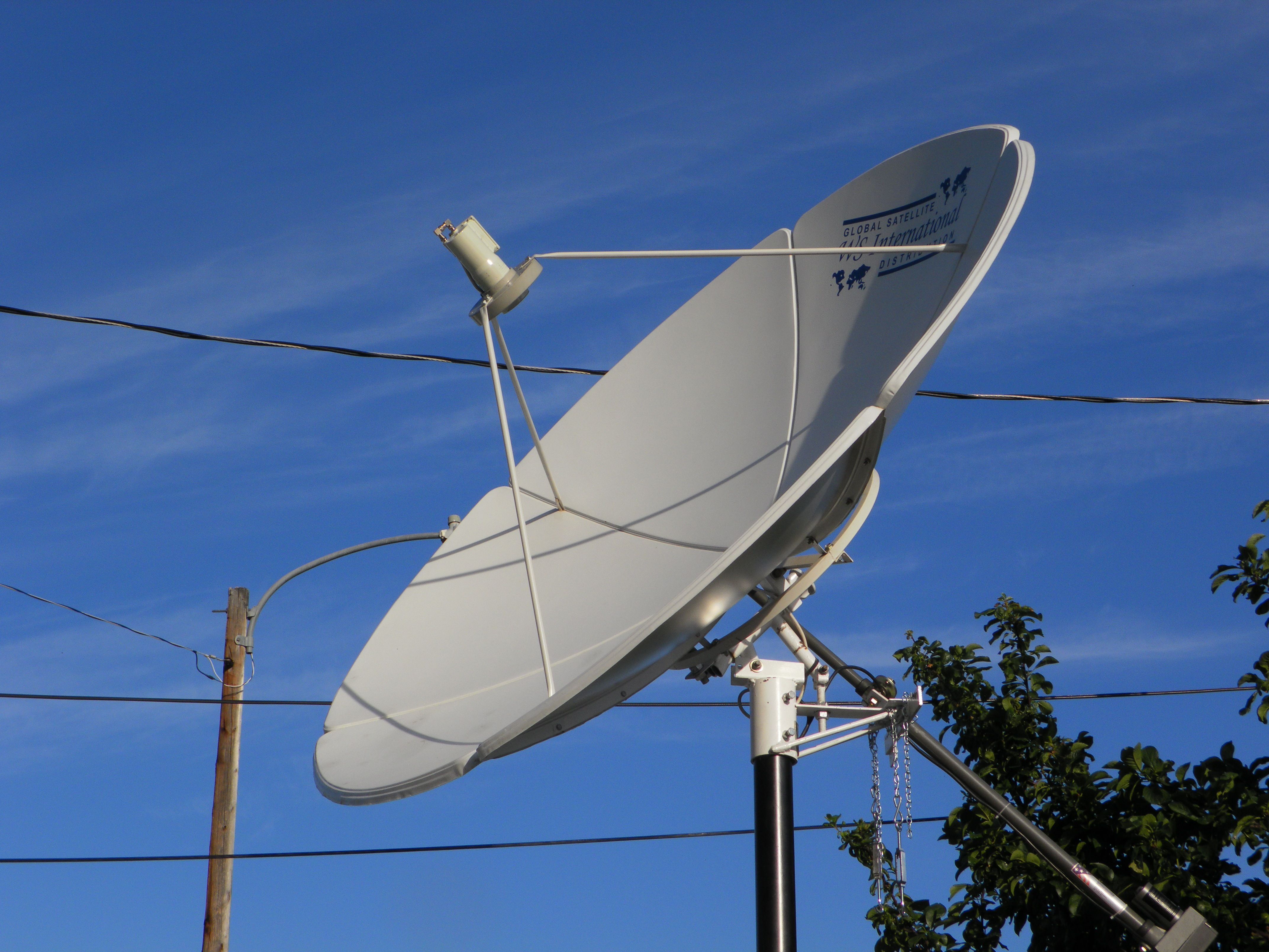

I have a similar dish arrangement on one receiver. I go from the receiver to an 1x8 DiSEqC 1.1(uncommitted switch), then from that switch to the VBox and out to the Bargain Dish for C-Band. Also from the 1x8 switch to the SG2100 than to a 1x4 switch and 2 connections to the QPH-031. Dump the C/Ku LNBF on the bargain dish and go for a C only, ie. GeoSatPro 2.

Thanks Magic Static
Planted the pole, but it looks like there will be some obstruction to the South by the "Bargain" dish. It has been raining a little and the backyard is mushy, will have to wait untill the ground gets drier.
Will research the GeoSatPro 2. As mentioned I am not too happy with the present setup.

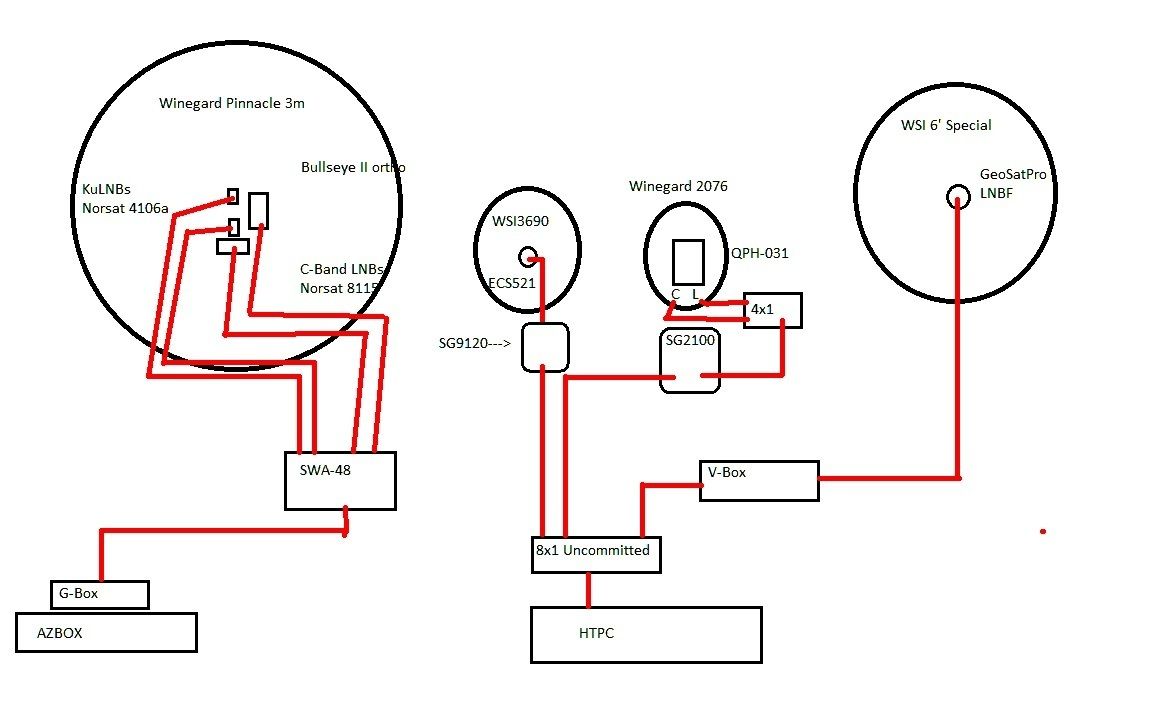

Magic Static it would be nice to see your wiring diagram. :)
I used to keep one made up to keep track of all the stuff I had going on. But I've gone more motors and less LNBs so it's fairly simplified lately.
I threw together a quick diagram of todays setup.
