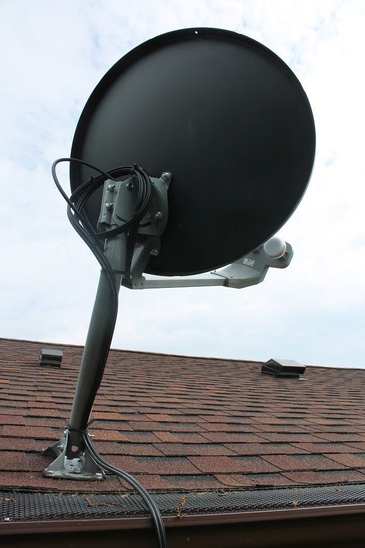

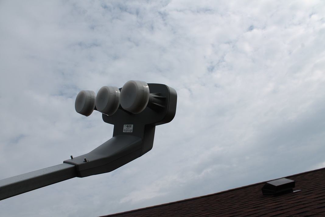

Currently I have a Dish network dish (which is no longer active) mounted on my roof (about 2 or 3 years old). I assume I would be able to tap in to the existing cable runs going up there or would I need to do all new ones? Also, would I be able to take advantage of the pole to mount the FTA dish to it?

Roof mounting is not recommended. But you may try one much later, once 'experience' is gained.

Roof mounting is not recommended for a fta dish as it will be much more difficult to tune and adjust, but there is no reason you couldn't make use of existing cabling if it is rerouted to the new dish location.

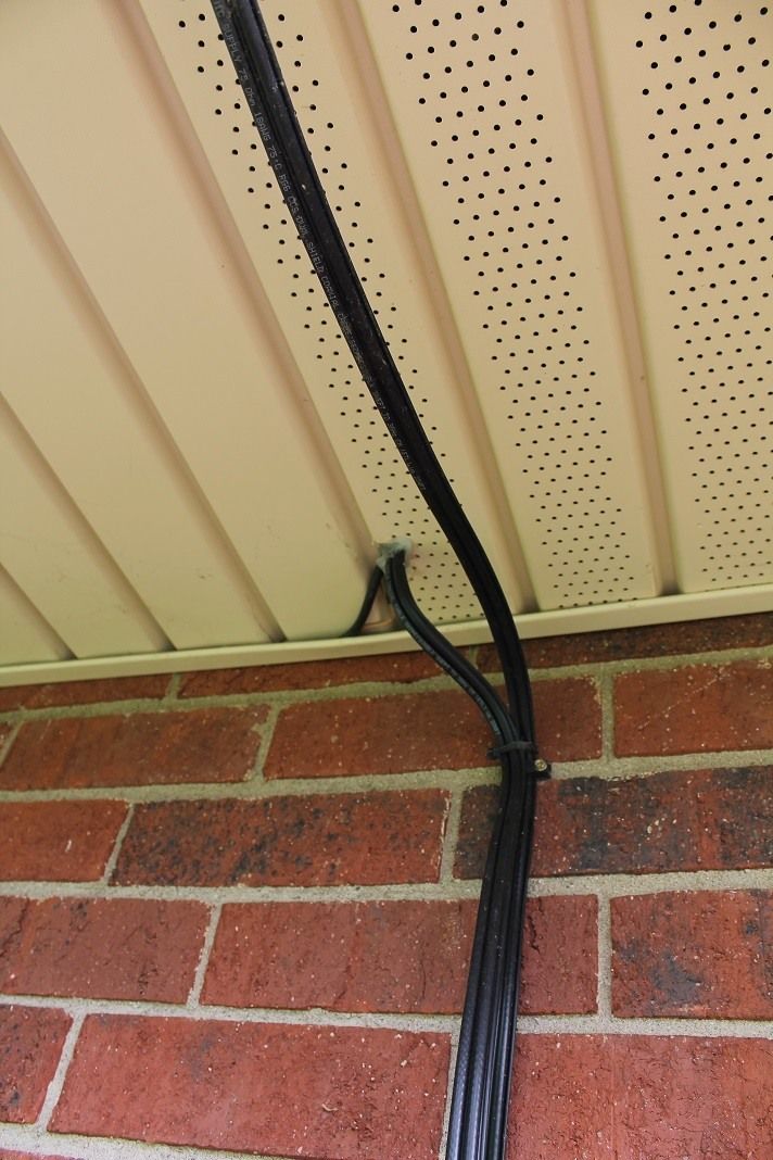

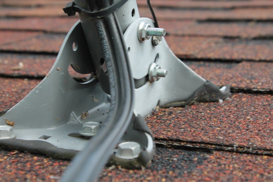

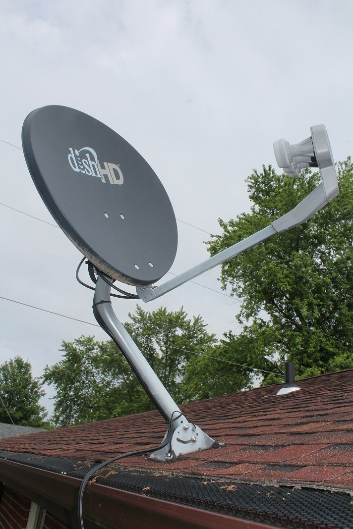

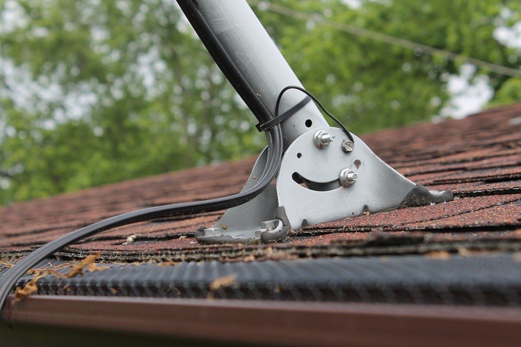

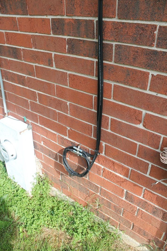

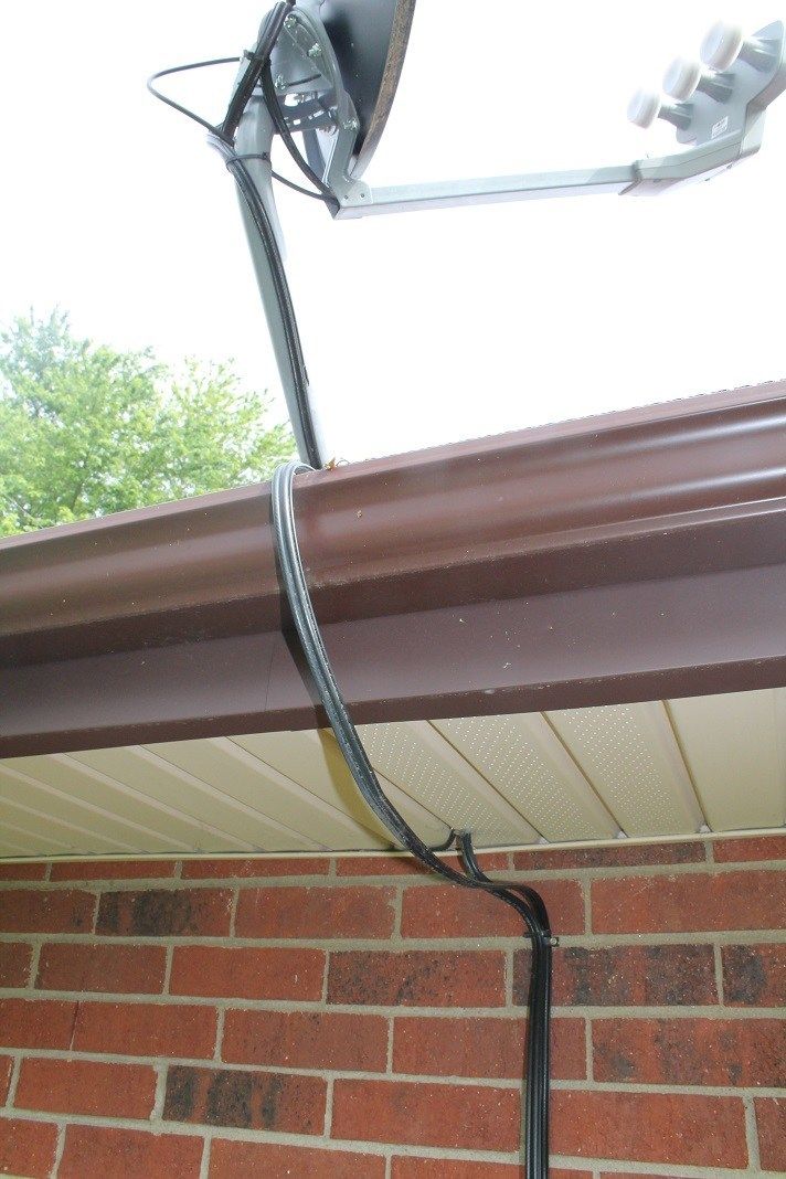

Also, as far as the installation of the dish is concerned, the reason I had thought about the rooftop is because that is where my old Dish antenna is. The cable is coming out of soffit an run up to the roof, where the dish is mounted. I have attached pictures of how it is set up. My question is, would it be possible to keep the mount and remove the Dish network dish and LNBF (by the way, what type of LNBF is that, a triple?) and replace the antenna with the 36" Geosatpro with a dual LNBF and a motor? Or is that not possible because of the size difference of the dishes and weight capacity etc. Also, is the Dish network dish even looking at the same sky as a FTA dish would be? And also, in the last picture, what is that material called that is in between where the dish is screwed into the shingles? My assumption is that it is to protect the shingles from the metal?

Sounds like your doing ok! I was in the same boat that your in now about 4 yrs ago.I started out with a motorized ku package deal from Sadoun and did mount mine on my garage roof! see Pic.If your doing this alone be prepared for frequent trips to the roof until dish and motor are correctly aligned :(..When you get that first satellite station it will seem well worth it!i know it was for me :clapping.I got hooked quick and shortly expanded to a 6ft cband motorized system for my back deck !Im one of those who couldn't go with a larger dish without breaking the peace;). Dont let those who say you should have a 10 footer or bigger scare you off! With a 6 footer you will get plenty of c band stations.DO your homework on FTA system setups and what you don't understand a great crowd here will be most happy to help.
Reactions: 77TA
Welcome to forum Johnny, the grey stuff is just silicone sealant to prevent leaks. Lag bolts screw-gunned right into your roof decking, exact reason I don't want any dishes on the roof. Well, not having to climb up there to tweak the dish is another big reason too!
