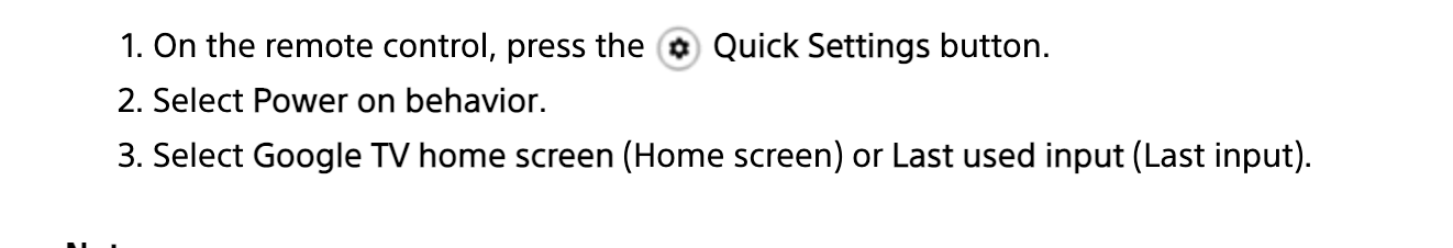

The issue is has nothing to do with the dish equipment or inputs. As Tsunami has pointed out it is a setting on the Sony TV itself. You must go into the Sony settings and change your startup from Home Screen to Last Used Input and you issue will be resolved. You do this with your Sony remote:
The dish remote works fine changing channels, volume etc. It is just when first turning it on, it goes to TV first instead of Dish
You have to go into the TV settings and find where you can select if it wants to go to the home screen or to one of the HDMI inputs when you power up and set it accordingly.
