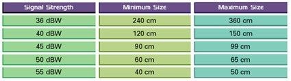

3/ Have a look at the below table, then have a look at the satellites footprint, compare the EIRP to give you the correct size of dish needed.
