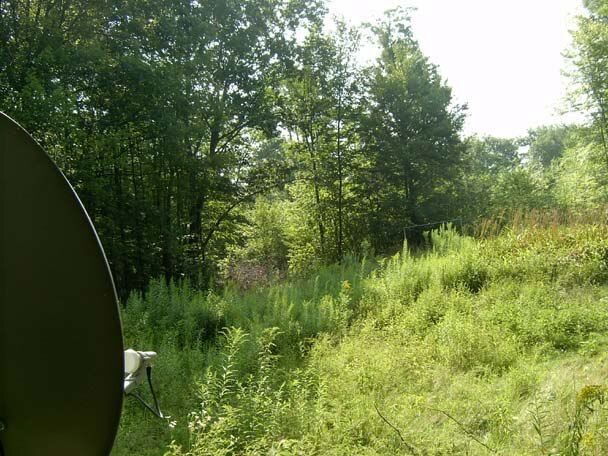

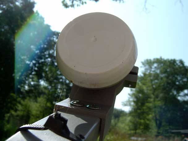

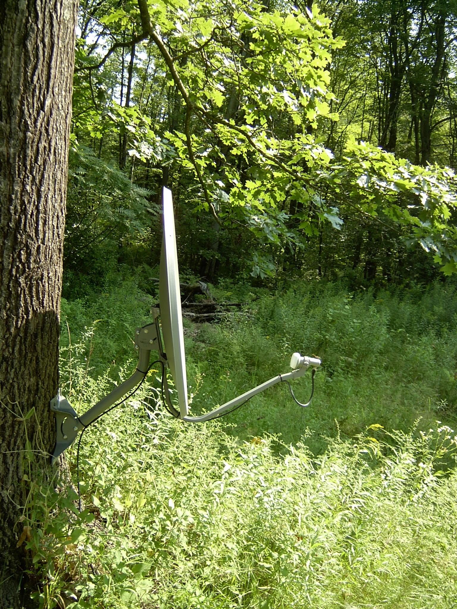

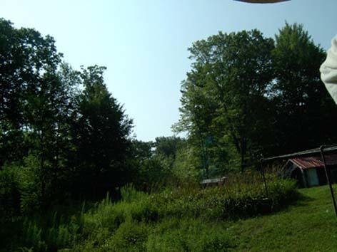

The skyway uses a universal lnb single I am sorry the detail is lost in the re sizing due to being on dial up for the while.
The later pics are camera flat back on center of dish the lnb shot is not right on it but you can establish the point from the later pic I hope.

:eek: a tree mount are you kidding!? get it off the tree!!!!! mount on a pole!!! theres all kinds of reasons the tree moves grows tilts tord the sun that changes with summer temp the tree may actually push the bolts out. o my god! i cannot believe it! as far as the site if you were in the south with a higher look angle i would say your in good shape but being so far north I'm not use to the low look angle. looks like it would get you by. i forgot this is for internet? looks like fta. what sat are you trying to get? i can see a branch just above in the lbn pic#1 get that out of the way. and the pole mount up about 6ft will help your only a couple ft right now. i need more info to help any more than that mainly what sat/ how long is the cable run/ its for tv not internet/what signal strength are you getting on which transponder or channels are you having a problem with/ a zip code from your area????? thanks! then i think well have a better idea of how to help you.
This is for internet hobo and worked on the edge for quite some time. Installers put it there in march or so and Ive had connection issues only now and then. The branch in the pic is actually a bunch of trees that do not seem to be in the sight line but the pic indicates it as far as Sig Quality;
It is rated on a greeen to yellow to red bar signal and is pointed at pas1r sat, like I said it was fine yet in the yellow quite often, I regularly had 200 to as high as 772 up till last week. I am unclear about how all of a sudden the tree growth could obstruct. Leaves have been full grown here since july 1 probably anyway. The run is 100 ft and Ive tried a new adjunctive coax line to test with no luck.
Skyway is really screwy lost in space and always under acheiving as far as anything they are supposed to know. They often seem evasive and secretive when I ask what is wrong.
I will likley go with another company soon unless this problem resolves; poof for real.
the branch i see is in pic#1 at the very top edge above the lbn. i still say get a pole mount. the 100ft run should be ok. with trees it doesn't take much even the wind blowing one light branch just right can cut you off completely. weather has been very hot all over. the tree could be even a !/4" shift. if this is a proper install to them then i say run from them i highly recommend hughesnet. keep in mind sat internet will almost always suffer some loss i feel its normally 20-25% of advertised speeds. the sat your on is very low in the sky for you. by mounting on a high pole you will get a better look angle at the sat. but the end result for me is the original install is well absolutely unacceptable. the dish has shifted seance then and the trees have filled in with new growth. corrections to be taken; pole mount as high as possible/ trim trees where possible/mount as close to the modem as possible. good luck! your going to need it!
