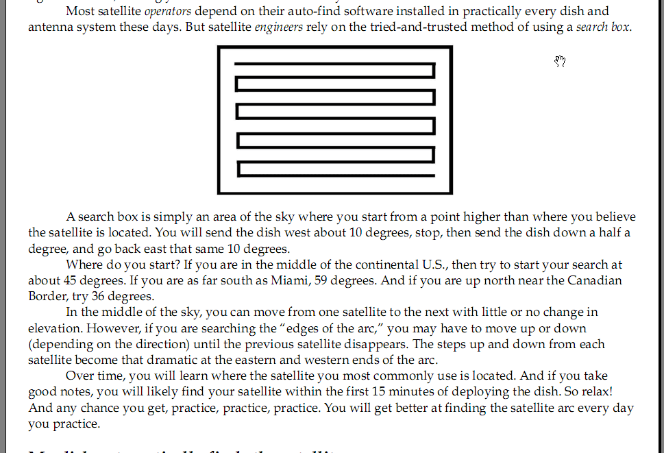

1. With a known good strong transponder set on the receiver.
2. And while being able to see the Signal Strength and Signal Quality while aiming,
3. Start low and raise the dish where the LNBF goes up about a quarter of an inch at a time.
When you get close to the Clarke Belt, the Signal Strength will go up. As you keep aiming farther up, the strength will go back down. I don't know about your receiver. But the increase might be small (2-5 points, but it should be measurable) Don't worry about the quality yet.
Move the dish a little high and temporarily fix the elevation. Use that as a starting point.
Then, I would try the attached search box method.
Make small incremental movements and at some point, the quality will jump. Once you are close, make smaller adjustments.
When you get frustrated, my Macintosh buddy said what works for him is a Coke and a Smoke. That means when he gets frustrated, he takes a break. After he has a Coke and a Smoke, his perspective has changed and he's not so frustrated. With a fresh look on things and a chance to think about the situation, he will have a better outlook to solve the problem.
I don't smoke and I don't drink Coke, but it works for me too.
PS. Some people have success right away. For an hour at a time with lots of breaks in between, I had to try over for a week to aim my first Ku linear polarized satellite dish. (this was after setting up a Dish Network pizza dish, no problem) Now three years later, I have eight dishes approximately, in my back yard. :)
