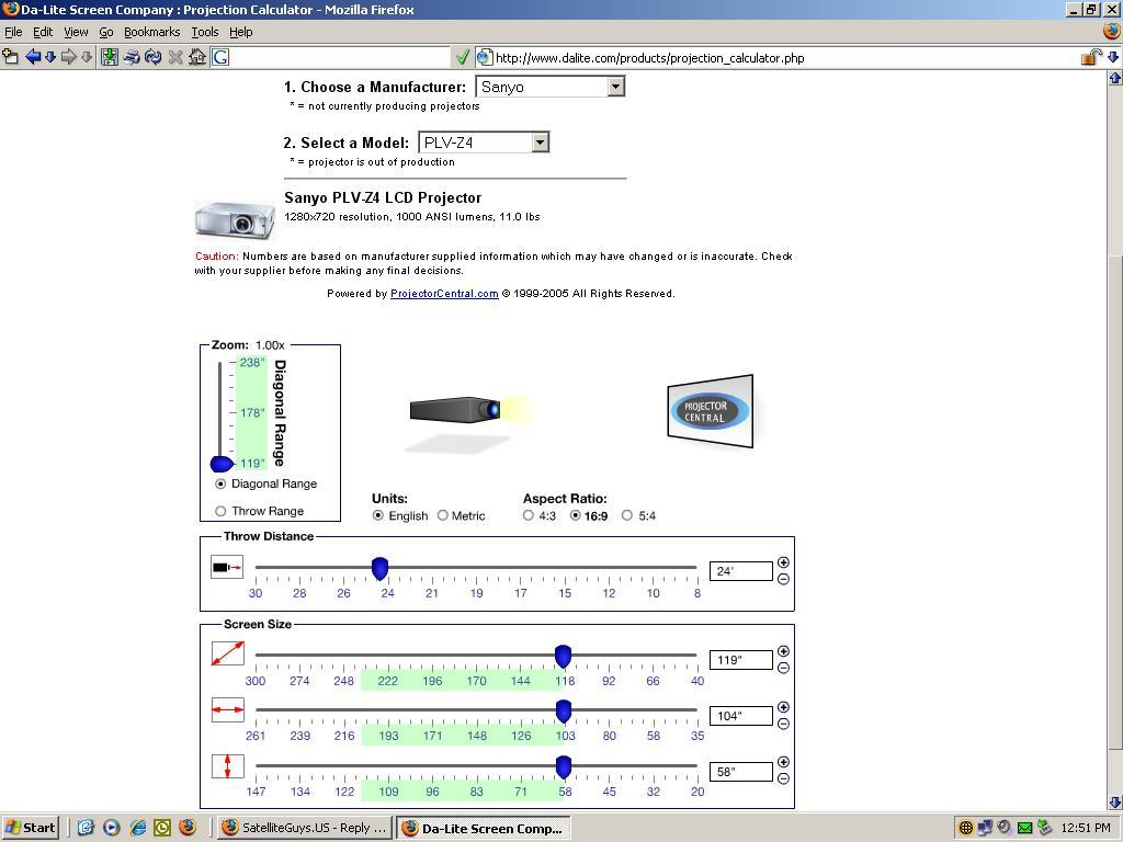

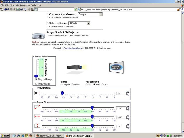

goto dalite and select your projector from the list and it has a screen calculator, i use the 119" 16x9 Model B deluxe in high contrast matte white
Is there a widescreen calculator to determine screen size?
I can get a 7'X7' roll up screen, but I want to keep the height in proportion to the width to get a 16X9 aspect ratio.
Yes, there is a ASPECT RATIO selection on the calculator right above the throw distance slider. If you are looking at a 84"x84" these would be a great 16x9 to look at: 45" x 80" (92"diag) or 52" x 92" (106" diag) they come in Matte White, High Contrast Matte White,
Video Spectra 1.5, Silver Matte amd High Power.
http://www.dalite.com/products/projection_calculator.php
I attached a copy of mine.
