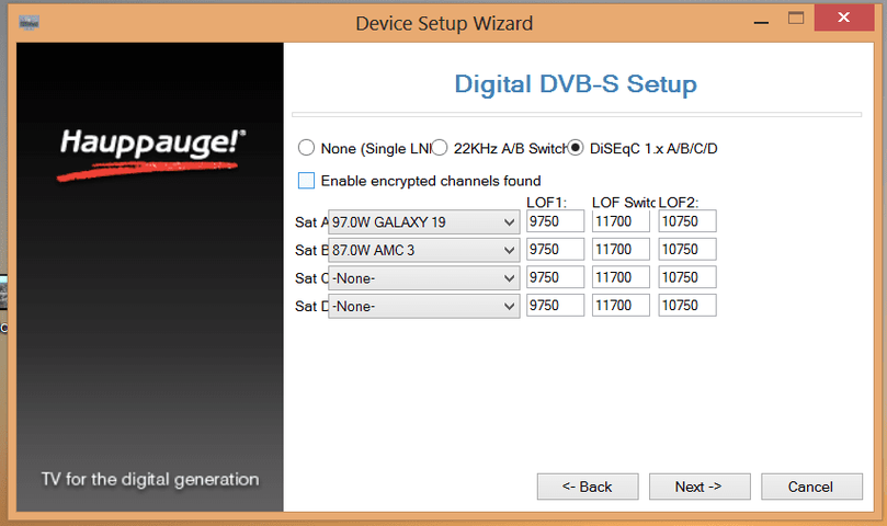

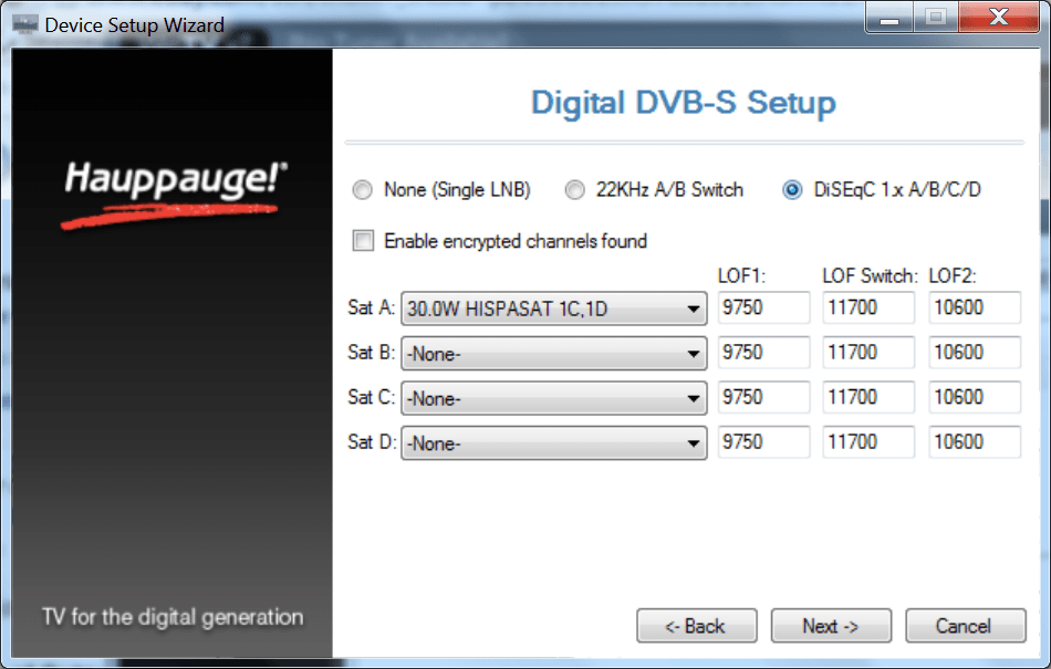

Seeing this reminded me that I have an unused WinTV Nova S2 sitting in my computer (waiting for LOS). Here's what my screen looks like if I choose a 4x1 switch:
I assume yours looks the same, using WinTV 7. The "None (Single LNB)" option shows the same, but only lists Sat A. Are you 100% sure the LO settings are the same as they were before?

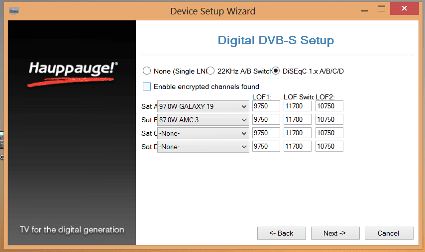

Thanks for the replies guys. I'm running WinTV version 7 (latest version from their website) and my setup screen looks just like yours kitty. Only difference is I have the LOF2 set to 10750 rather then the default of 10600. I'm assuming Sat A corresponds to LNB 1 and Sat B to LNB 2. Attached is a screenshot of my setup screen.
