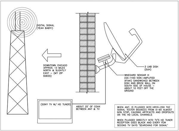

D* installed a new Wineguard Sensar antenna (the non-amplified model gs-1100 as far as i know) this last weekend. They installed the thing sandwiched between my house and the dish about 10 feet off the ground.
When I watch the hd channels they get really bad artifacts and lose sound off an on at irregular intervals. When i check the antenna signal throught the D* box the bars are jumping all over the place between 0 and 90+ and it sounds like a post modern orchestra. When I plug the ant. line into my hdtv tuner the image simply goes black every few moments.

I am including a drawing aid for all you visual people out there (not allowed to link yet, so please cut and paste (maybe if someone was nice enough they could post the image after this post))

Well, it looks like you installer didn't know what he was doing. From your diagram, the radio waves must go completely through your house to find the antenna.
Mount that puppy about 10-15 ft higher and point it NNE (17degrees) and your reception should improve enormously.
Essentially your house is blocking the signal to the antenna. If your house is brick, that is an even poorer medium for UHF penetration.
