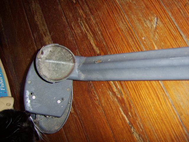

I keep an eye on my local freecycle adds and someone was giving away a 1M X 0.7 M P* dish with the LNBF pictured below with two outputs. This dish is OK but is missing the mount on the back so I have to rig something up to play with it.
Anyone have one of these LNBFs? Any better than the beer can ones?
Thanks

I have 4 of those for the AMC 1, G4, IA 6 and G10 dishes. AMC1 I've had for about 5 years now. I like these better because you have seperate cables for horizontal and vertical. You can put a wire on a analog receiver w/o having a digital receiver "stuck" on vertical feeding to it. These new .3 invacom and .4 lnbf's, etc are nice for digital switching, but for analog you have a great lnb. I'm told these Primestar ones are .7 degrees. I don't have a back part on the lnb on G4 and it seems to work okay. Your dish looks rusty. I'd be worried about that.
Thanks for the info Mike1. I removed the arm from the dish so it would fit in the car. The arm is sitting on floor with my cat next to it.

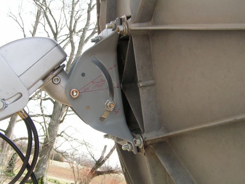

Ken, here's the mount I made for a Primestar dish with a sg2100 motor.
