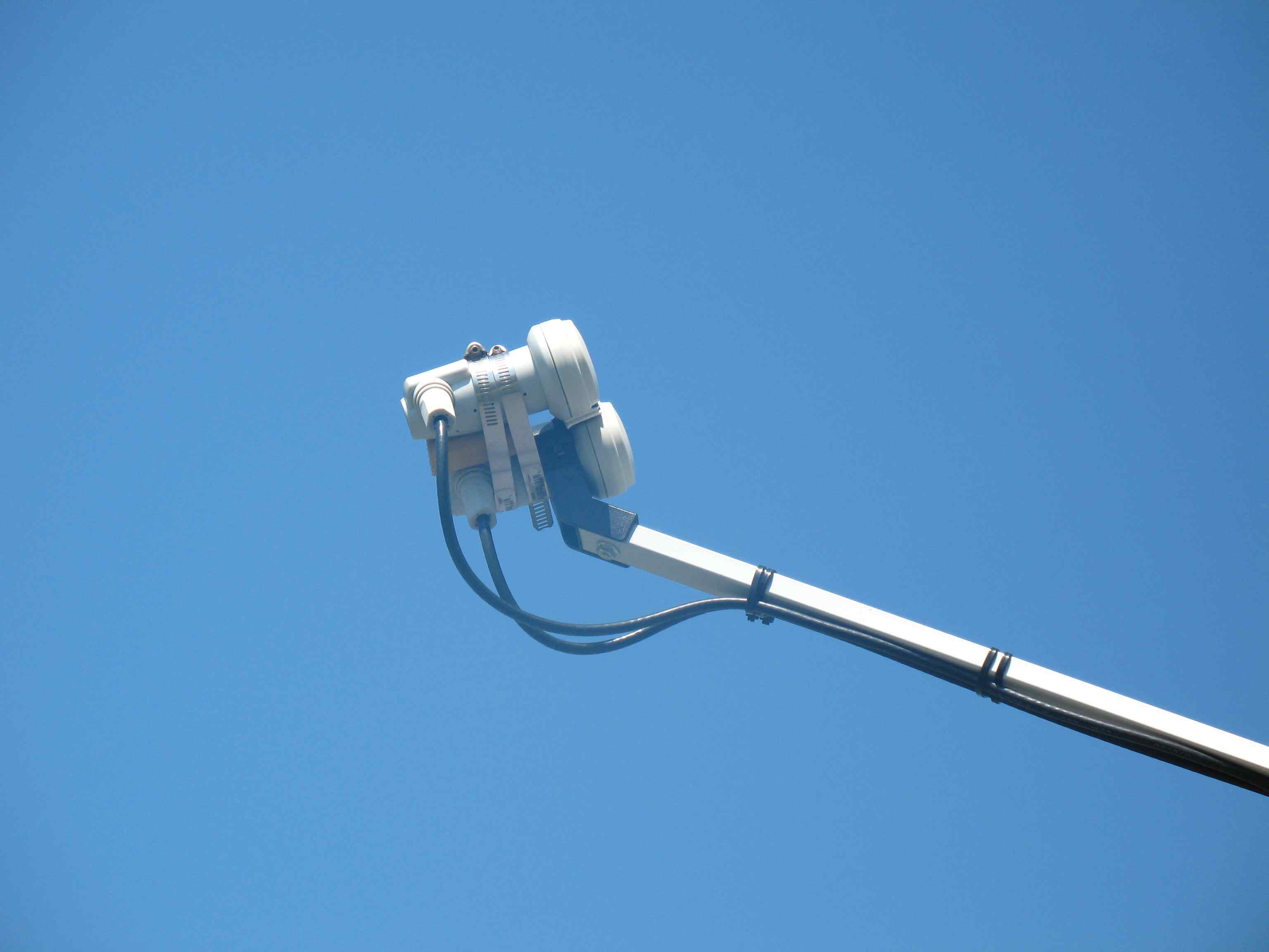

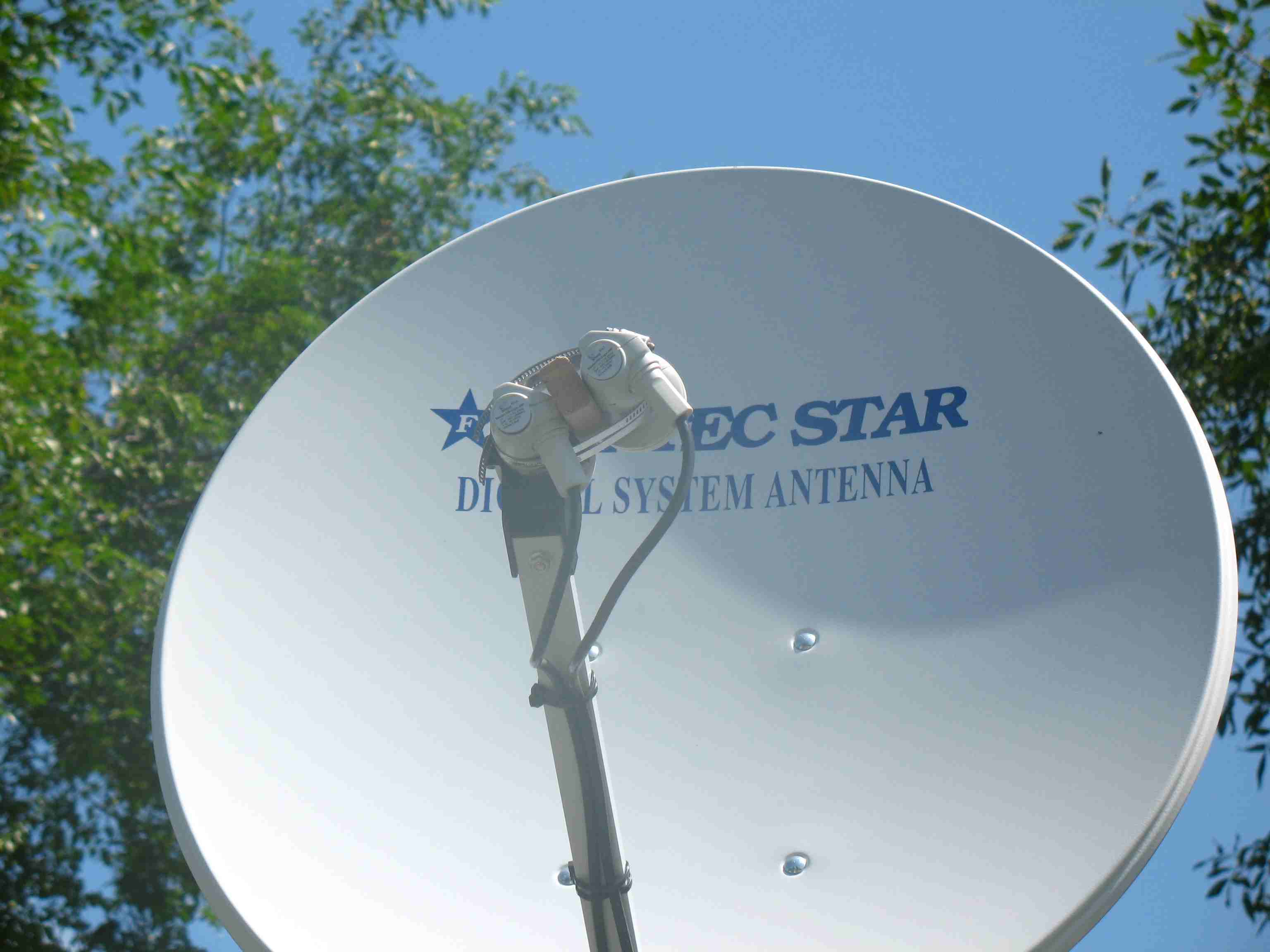

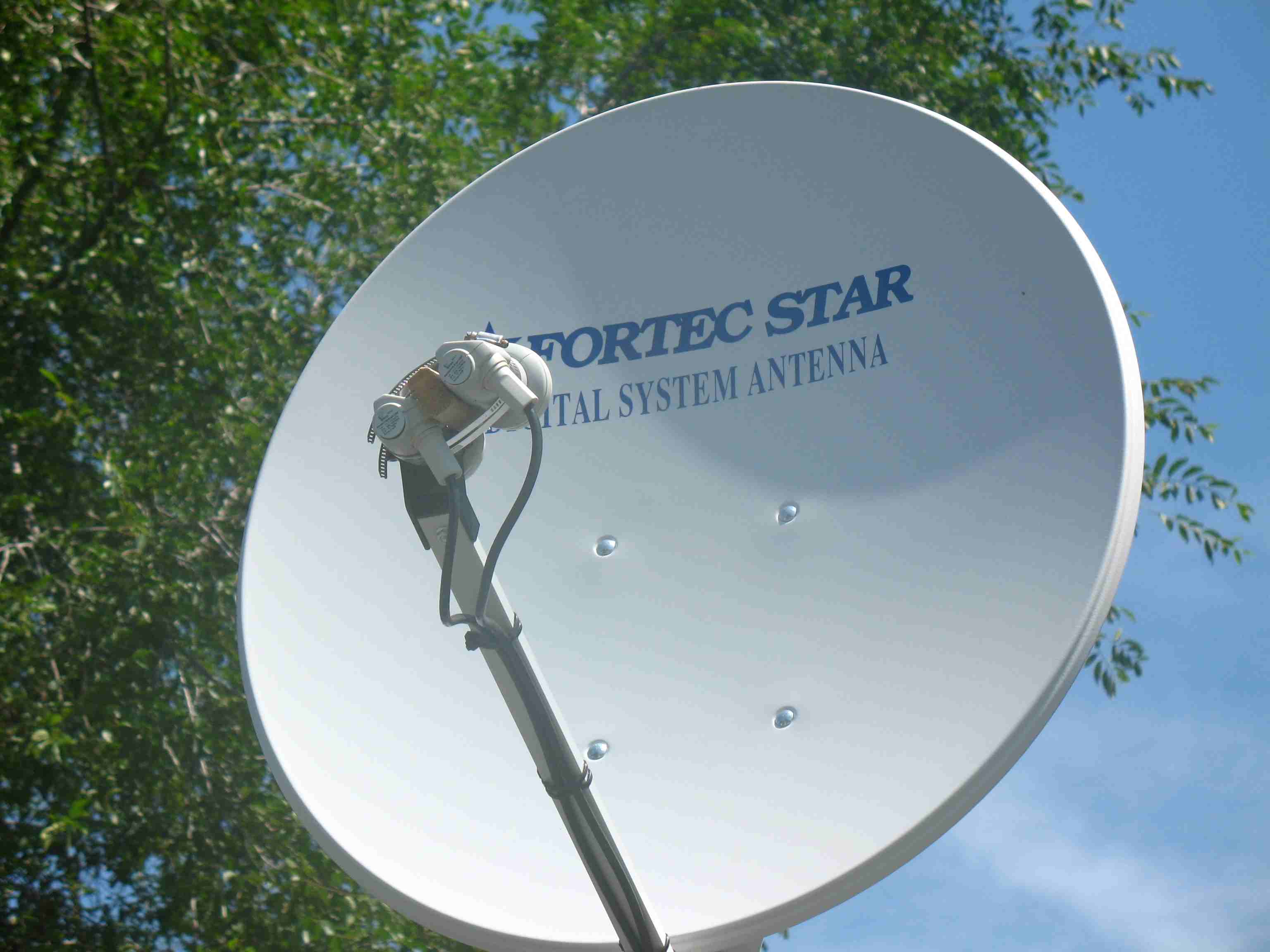

Here are some pics of my G10/IA7 setup. I am using a Fortec 80cm dish and 2 Sadoun KUL1 lnbfs.

iafirebuff said:
As you face the dish, the one on the left is for G10 (the one in the lnb holder), and the one to the right is the IA7.

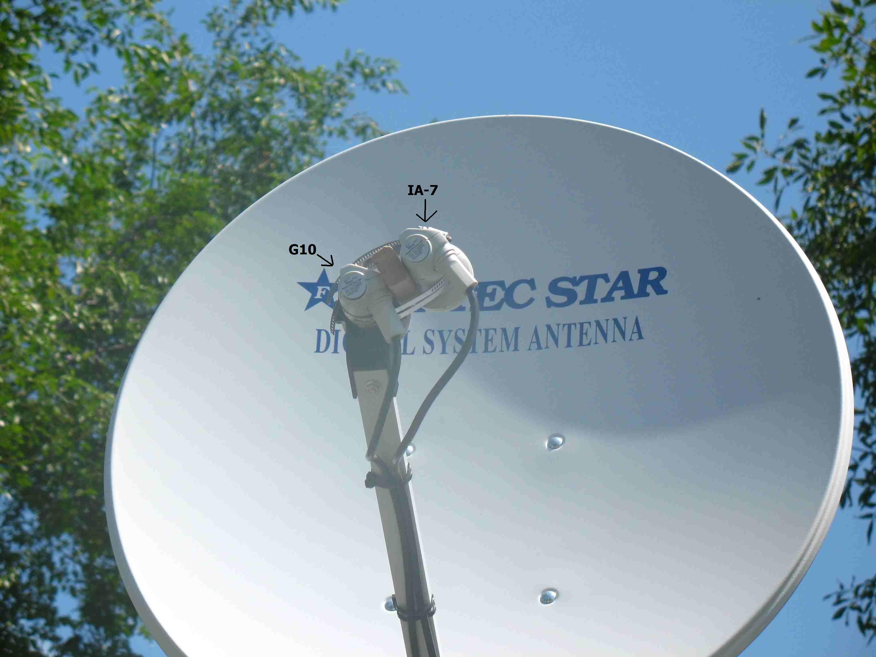

Larry check the attached picture to see if I'm understanding correctly.... If you face the dish wouldn't the IA-7 LNB be to the left of the G10 LNB?

no because it reflects off the dish so they go on the opposite side.
I was confused the first time I tried it :)
I too was confused about the placement, until Mr. Iceberg got me straightened around :) I had always wondered why on my dish 500 the markings for 110 and 119 were on the "wrong side" :)
Thanks Ice, it makes sense now :D
