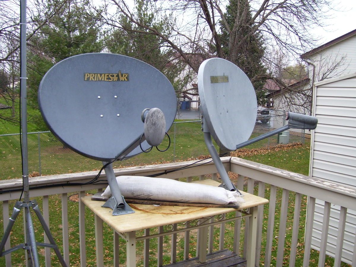

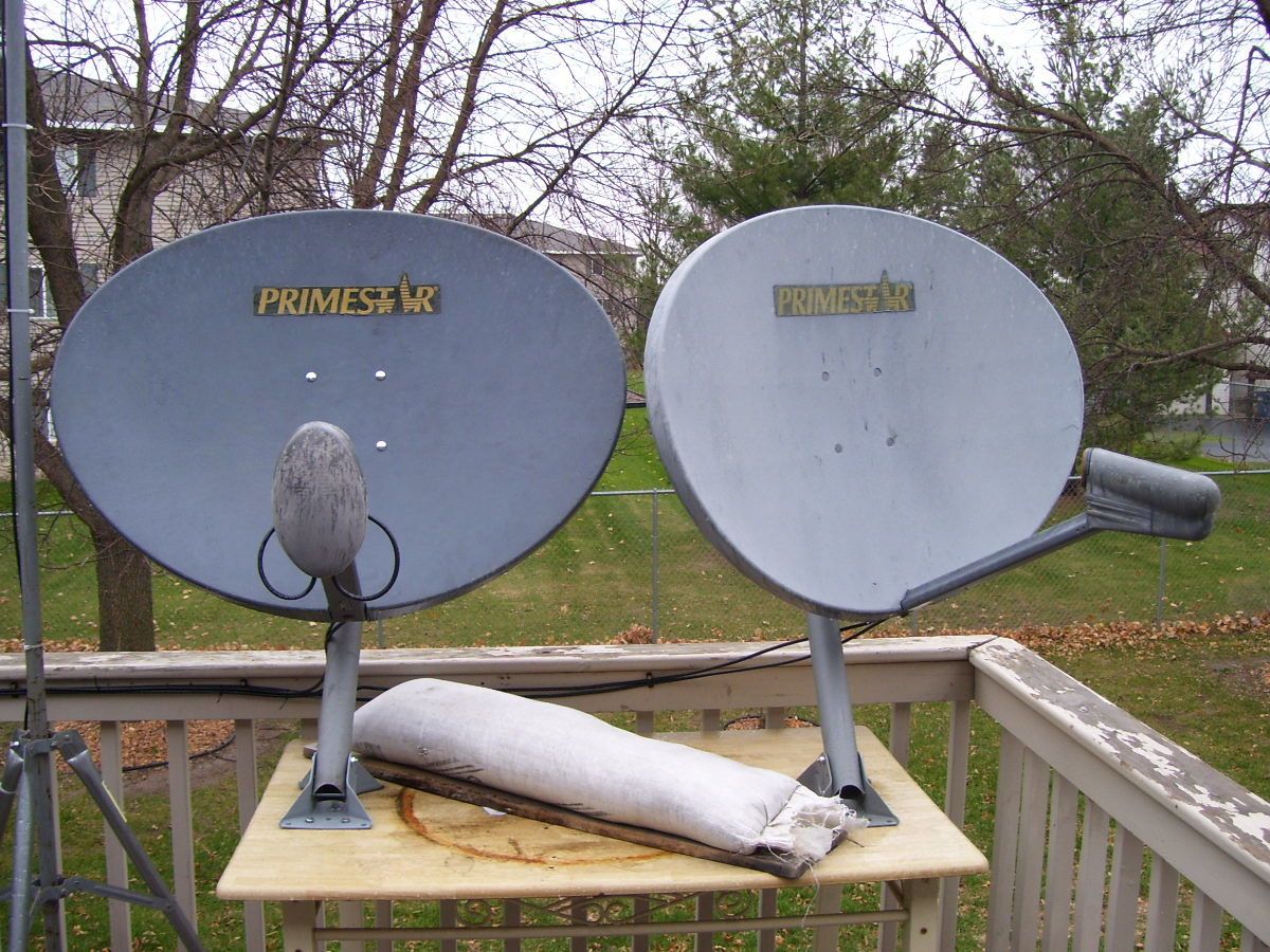

Wow you dug this thread out of the archives afa2325...lol...Yes a Primestar ( Channel Master ) dish will work for FTA...What do you see molded on the back of the dish..84e,,1.0x.7 or 1m...If you have one of those Primestars then it is a one to hang on to...Now if it is a .9x.63 75e then it will work but a bit undersized and not so desirable.

Can you post a pic of that dish?
As Iceberg stated you will need a multiswitch to go along with that Primestar ( Japan Radio ) LNB or there is a Eagle Aspen dual output lnb out there that will bolt right up th the C 120 flange that is a dual polarity with no need for a multiswitch...I can not for the life of me find a link but it is out there.

Ok, guys sorry for going through the archives :eek:, instead of starting a new one. I'm new to this thing but here it goes--it seems that the dish is Channel Masters it '39wx 30h... the last two images is a shot of the back of the dish it seems like it says 1x0.7-1 part no.# 3040865 MADE IN THE U.S.A

nice dish. Its a 84e dish which were 40x30 inches. Thats the same dish I posted above
You will need a 3x4 (or 2x4) multiswitch to combine the vertical and horizontal polarity. Looks like this
