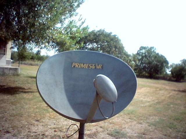

ok guys i'm going out in the yard tomorrow and set up two primestars dishes
probably one at a time. so i will be posting back several times looking for some tips. i don't have a sat finder so its just me pointing the dish.
i will have the tv and receiver with me outside and its my first time
running the Coolsat 5000 ( or any fta unit) is there anything i should know about how to find a sat with it. my c-band dish is currently down and will be a few weeks before its up and running.
thanks for any tips and helpful hints
two dishes one is oval and one is round , i plan on setting up the round one and later adding a motor to it. ( reading another thread on that )

Keep us up dated... I just set up a Primestar dish aimed at G10R a few weeks ago only using a TV and the receiver, this forum is top notch! I picked up 2 more Primstar Dishes, one was free, the other costs me $10. I plan on setting them up aimed at G10R/IA7 and IA5/AMC4.... I want to get those 4 Sats for my living room TV... I really like the Primestar dishes.
You may have already read this elsewhere, but the elevation markings on the primestar dish (at least the oval one) is probably off. My elevation was supposed to be 36 degrees, but when I finally found the satellite the markings indicated 52 degrees. That caused more problems for me than anything.
What I usually do when setting up a dish, is I set the elevation to where it is supposed to be for my area, but the meter inline, get a nice strong signal, and when it is at the max, I then adjust the elevation, and max it out then. On the Primestar, I just keep a wrench on the elevation bolt and can quickly make fine adjustments - real slick! After I get the elevation and the azimuth maxxed, I peak everything for max signal. I love those Primestars!

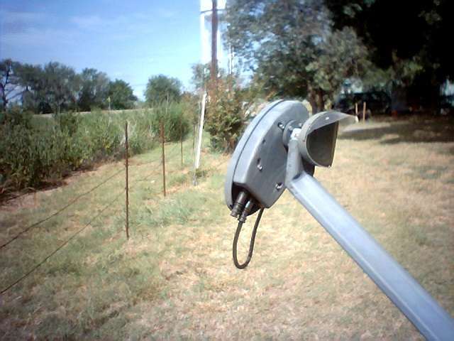

Don't forget about the skew. Sadoun's setup pages have a chart that list what the skew is for each bird. If you are using a Primestar lnb, I am not sure how you skew it. If you replaced the lnb, then you would rotate the lnb until the signal increases.
yeah the oval dish doesn't let you skew ( or if it does i haven't found one)
but ...
The pics below are of my Primestar LNB, you have to losen the bolts and skew it

yes i found the skew lol the # are very small so i missed them
ok will post in a few more minutes with new #'s to see if they have improved
thanks
the skew didn't seem to add much it maybe went up a % or 2

Have you got the LOF set right in the receiver set up menues ?
Does the Prime Star LNBF have one or two connections for coax ?
Wyr
its all preset from the blind scan menu but you can change any of those settings and i have checked a couple but the signal falls off altogether , everything on the receiver side so far i like the coolsat 5000 is a nice easy one ( well except for wanting a pin all the time )
the primestar lnb's that i have all have a V & H coax connection, was running mostly out of the V side.
