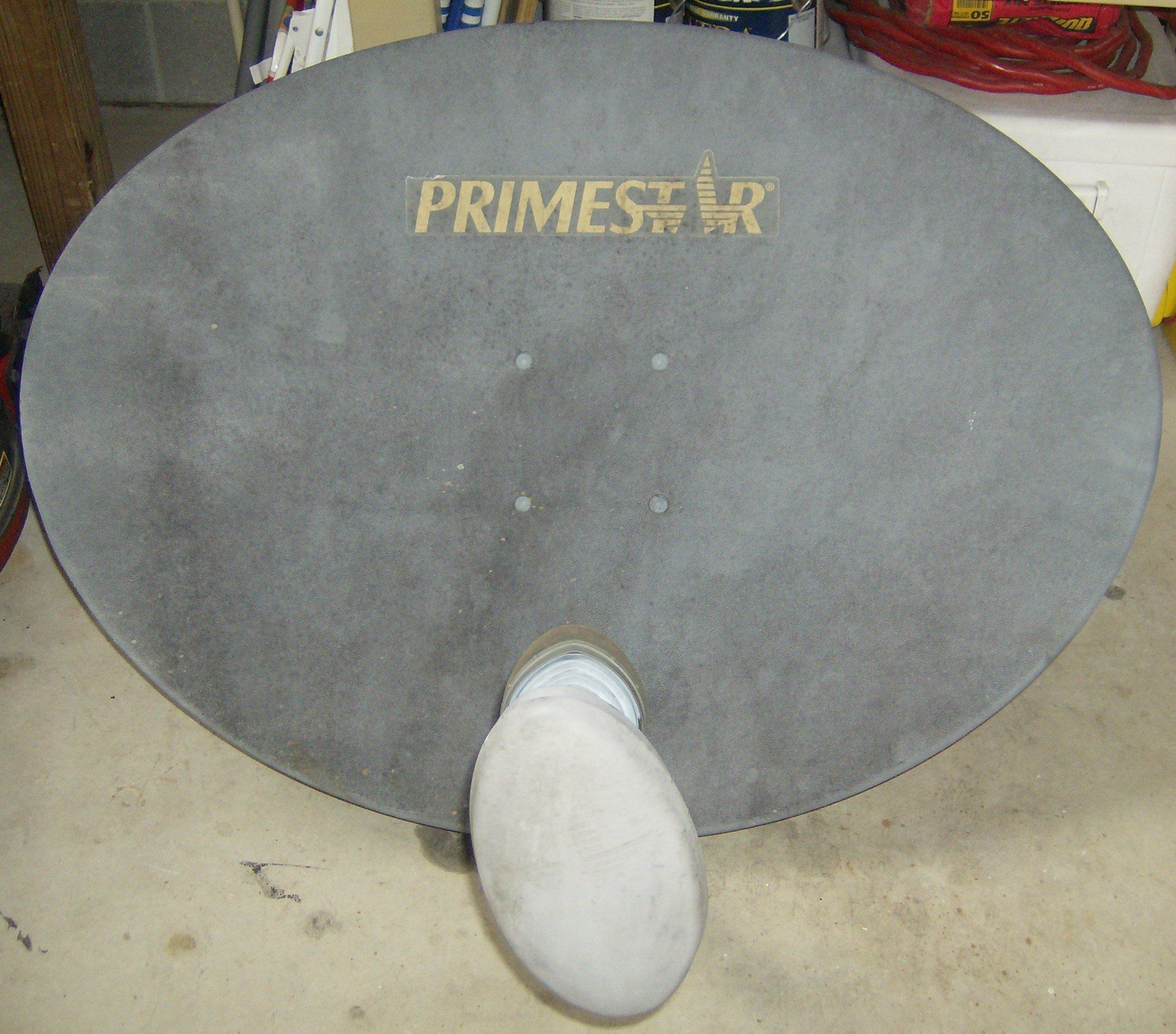

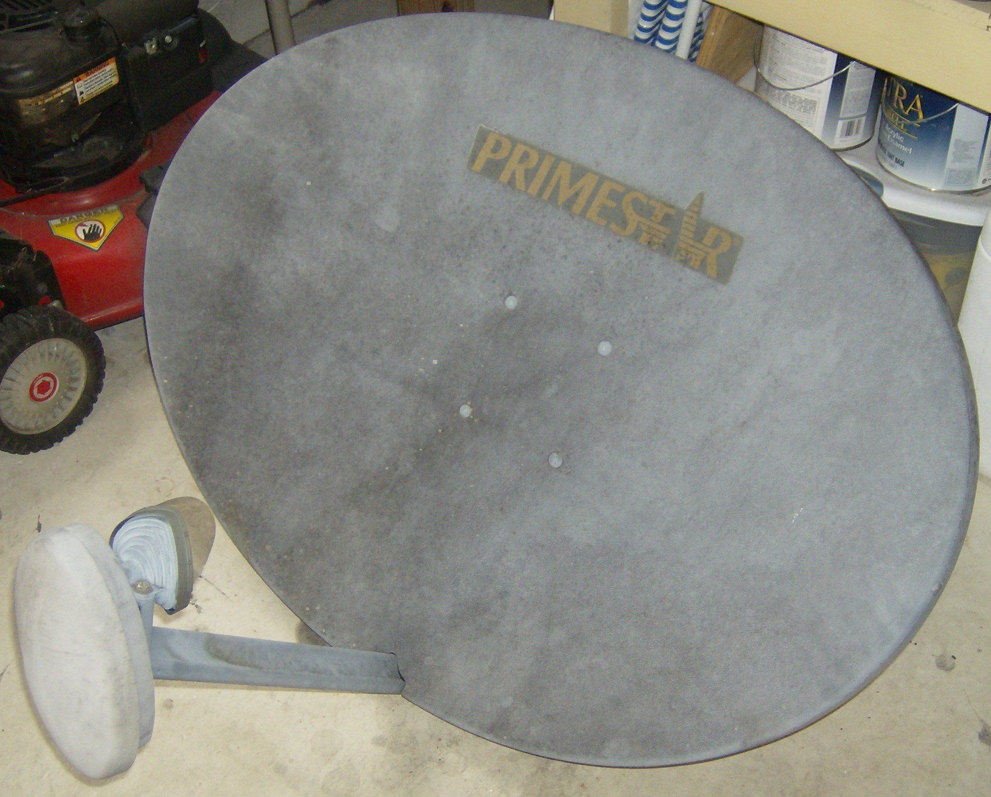

Newbie here just getting started in FTA.
Since I am pretty frugal, I have been putting out feelers on the local Freecycle board and was able to pick up a Primestar dish no longer in use (see attached pictures).
1. Can I use the existing LNB set-up to pick up FTA signals or do I need to retro-fit the dish with a standard and/or universal LNB?
2. There are 2 coaxial inputs (vertical & horizontal?) on the current LNB. Can I just hook up to one or do I need to combine the signals? If I need to combine the signals, how do I do that?
Any help would be appreciated - Thanks!

yes it should work fine depending on the satellite you aim for like g10 most just use the vertical but you could get a diseqc switch and combine the two. thats a good fine and a great way to start out FTA FREE lol i like free
The LNB will work fine as noted above
you might want to paint that dish though...looks pretty shabby :D
I took my gas powered pressure washer to my Primestars. They looked like those in the pictures above. After a few minutes, they look like new :)

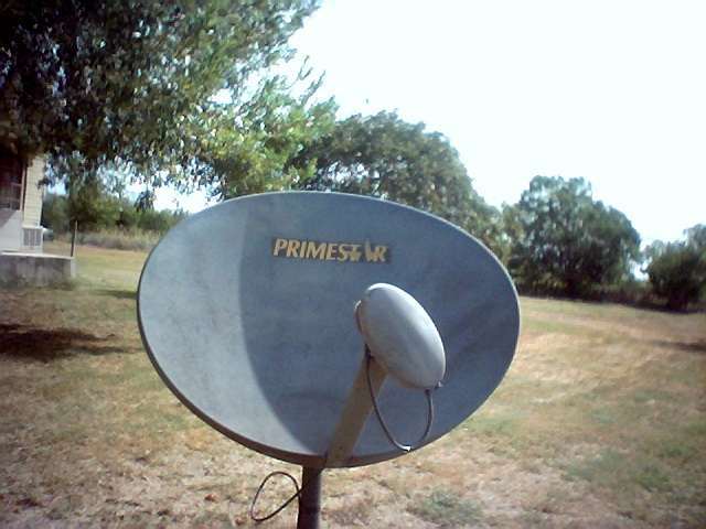

Nice looking Dish. I have one exactly like it with the same LNB, using it on G10. I only have the vertical side connected. I have 2 other Primestar dishes I have not setup yet but the LNBs are different on the other 2.
Nice set-up - I plan to aim my dish to G10 as well.

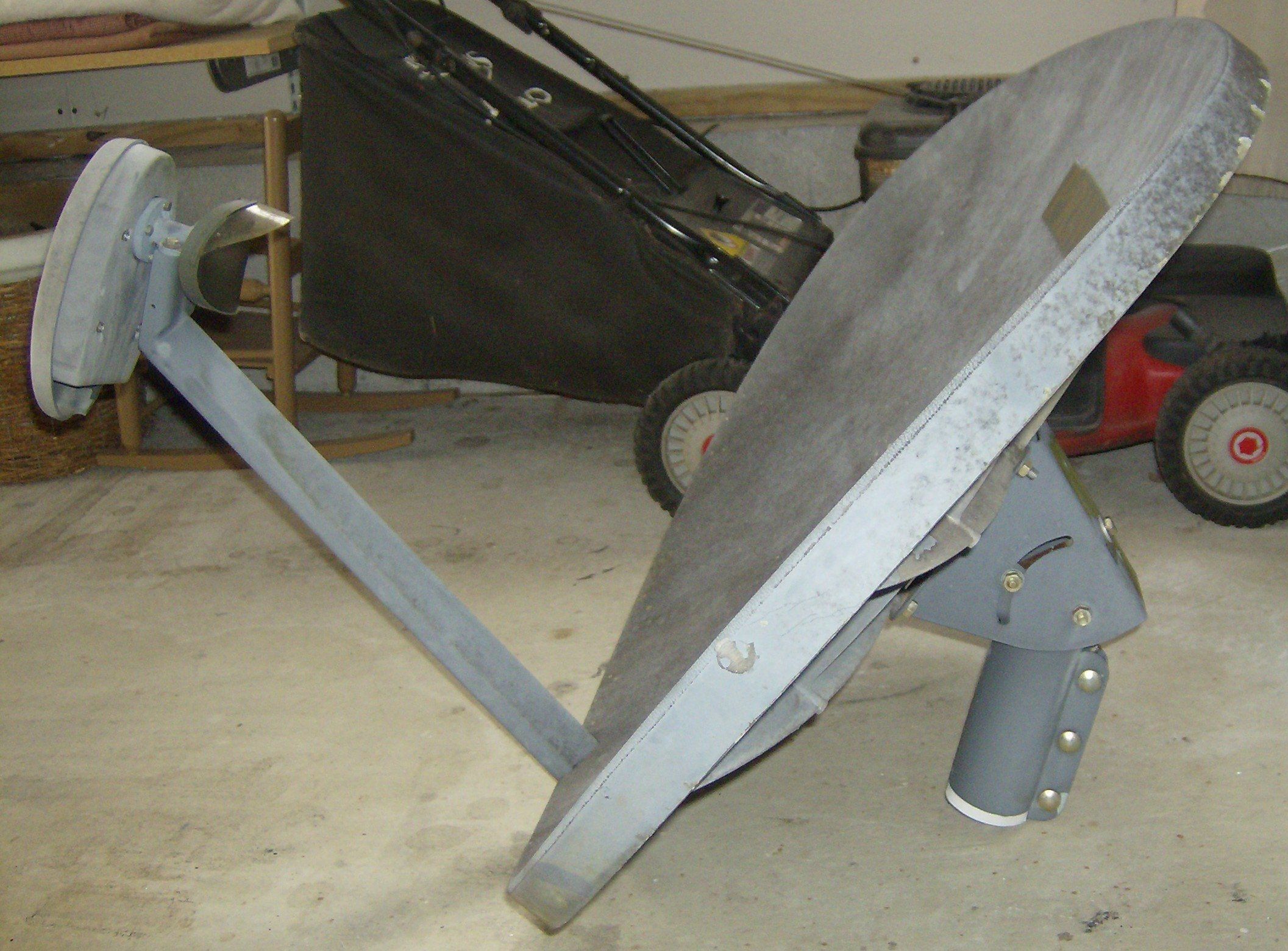

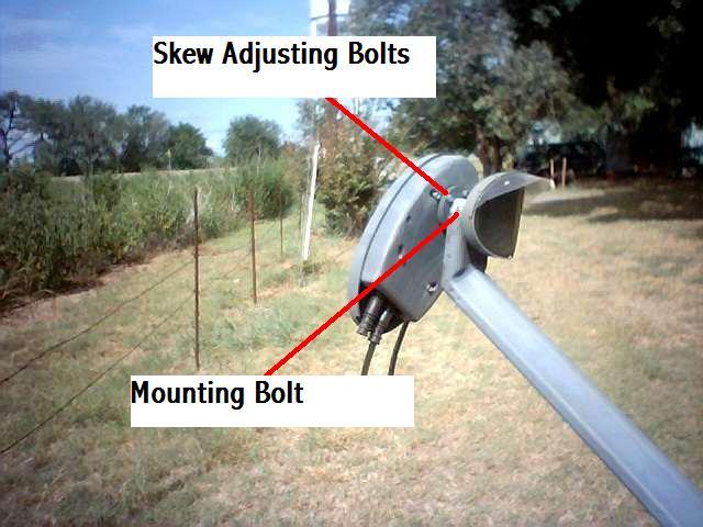

By the way, how did you go about aligning your Primestar dish? You cannot make skew adjustments on the reflector, correct?
... how did you go about aligning your Primestar dish?

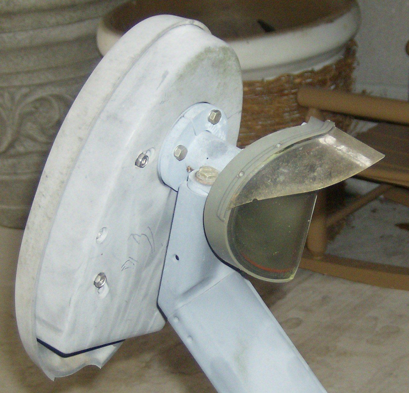

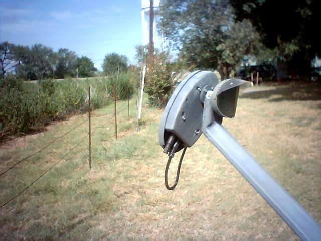

I've never -ever- seen that Dove-bar LNB before, in any pictures! :eek:
Strange looking thing.
If the dish doesn't rotate for skew, and the horn can't be allowed to rotate relative to the dish....
.... that just leaves the dove-bar to be rotated . . .
...and in some of the pictures, it is.
Does the horn & LNB somehow slip relative to each other?
If so, I've really seen something new , tonight! :cool:
The good news is, it's begging for an Invacom QPF-031 , flange-mount LNB.
... no wait. Maybe not. Unless you can somehow make the Invacom slip, too!
No you can't make skew adjustments on the reflector, you adjust the skew by loosing the bolts on the LNB and rotating the LNB to the proper skew. There is a gauge on the LNB that shows what position it is at. I had downloaded a program that told me what postilion it should be at for my zip code.
The bolts you loosen for the Skew are not the bolts that mount the LNB to the Dish arm they are on the body of the LNB.

When adjusting the the skew the Body of the LNB rotates while the neck and horn are stationary. See the attached picture.
Very nice pictures.

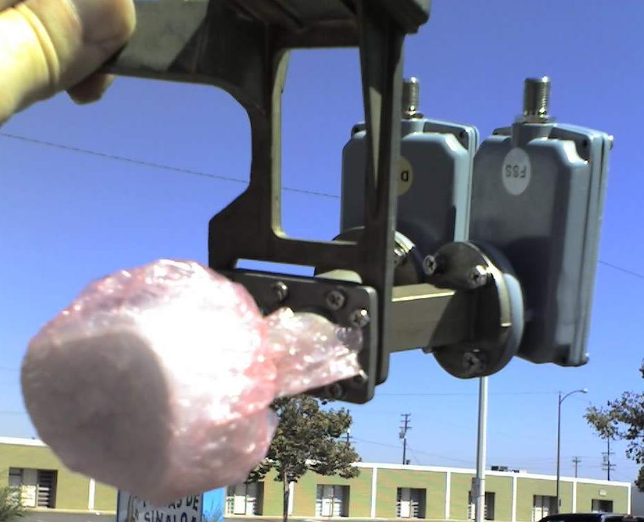

So.... could you drop an Invacom flange-mount LNB in there, in place of the dove bar...?
I can see how you adjust it.
About as I imagined.
But still don't know if the mechanics are such that a QPF-031 or a Dish FSS LNB could be substituted.
inexpensive Dish 121 FSS LNB shown below...
Don't think it will work. I may be wrong though. I know I can take a LNB with a 40mm neck and take off the plastic case and and expose the 20mm neck and it fits and works on the Primestar. I think Iceberg posted some pictures a while back showing how this is done.
