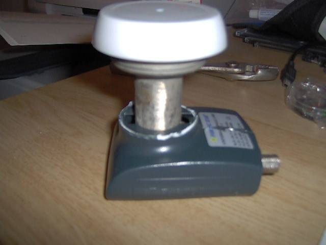

Here is what I meant by gutting the LNB case :)
When you remove the plastic, whats left is a 20mm shaft to fit right on that P* dish :)

Thanks for the pic! I have been buying the Sadoun KUL1 lnbs, and they look to be different. What brand is the lnb that you have in the pic? The Primestar dish that is in my neighborhood has the lnb on it, so it I can get that then no problem there. As for the other dishes, I would try to order an lnb like you show. Are you ready for the heat Ice?

Larry the LNB that is in the picture is a Fortec Universal (Sadoun sells those)

I find that LNB's that are "L" shaped are pretty much going to be able to use a 20mm shaft. I have a couple old LNB's that is straight out (like your cuirrent ones) and after gutting them, One could work (little bigger than 20mm) and the 2nd is way too big :)
