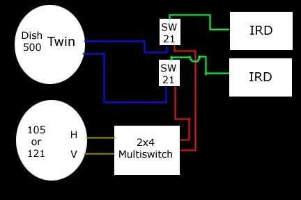

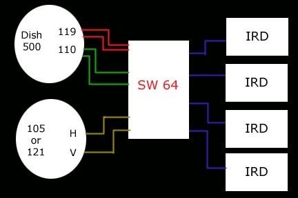

A little about the old Primestar LNBF courtesy of the old dishinfo.info site:
Think of this style of LNB as like a standard dual LNB, but one side is locked to each polarity. If your using a switch that does this already, like the SW64 or SW44, you can simply get away with directly connecting each output to its related input on the switch
For switches that don't lock the LNB, like the SW21 or SW42 a basic 2 input 4 output multiswitch is needed.
