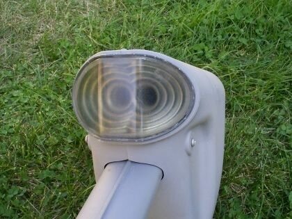

I have a few primestar dishes with dual lnbs on them and i can't figure out what there for because i thought primestar only had one satellite location when they were still in operation. If anyone has any info or is just interested let me know and i will show u the pics of it

What he's talking about (I have seen the pics but have no other clue) is that the dish has an adapter, with two LNBF units on it. Each LNBF looks to be the standard one with two outputs (H and V, I would guess).
I don't know whether at some point P* was planning on a second satellite, or how many degrees apart the LNBFs are. His dish also has a skew adjustment on the back.

The dish is a channel master 84E and the lnbs are the same ones you see on regular primestar dishes except there are two of them. They are spaced about the same as a dish 500's lnbs are. Sorry to sound like a dumb ass but how do i post pics on here.

here they are!!!! Now what the hell is it?????
The part number for the lnb holder is #3041215 and i imagine that its made by channel master just like the dish. I may have to email channel master themselves.
Does the dish look like it had a skew on the back? Perhaps that was for the "Charter Anywhere" service in which had two lnbf's with a skew and was hooked up to some sort of switch. I personally think they used the same dish as PrimeStar and just covered their name up (as it appears what has been done on that dish).
I guess they are 9 or 10 degress apart sooo pick your fav two KU sats that are that far apart. Say IA 5 and F1 and using a signal meter see if you can get both?
