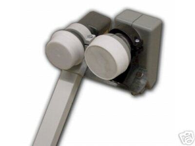

I just purchased the Primestar 40x30. I am going to have an Invacom 0.3dB LNB, which I will use for Dish Network/Ku-Band. But, I am also hoping to use this for C-band reception as well, so, do any of you have a good recommendation in mind for a C-Band LNB? In addition, does a clamp like the one I have attached to this post work for this type of an install?? If not, what works?

Plus I found when I added a C-Band LNBF to an off set 40" dish the elevation was WAY off. So both LNB's would have to be at vastly different heights!
Would I be better off with a two dish install then?
Iwould say so, but half the fun of this project was just trying it and see how you get on!
Ahhhhhhhhhh, an appeal to my creative side. Where is my daughter who is 9 when I need her?
Thanks, I think I am going to get a small KU-band dish, set that up first. Then go for a C/KU band install! Muahahahahaha.... I'm going to love this. How fun!

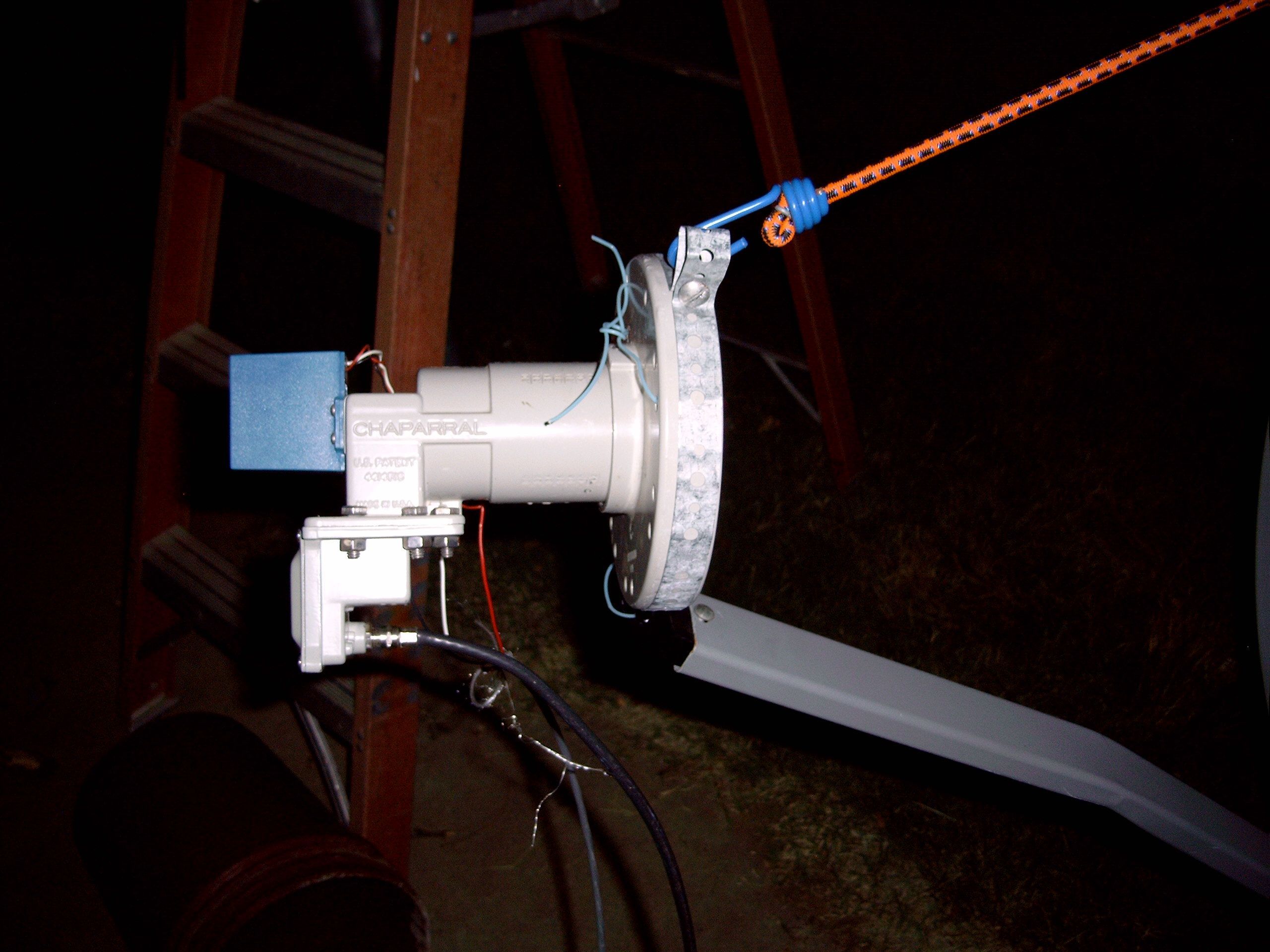

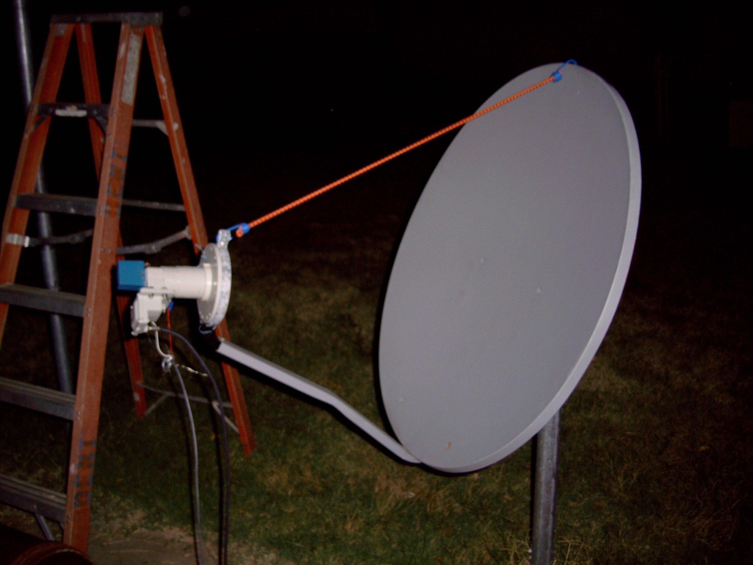

Here is a 90 cm mini bud .
Wyr
