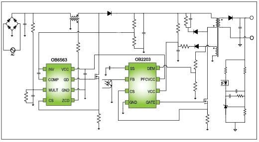

Hi,
I have the same problem with power supply for Azbox Premium plus.
I found a similar electrical scheme with integrated circuits OB 6263 and OB 2203.
(supplement)
I exchanged both, but the power supply working only short timeshit.
I would like to share information about what next every have gone wrong ?
Thanks.
Can You help me, please? (vbrath@email.cz)
I am looking forward to hearing from you.
Best Regards
Vladimir.

Vladmir; Both of the supplies that I repaired had a failed electrolytic capacitor. The large one on the output side of the full-wave bridge just off of the AC line input. In both cases, the capacitor had shorted and fuse was open also. Since the repair, I have I have used the unit continuously since 2014. Good Luck.
